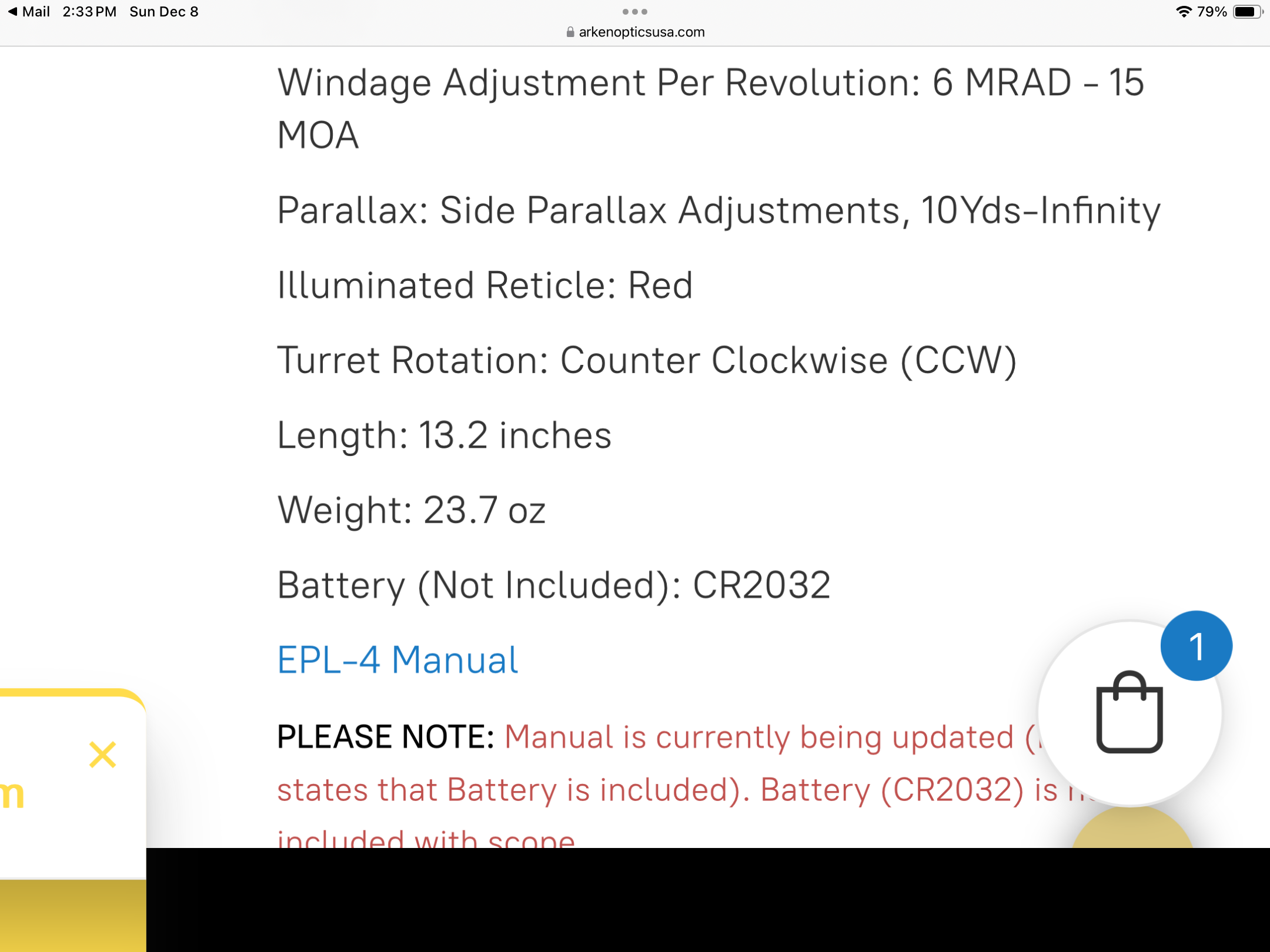

This is what I was wondering also, the EPL4 is supposed to be 10 yards.

Actually 10 meters
I’m waiting on an elp4 4x16 . I had to confirm their site states 10 yards. That 30 inch’s ( approximately) matters to me.
