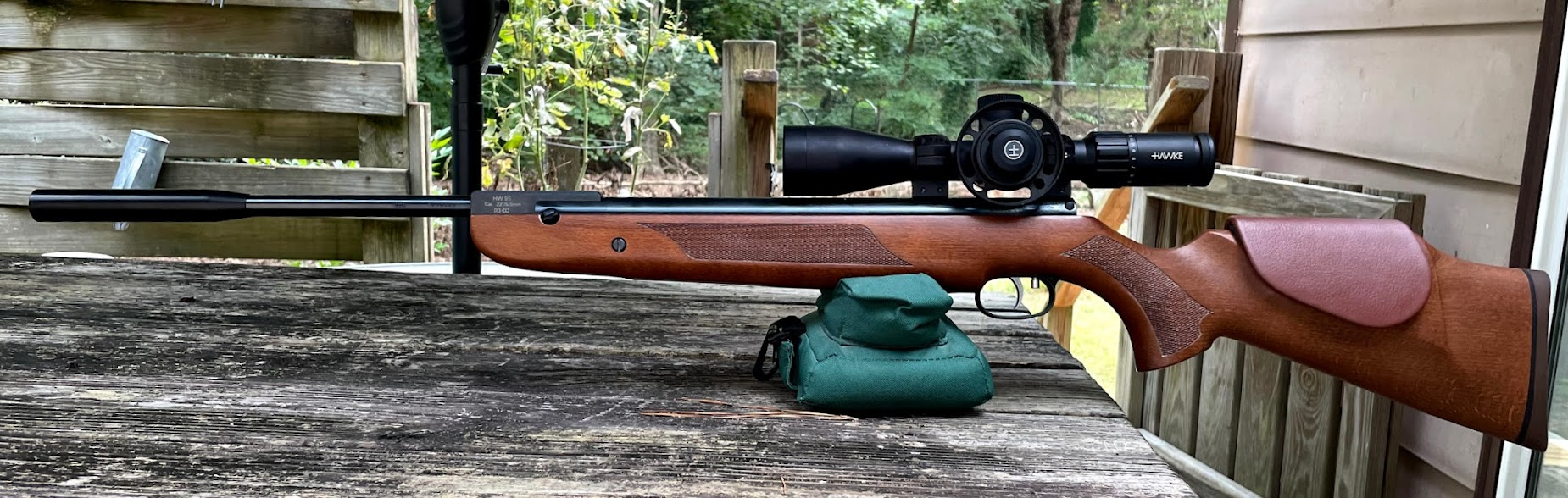

I would recommend this model of Hawke Airmax Compact scopes & this is the 44 mm size on my HW95L.
https://us.hawkeoptics.com/airmax-30-sf-compact-3-12x40-amx-ir.html
