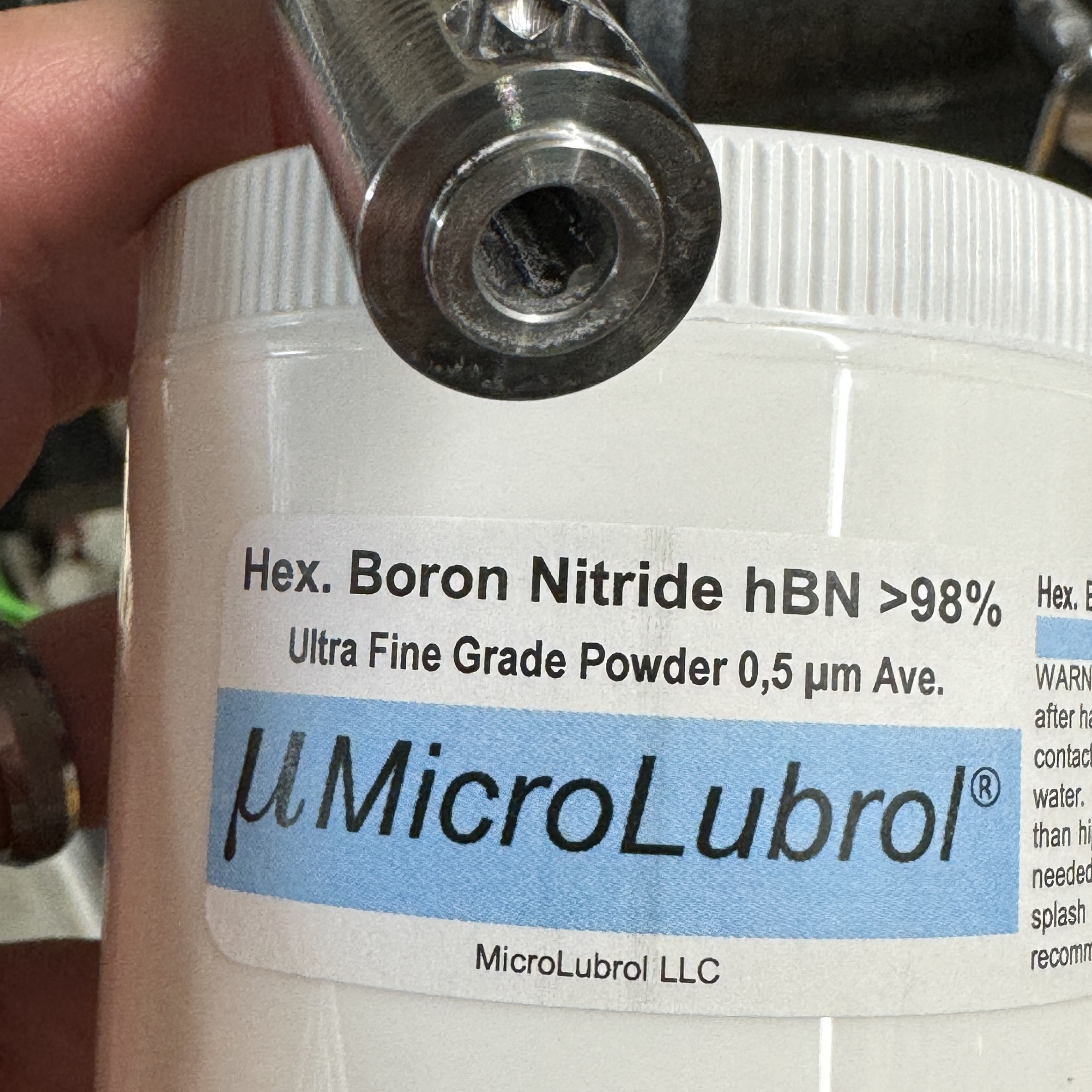

Michael's recipe uses 1/2 teaspoon per 2 fl oz of alcohol
The 1 fl oz jar of Microlubrol hBN= 2 Tablespoons =6 teaspoons = 12, 1/2 teaspoons = 12 recipes
EDIT
Amazon says it is a 1 fl oz jar
The Microlubrol website says it is a 1oz by weight jar. 28 grams
So the arithmetic above is incorrect and has been struck out
Sorry!

Yep, that’s the stuff. Does that brand state how fine it is?
I plan on coating some of my projectiles to test against uncoated ones.
FWIW - I don’t think you need to go to the extreme lengths I did to clean my barrel. The most important thing is that you remove all the fouling and petroleum lubricants.

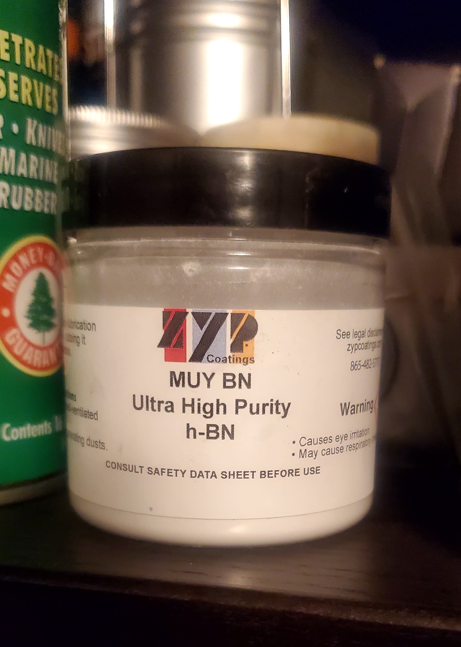

This is what Amazon said about what I bought. I have no idea about the details.
Muy BN - Ultra High Purity h-BN (Hexagonal Boron Nitride) Powder (4 oz Container) https://a.co/d/hFI1T4j
Allen
Reactions: Bandito
