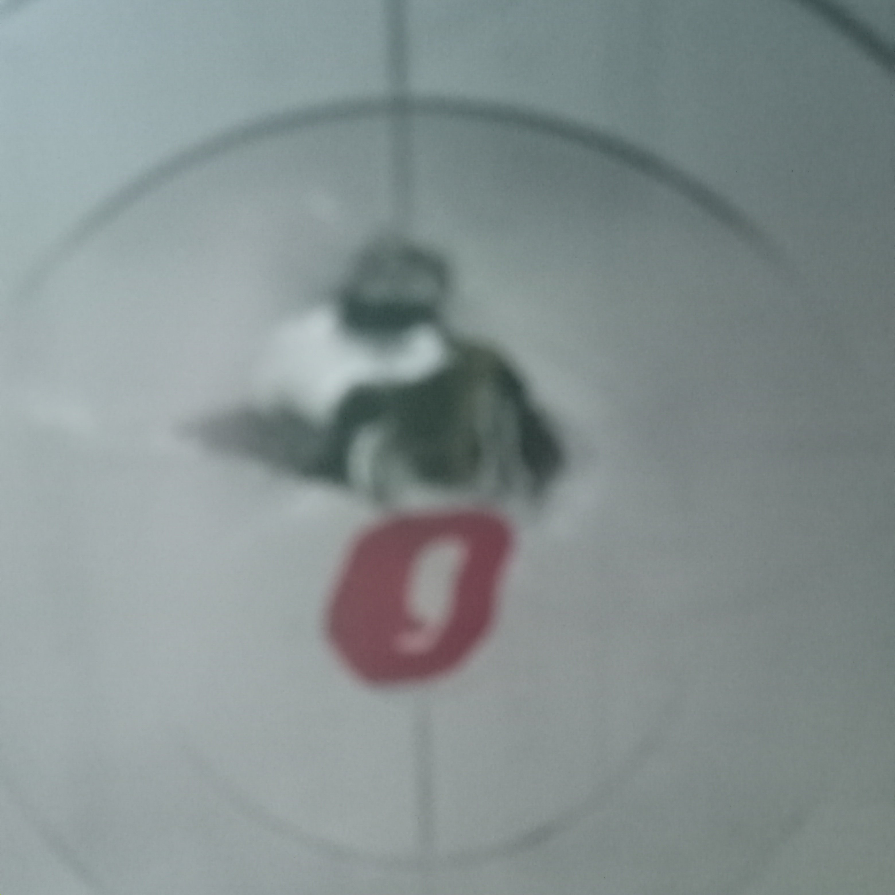

A mop,it takes very little. I don't use alot of the stuff. Still got half a tube of 5000gr and done polished over dozen liners or more. A match shooter told me this to make my liners more accurate, I don't have an unaccurate fx liner,and I got over 20 of them . That's why I don't know why people take negative about them, I've never got one that don't shoot good. Two days ago,I got a 700mm 1in22 twist 30 caliber. It looked bad inside it. I hot it with 5000gr for about ten minutes till it was mirror. It shoots 50 grain aea really good tensioned on my m3. This good at 100yards,over and over. I shoot groups like this in the wind. It's how I practice.
