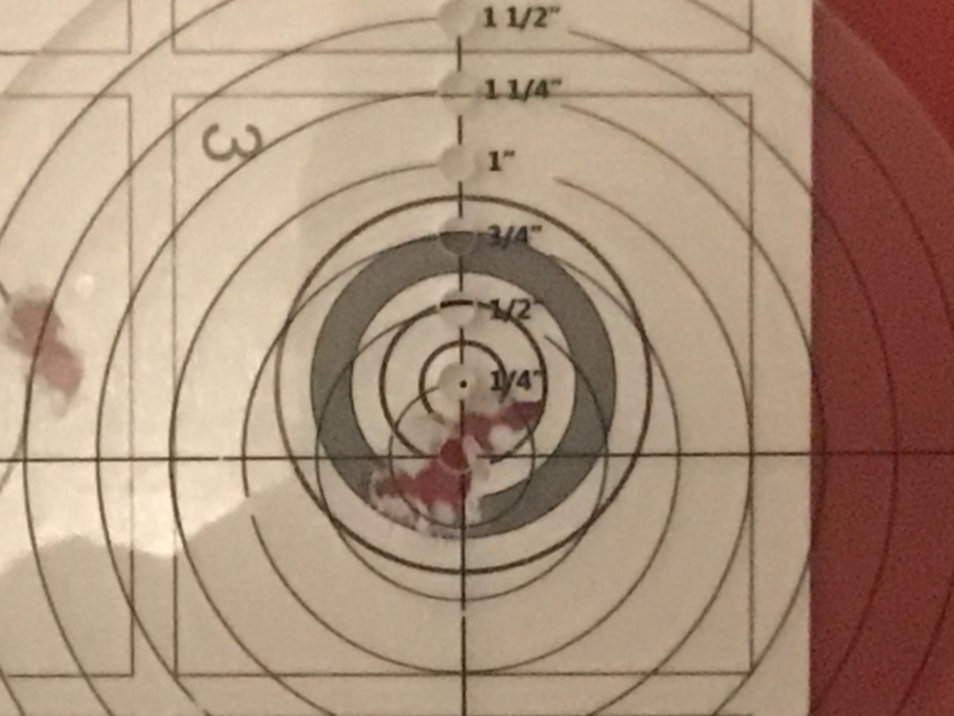

Well, i haven't quite given up yet.
I now know i my barrel, the HBN did not stop the accumulation of fouling.
I scrubbed it all out, but still wnated to see if the HBN could be used as a dry pellet lubricant.
i washed and dried a batch of weighed pellets and dumped them into a ziplock bag and added 1/8 teaspoon of HBN to the bag
I coated then pellets and used these for the next part of the experiment
I went to the range and set up for 100 yards and used the coated pellets ..i wiped the excess HBN off before loading
Nearly all of the groups stayed within 1" with 1 exceptional 5 shot grouping at just 1 lil over 1/4" shot on a 50yrd target
Wasn't all good though, there were a few that went to the outer rings that left me scratching my head."WHY"
I'll continue on with the HBN as a dy lubricant and test it out a bit more
Thanks for the help Troy
Mike
edit..the device used measured radius..so it is 1/2" diameter
