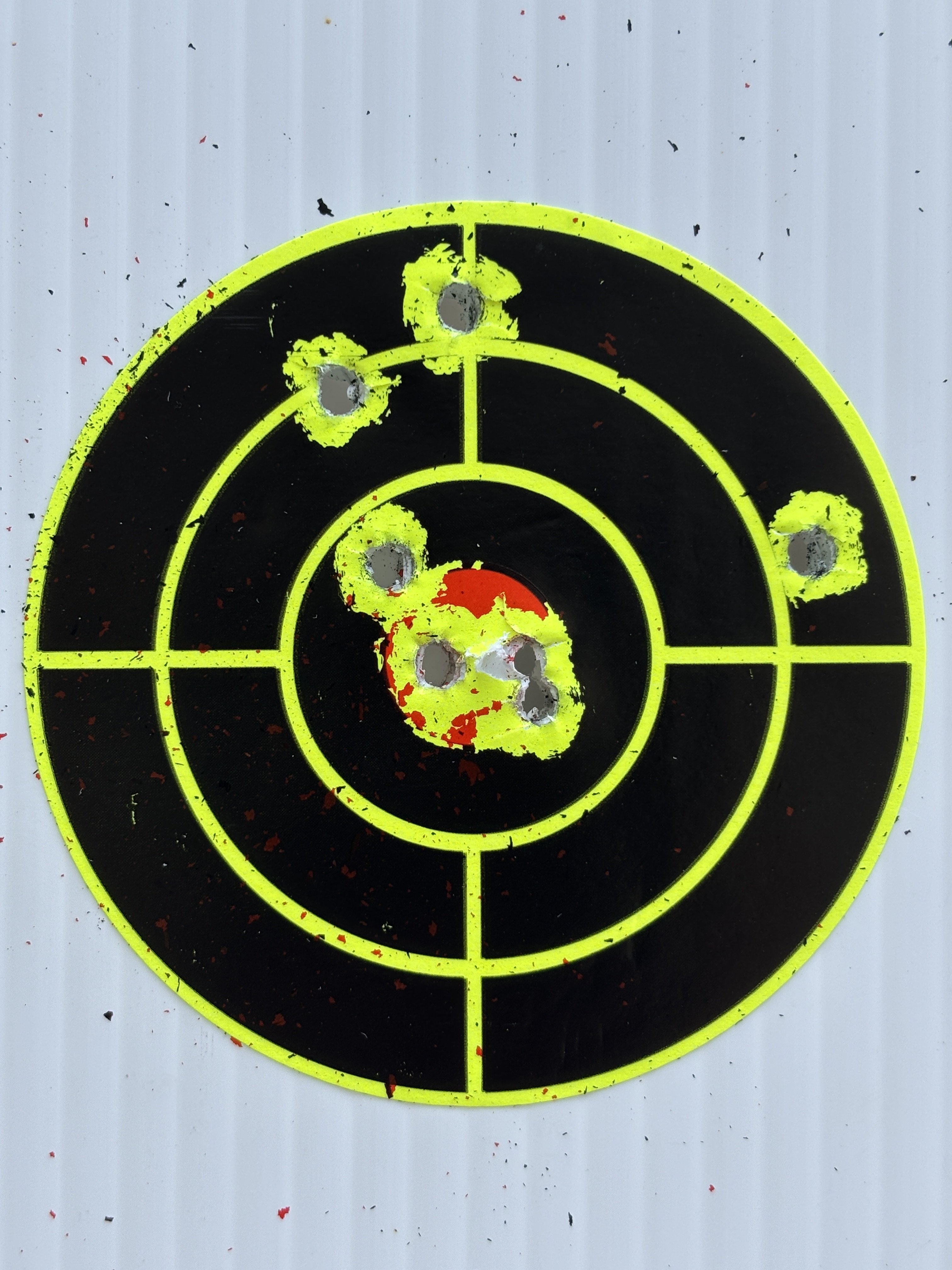

Tried out hBN for myself. All I did was sprinkle it onto a tin of slugs and shook the tin. The slugs looked to have been coated evenly. I did not notice any loss of FPS. Not sure how that’s happening to others. I’m using my home made .25 34gr slugs at 950-960fps out of M3 Impact. These were my results at 100 meters.
Reactions: .20calguy
Wow, that's a significant visual difference. How did you lube the slugs? Was there any discernable difference in the accuracy of either?
I just sprinkled the powder in the tin of slugs and shook the tin. It seems to cling to the slugs evenly. As for accuracy. I’m not 100% sure. But seems to be better??

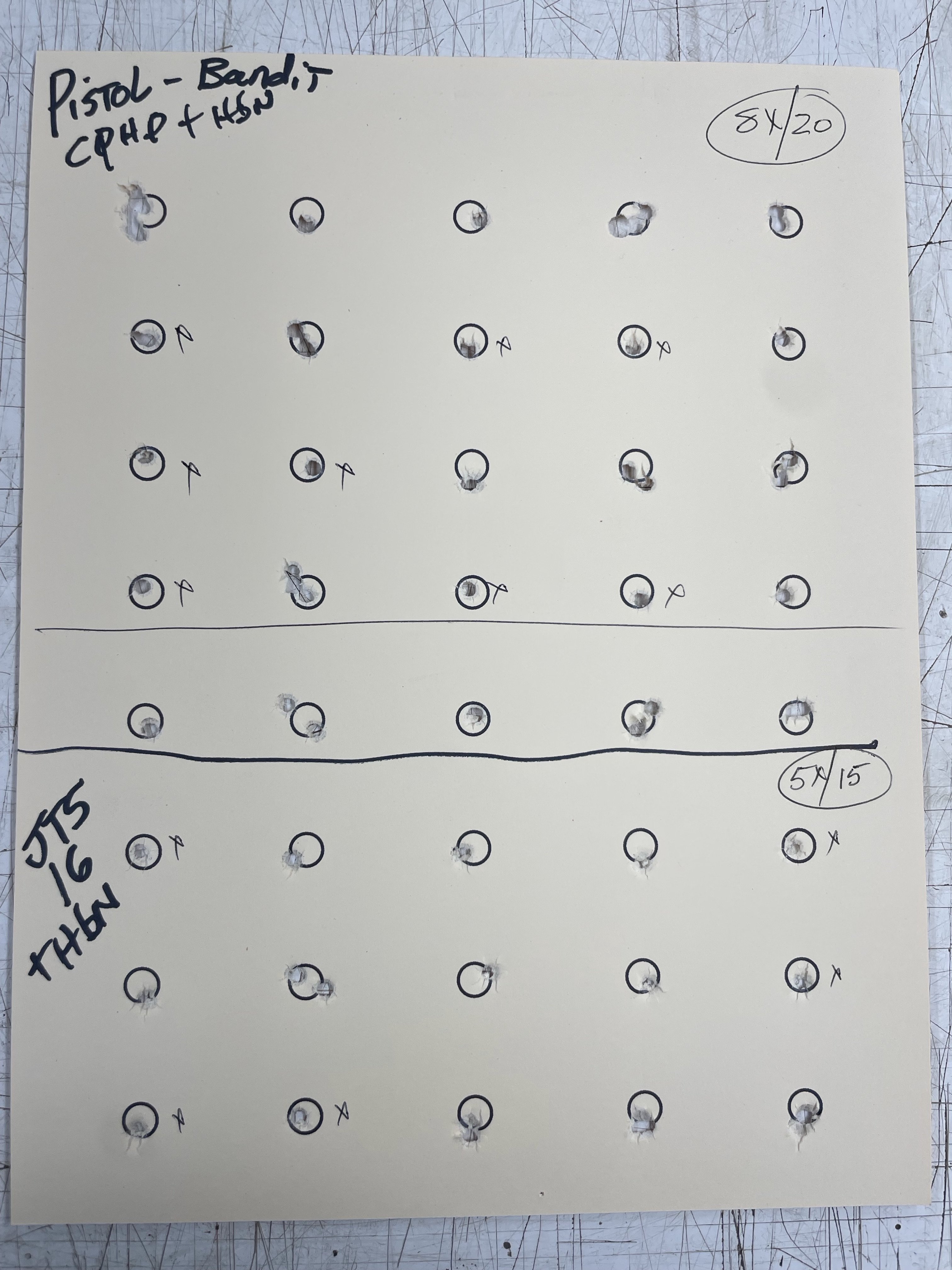

I spent some time testing HBN in my Bandit pistol today. It’s been too cold to shoot rifles outdoors so I benched my pistol indoors at 10M. It’s not the most accurate pistol on the planet but it provides me with some trigger time in the cold winter months. I tested it on CPHP’s and JTS16 pellets and compared results against lubed pellets and pellets straight from the tin. I shot the pistol in carbine form and also in a pistol form. Long story short, this pistol shot more consistently using pellets straight from the tin.
Keep in mind that this is a sample size of one and what works for this may not work for yours so it’s best to test to see what your particular air gun prefers.
