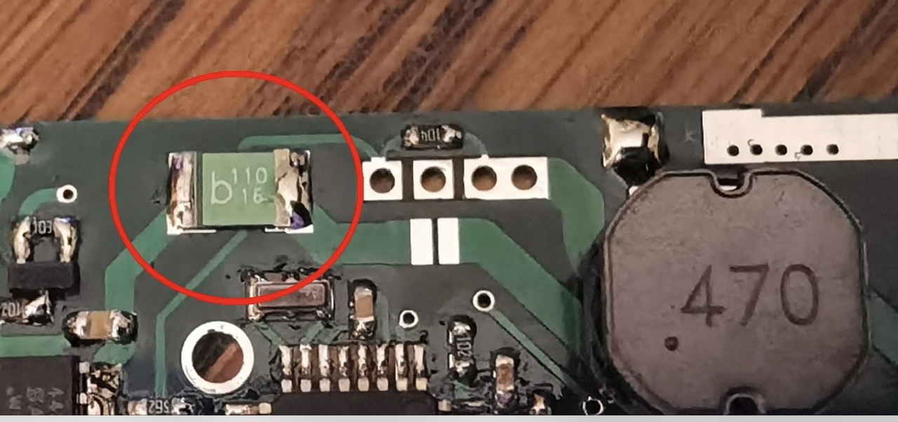

I emailed Jack G who makes the HeliBoard and he said this:
No this is not a known issue.
If you noticed a significant change in capacitors recharge speed and you are sure about your battery
i would suggest to measure and maybe change the resetable green fuse (2A/16+ volt).
Those components are known to fail in usb ports.
Here’s the photo of the fuse.
Hi Centercut,
Have you tried a new fresh lipo cell?
do you have the 80 voltage capacitors also, - my heliboard can be set to work from 81 Voltage to 94.9 voltage.
I run most of my programs at 85 voltage then I can reduce the voltage a bit to reduce the speed overall in that program or vice versa.
