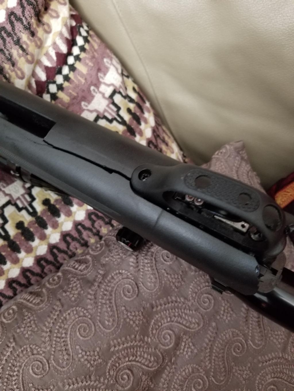

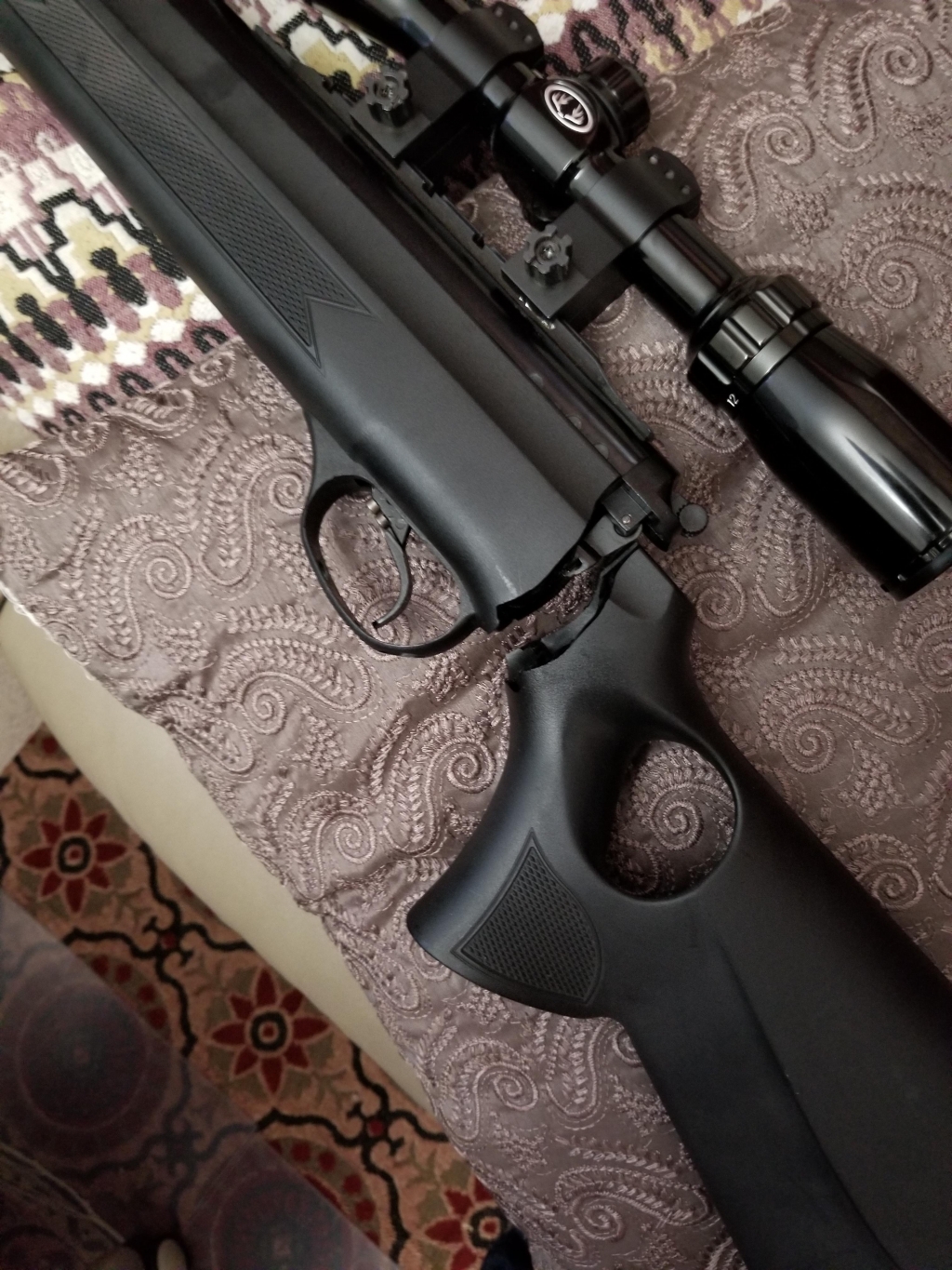

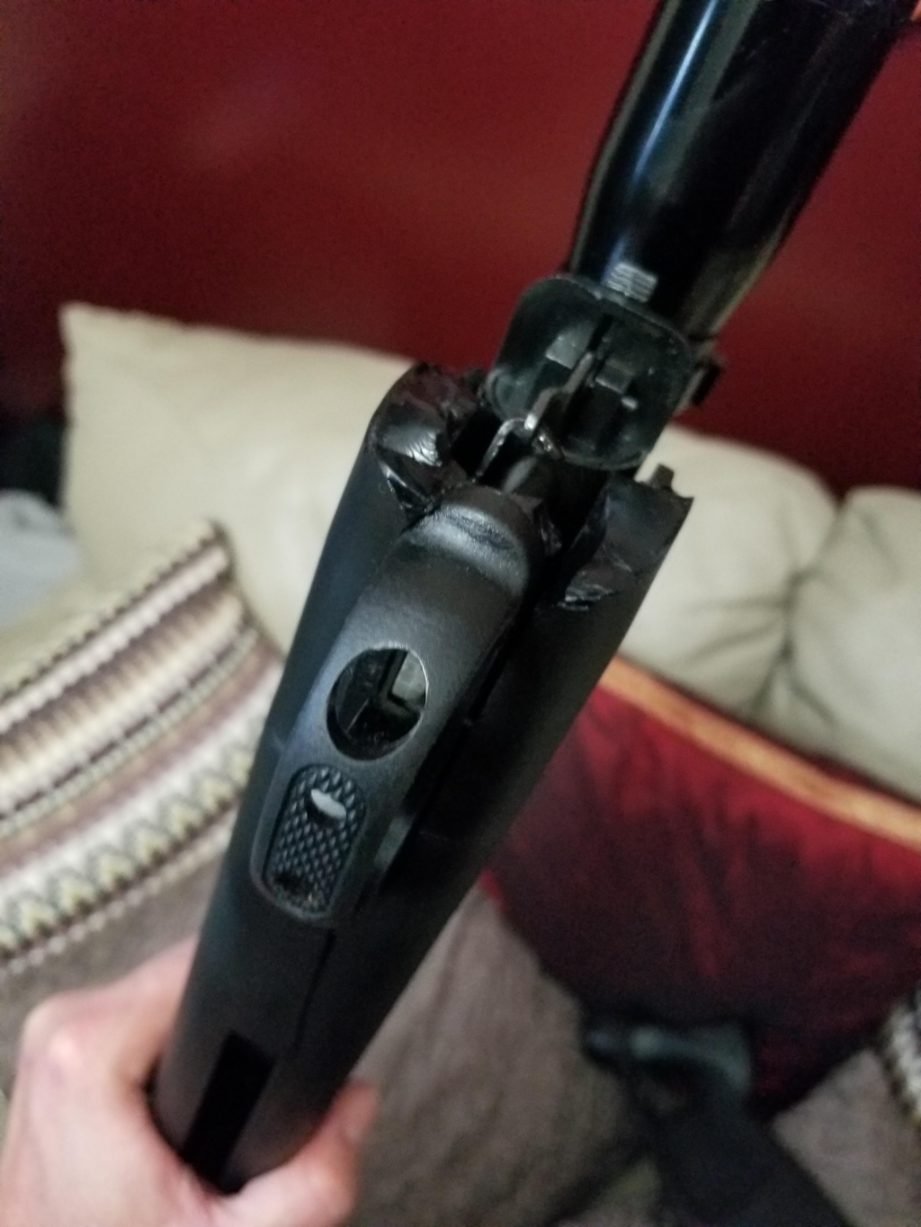

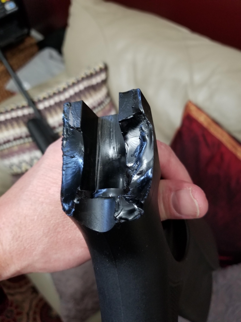

i have 2 problems with my Hatsan Mod 125 .25 cal.
1st My stock just broke in half after about 300 rounds. Where can I get a replacement?
2nd i would like to change the spring to a gas piston. Where can I
get a gas piston
That looks brutal! I have a mod 125 in .25 that I have converted to NP. I am using a 170 bar ram. If you go any higher you just get a lack of accuracy coupled with some serious cocking effort. I am in Europe so have no idea about a replacement stock in the US but I do have sources in Europe where I know they are available. Let me know if you want the details after you deal with Hatsan in the US. The only things you need to convert to NP is the piston itself & depending on which one you get, a locating washer/disk to hold the rod in situ on the rear plug. I have the type that fits the other way around so it has a flat plate/disc on the end sits inside the piston & keeps it centered. I got it from a place in Poland but they ship worldwide I believe.
Good luck with that stock.
