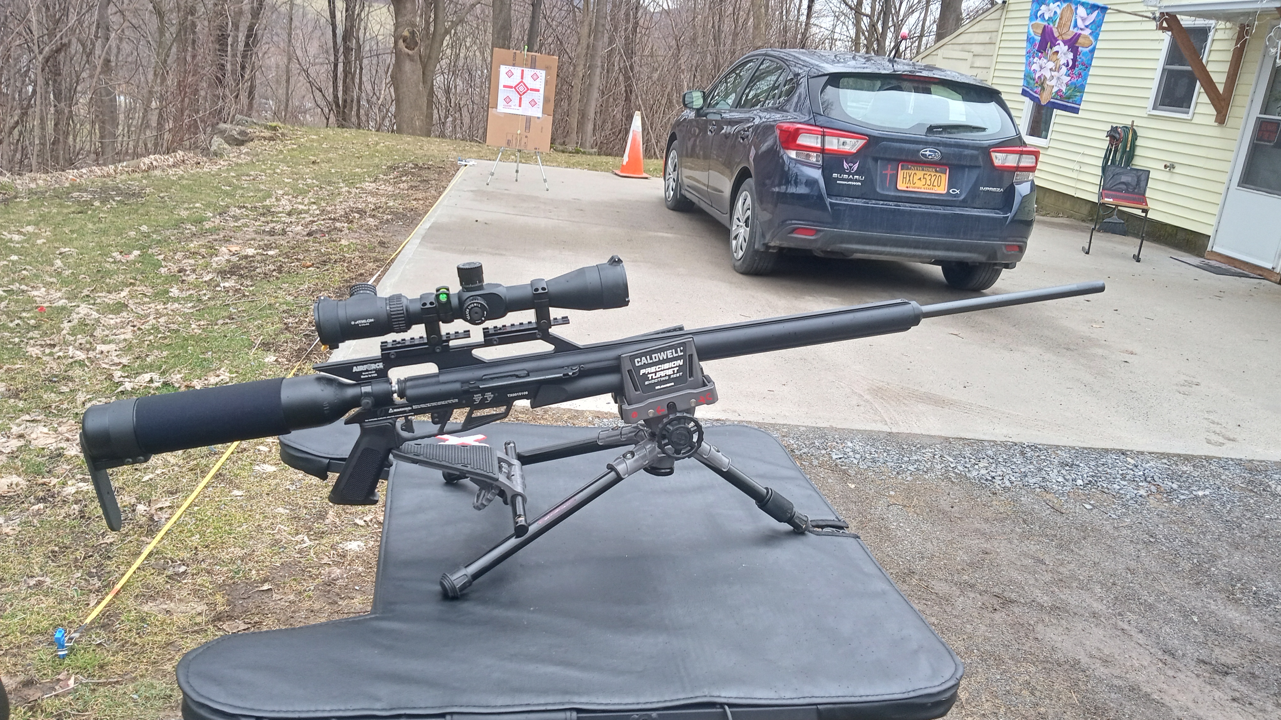

I also shoot left handed, All 3 of mine are right handed and i have no problems'. Know if there was a shell rejection now we have a problem lol . I have AEA 357 Big bore standard, 25, Avenger and 257 Airforce Texan that is my fav but, they are not hand pump rifles. He may want to think about getting a air compressor, sam yung or something like it. All 3 of mine will take out coyotes, The avenger i have has been modified for that reason. I think if he ever shot a Texan he would be hooked! A stock 257 has 170 fpe shooting 72gr slug and is a long range shooter.

That looks like a beautiful rifle! Not sure my friend would spend over a thousand $ more than his current set up though. I hope another lefty gets and enjoys it!
