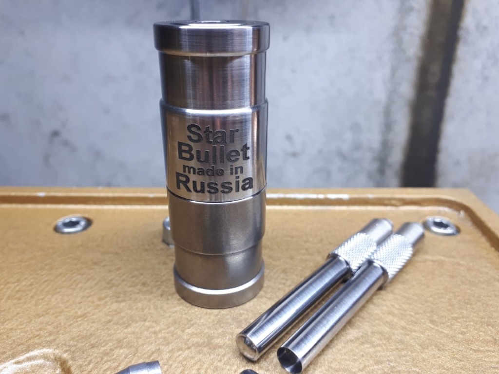

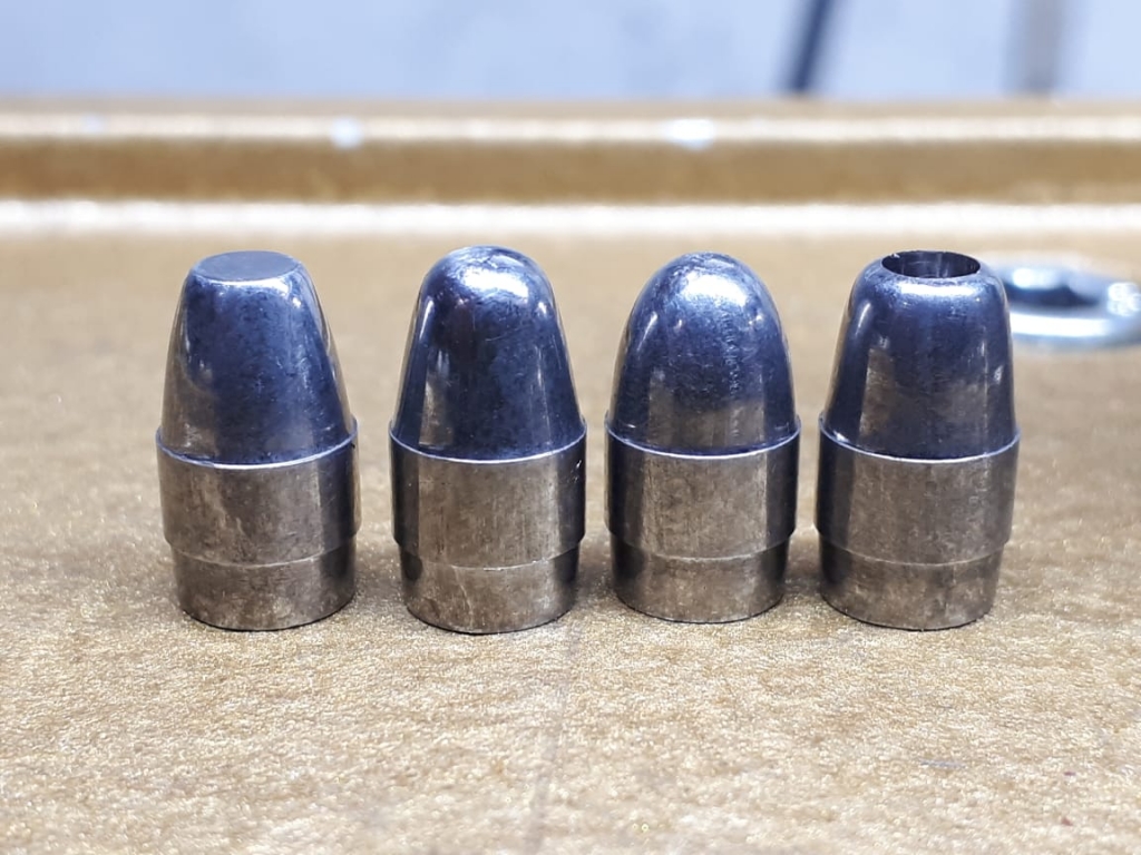

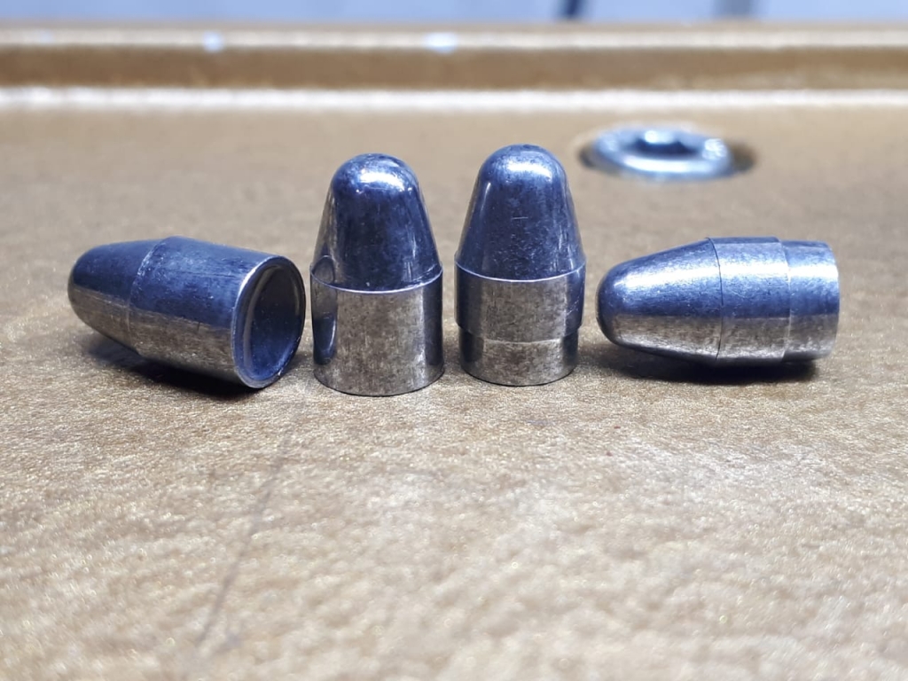

This is the swage I will be using in the future. It comes with a 2 different noses (Hollow-Point / Round-Nose) and 2 different punches (Dish / Dimple)
The slugs will not be as high quality as a Corbin press that’s for sure. Especially if you use this setup with a hammer rather than an arbor press for example. It should do the job if your not wanting to produce a load of slugs.
I will be upgrading to a Corbin setup at some stage but for now it should do the job. The slugs produced are SWC style which have a slightly lower BC and the guns they’re shot out of need to be fairly powerful, as in my past experience with these style slugs, the longer the better.
Drop me a PM and I can give you the contact details for the guy who makes them
Couple of videos from the guy who makes them:

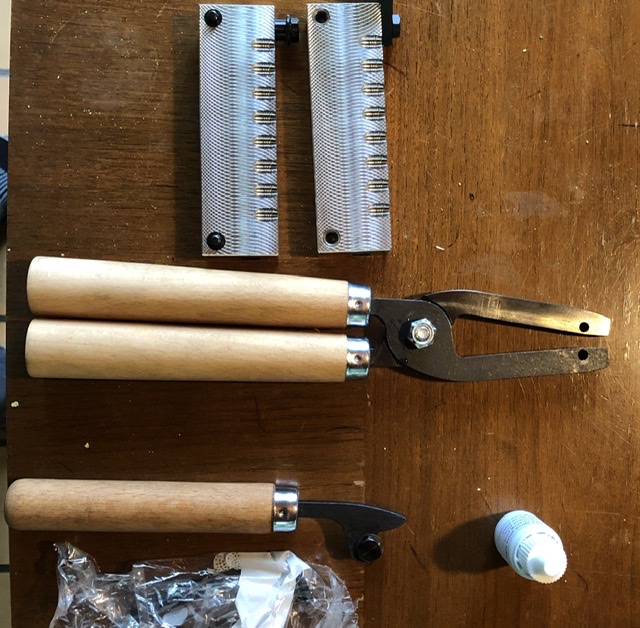

well, this just arrived. I am told these slugs work very well in .25 LW barrel
