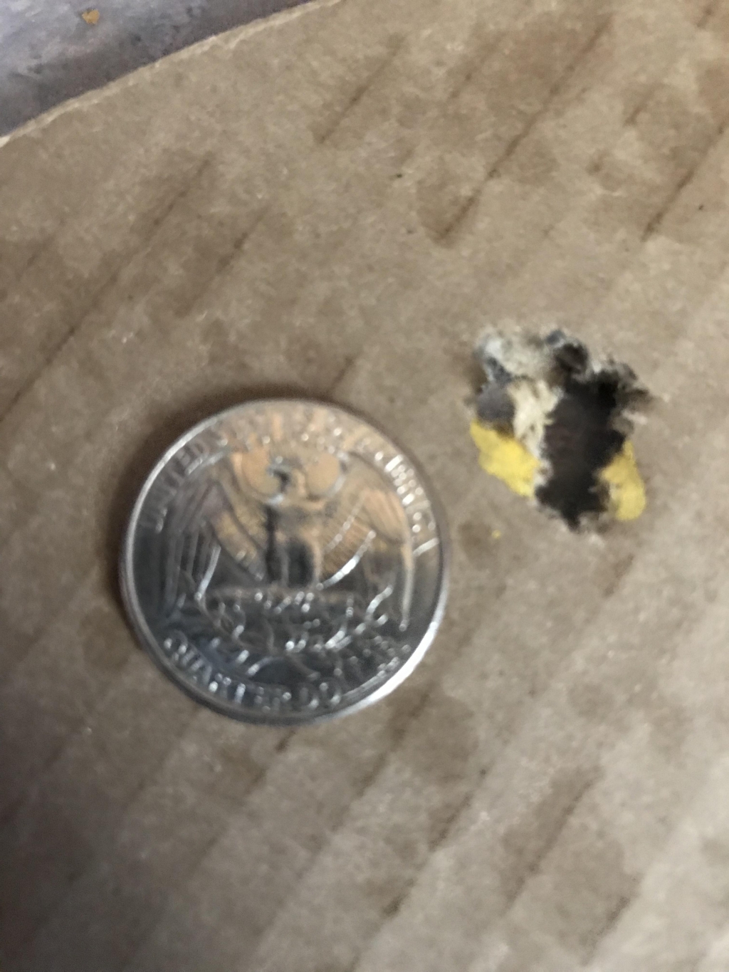

Bob you are a bad influence! 50yrds 22 streamline

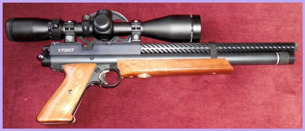

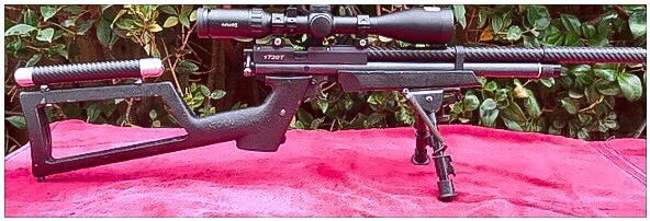

I suggest a 1720T in .177.
This pistol will drop any sparrow it sees and if you must have a rifle, it can be outfitted to look and feel like one.
Side note: My hunting partner in Kansas has devistated the cowbird population with his IZH46M...
My 1720T puts out just short of 12fpe and is deadly accurate:

+1 for the Benjamin NP. Im sure there are several other guns that are equal in quality for the same money. I am very new to this too. I've been shooting and hunting with rifles and pistols for over 30 years. But, I am just getting into the airgun hobby within the past few months.
My Benjamin shoots 20 shots in a dime size hole at 25 yards, with just the cheap trigger mod and the right pellets. I know there are much better guns out there but I am very pleased with this nitro piston ($140 on amazon)
There is so much to enjoy about air gunning. I shoot more and shoot more often. Range, wind, pellet weight and shooting form are critical. I know I will be a better shot with my powder burners but have no desire to shoot them when I can grab a tin of pellets and shoot as much as I want in an evening for less than $5.
