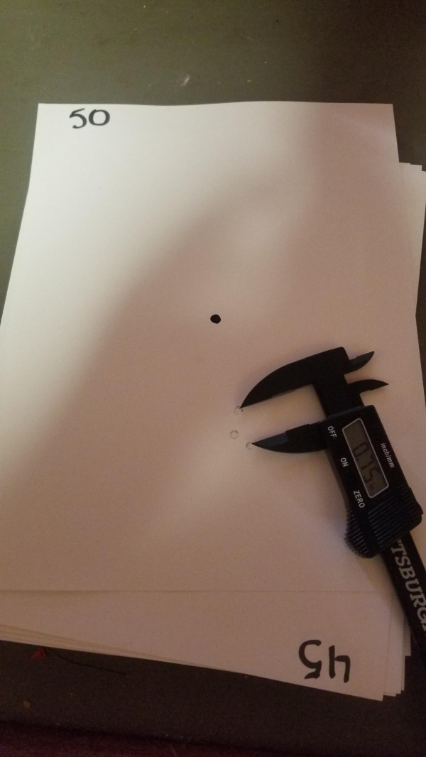

I have a Maximus in .177 and a Sheridan 2260MB which is a Co2 Disco. They are both well made and have a quality non toy feel to them. We have shot the snot out of the 2260 and it has been solid, I ended up doing a shorter 18" barrel on it but the factory barrel really liked JSB pellets. I just recently got the Maximus over the memorial day sale, .22 is still out of stock but the price was right that I just went with the .177. Not to sound smug but I have a couple marauders and I was not expecting a whole lot from the Maximus, I was wrong. It is solid and well made. It is a long rifle but it is very light and handy, it shoulders well and I get a better cheek weld with it than the 2260. It came out of the box shooting HARD for 25 shots. It was doing 20 foot pounds with JSB 10.3grn pellets. I put a .42 hammer spring in it and I cut the noise in half, doubled the shot count and made it a 15ft/lb gun. I have more details in these threads, I have over 500 pellets through the Maximus and it is a winner. Oh and the sweet spot for my Maximus like a lot of them is 1,800 down to 1,100 or so, not really a need to pump to 2K if you are hand pumping.

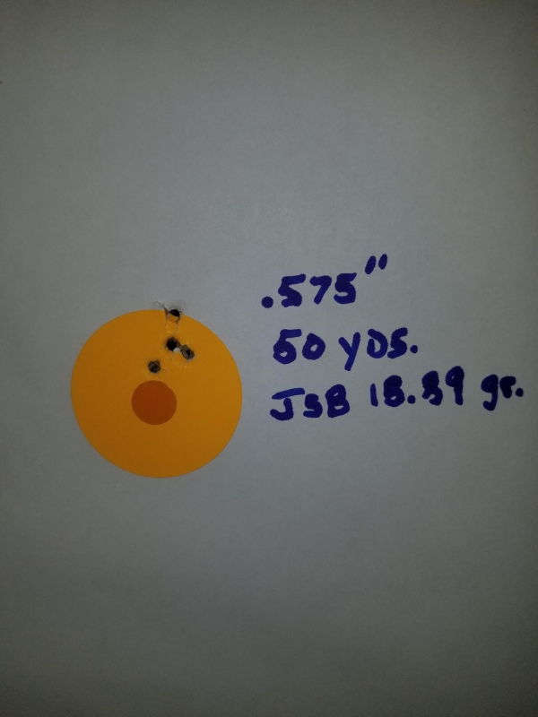

Haven't shot it alot. Only 220 rds, but here is my best 5 round group so far at 50 yds with my Maximus in .22
"MJGoebel"
"Locker50"Haven't shot it alot. Only 220 rds, but here is my best 5 round group so far at 50 yds with my Maximus in .
Hey Locker, that's not bad at 50, good shooting!! Do you know what FPS you're getting with the 18s? Looks like you got a sweet shooter there.
Mikey
MJ, thankyou. As for fps, no. I don't have a chrony. Those were JSB 15.89 gr.. I know, the marker bled and made the 5 look like an 8.
"Locker50"
"MJGoebel"
Mikey
Ah even better locker, the 15s shoot flatter. Sweet...
