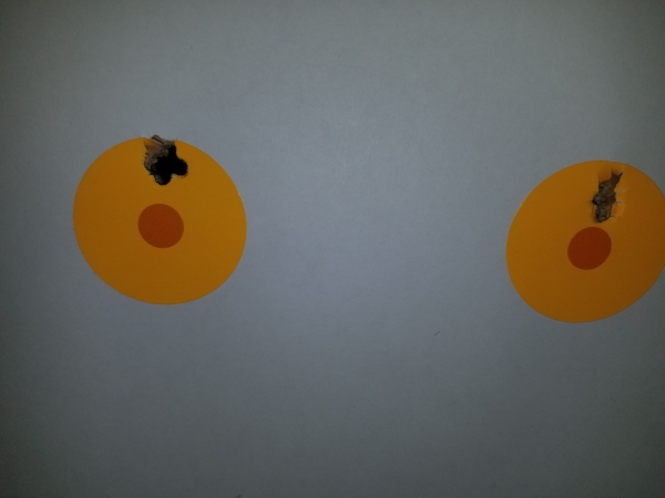

Here is two 5 rd groups from 25 yds this past Sunday. Beeman devastator 16.36 on the left. JSB 15.89 on the right.

Well I gotta say I'm just darn impressed with my Maxi H! I pumped her up to 2k and went out to zero the scope today. Here's what I did with six targets three shots each. The scope was right where I wanted it at 10 yds. It was blazing hot today. By target six I had sweat in my eyes and dripping on my glasses. I'm surprised it grouped so well as the trigger needs a winch to engage. I'm not gonna worry about the trigger mod until I get a couple of hundred rounds through her though.
I wish I had a chrono, I'd love to know what the FPS is on the JSB 18s. I'm sure loving the accuracy. I can only shoot 10 yds at home but am heading to the farm next week. Ill see what she does a little farther out.
Fantastic shooter so far...
