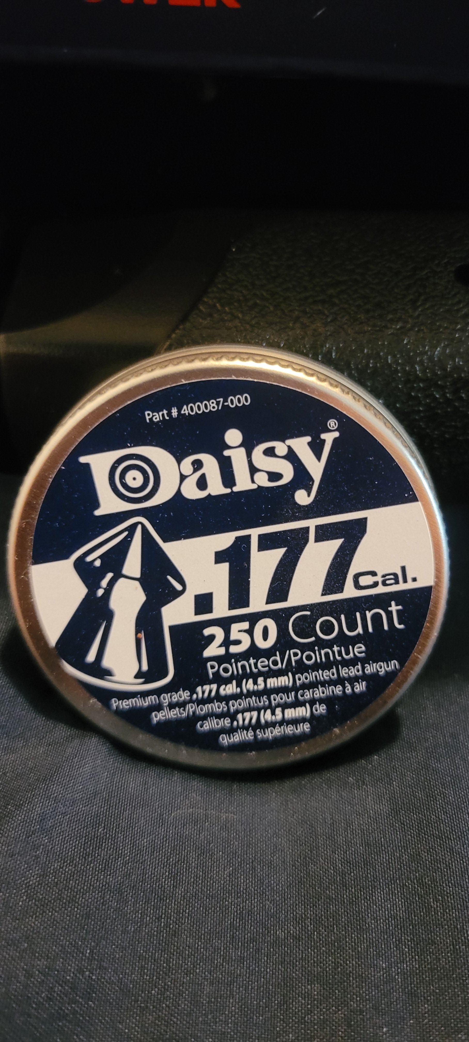

So I just recently purchased a Crossman rifle .177 caliber to do some rodent control, and I read that the pointed steel pellets work great with this rifle. Well I purchased the daisy .177 caliper steel pointed pellets 250 CT. I load the rifle and pumped it released the safety, pulled the thing on the side I forget what it's called and aimed and pulled the trigger, nothing came out. I checked and the pellets look it was mangled but it just sits there but it will not shoot out! Am I doing something wrong or are these pellets not meant for this rifle? Please help. This is my first time owning one!

First off, Have you read the manual? I believe that the magazine is only used for BBs and that pellets are loaded one at a time in that type of rifle. Get the stuck pellet removed first and go slowly, you'll figure it out.
Very good, on clearing the jam. To prevent further jams, stop using those Daisy pointed pellets (Seriously). Almost any other .177 pellet will feed (and shoot) better than those. Even the wadcutters (flat faced in simple terms). In fact, wadcutters would be more beneficial for rodent eradication as they hit harder and limit over-penetration. Don't take my word for it, just ask (or search)...
You can still buy Daisy's, just not pointed 😁

Next shopping trip get some wadcutters, domed and hollow points. The one that's most constantly accurate is what you should be using. Gun chooses ammo it likes, not the operator.
