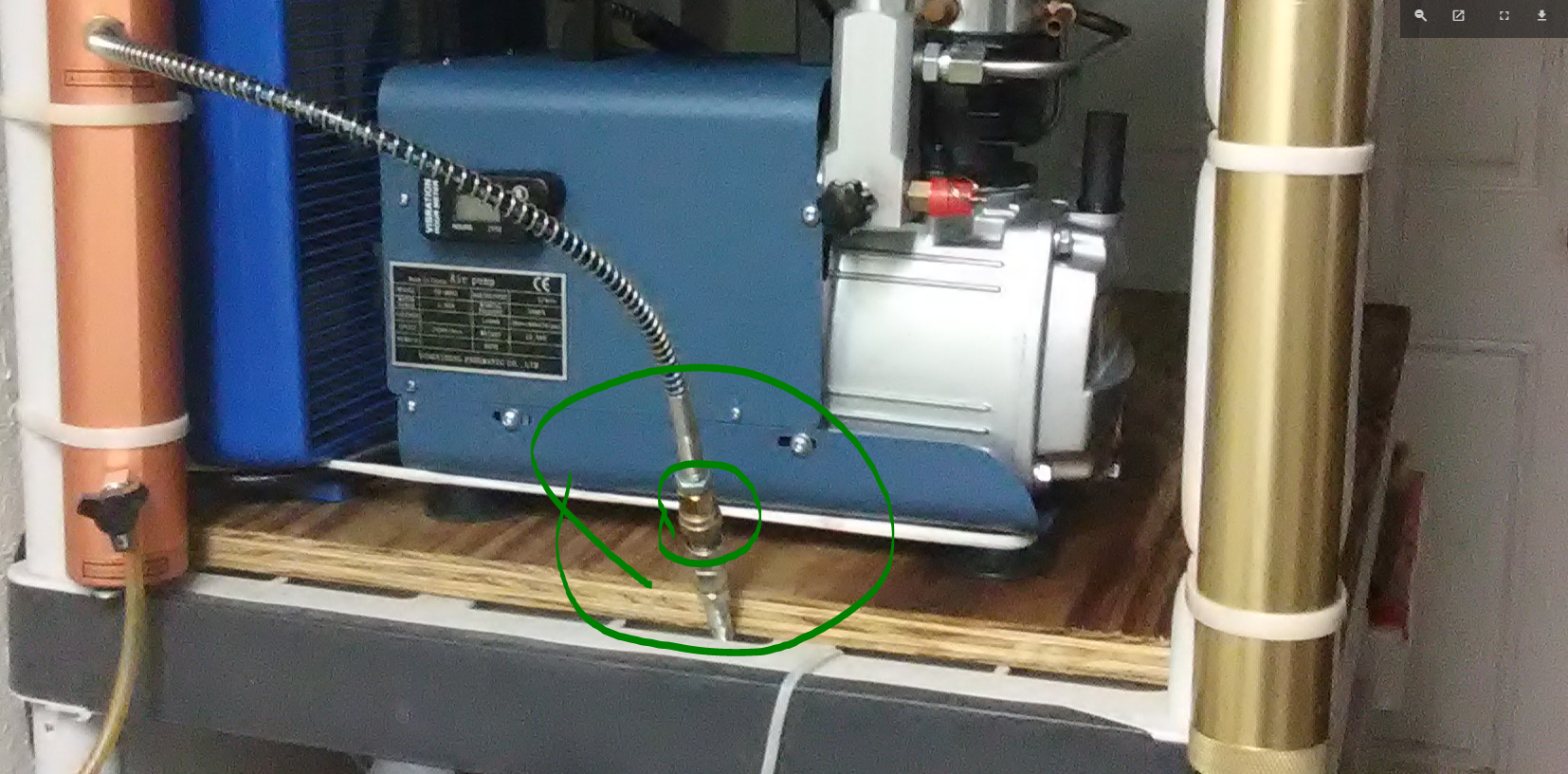

Help, How can I connect this air venturi fill whip to this 4500 psi blue filter do I need an adapter or should I screw it in?.
  1. Need help am trying to run this air venturi dn2 1/8th bspp fill whip from my filter as shown in the pictures, As im screwing it in by hand im starting to feel a bit of resistance so I stop, I dont know weather this is the right thread size, I dont want to damage the threads, Is there an adapter to make this work.? I dont want to have to buy a new fill whip.

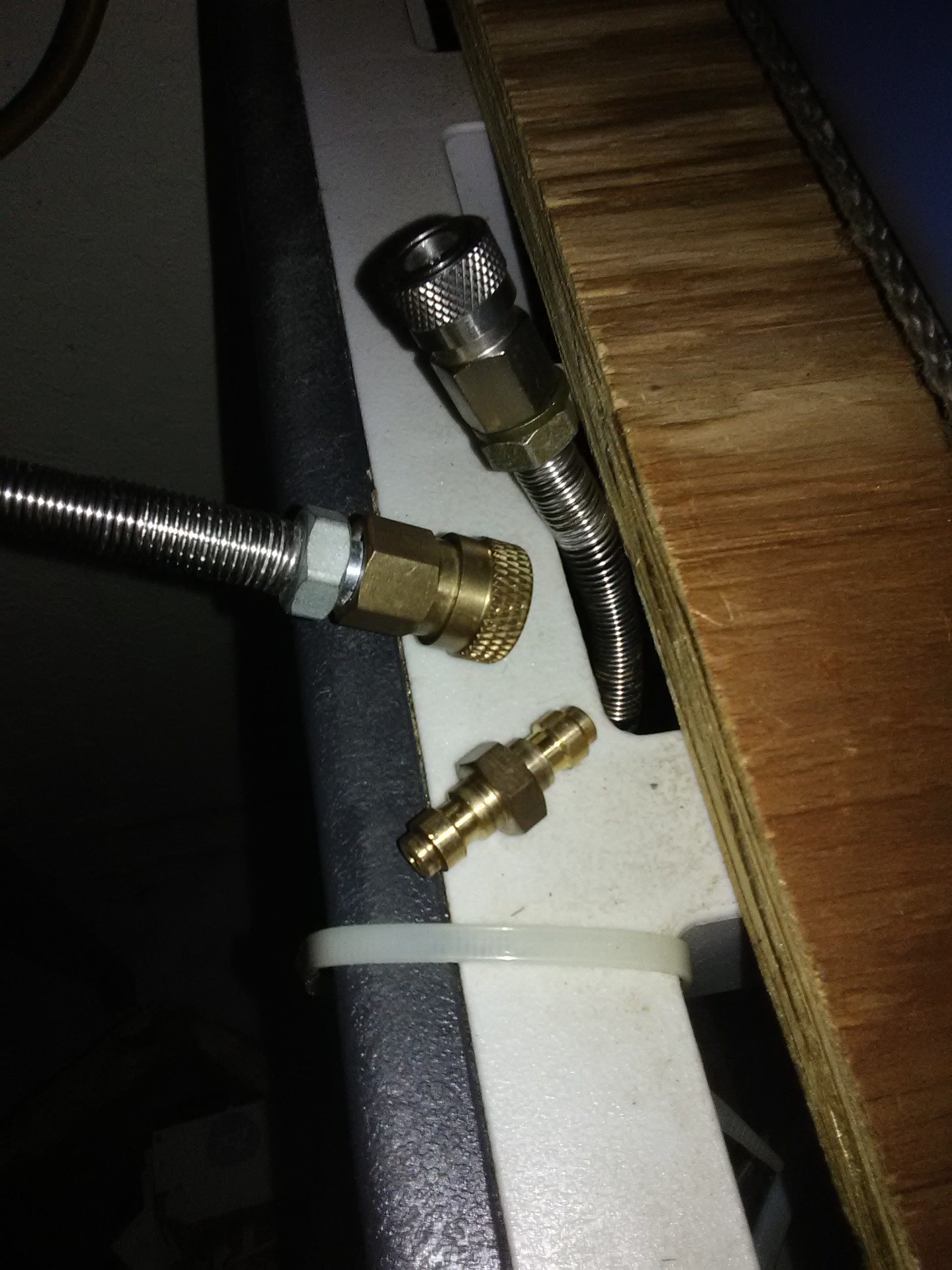

I'd use a male foster adapter to screw on hose "Dowty" washer end, then re-install female foster in filter. Male foster adapter looks like one in photo, they come in Delrin and Dowty sealing styles. WMView attachment 354016
I dont know what I was thinkin buying this adapter I dont know amazon easy returns an, But I realized I need the 1st one down to the left like this, Should I still keep the other one maybe might come in handy my fill whip is both female ends now. https://www.amazon.com/Universal-Qu...p+adapter+male+quick+disconnec,aps,135&sr=8-3
I dont know what I was thinkin buying this adapter I dont know amazon easy returns an, But I realized I need the 1st one down to the left like this, Should I still keep the other one maybe might come in handy my fill whip is both female ends now. https://www.amazon.com/Universal-Quick-Disconnect-Stainless-Paintball-Charging/dp/B08YYQT928/ref=sr_1_3?crid=17DMORV9992GQ&keywords=1/8th+male+bspp+adapter+male+quick+disconnect&qid=1683497972&sprefix=1/8th+male+bspp+adapter+male+quick+disconnec,aps,135&sr=8-3

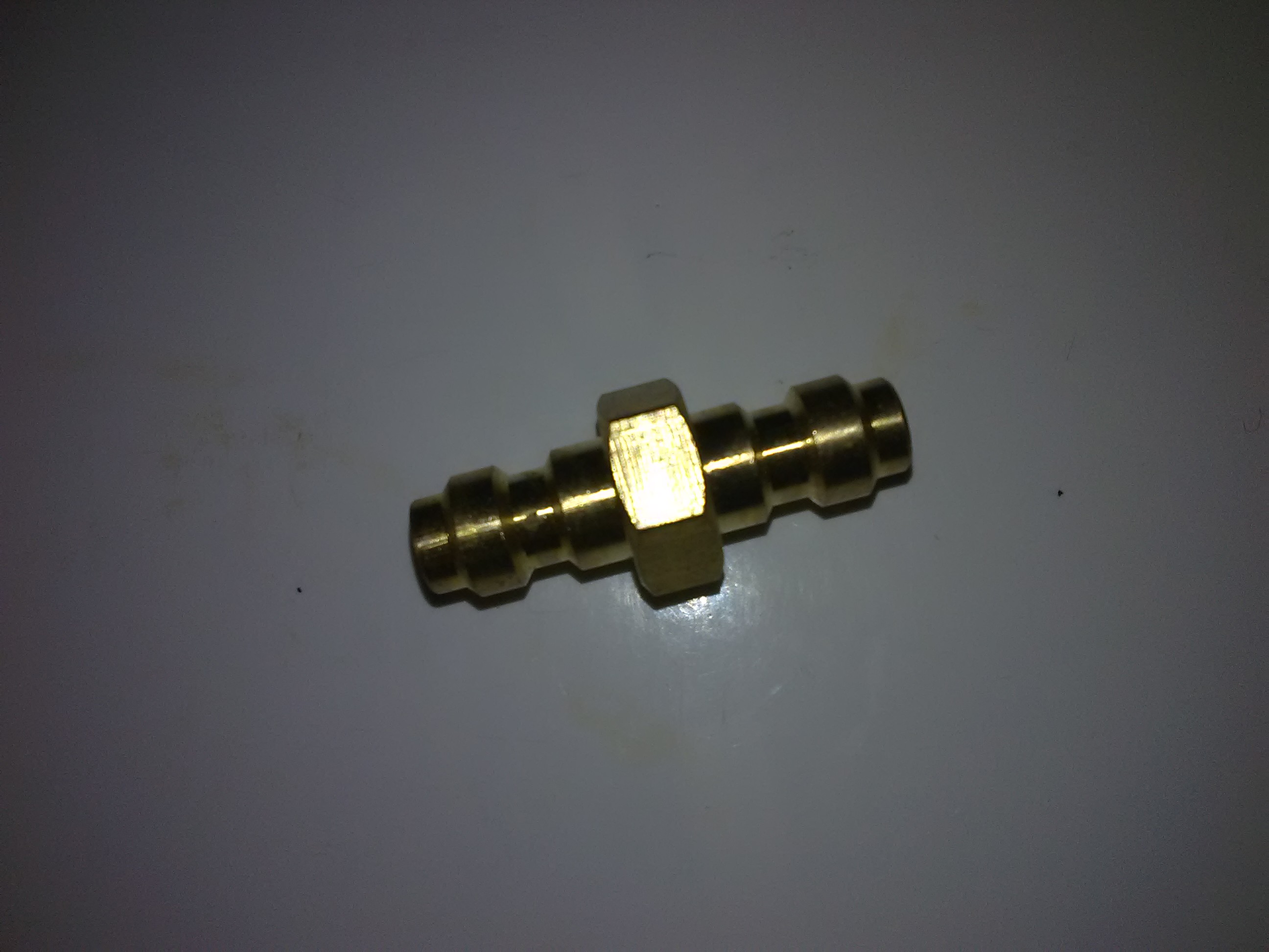

Bought two male foster fittings each, 1/8 NPT and 1/8 BSPP, just to have in my PCP supplies, as well as a 10-pack of Delrin Washers. Doing it all over I might have bought a pair of the 10mm fittings, too. In setting up my Yong Heng fill station I laid everything out as I wanted, then figured out what hoses and adapters I needed. Purchased hoses with the appropriate foster fittings already installed so when they arrived, I snapped the system together. Like you, I needed a double end male foster fitting (pictured earlier) to attach female foster fittings together in several locations. Bought a 3-pack off eBay for $9. WM
Aint no biggy I got prime one day shipping it comes tomorrow placed order, I could also go the male to male adapter but I dont know thats an extra point where it is not needed, why use 2 adapters for the same job when 1 does it.
Agreed, several ways to set things up, found I needed a long hose so used a double male foster fitting to attach two hoses I already had together, saving having to buy a longer one. WM

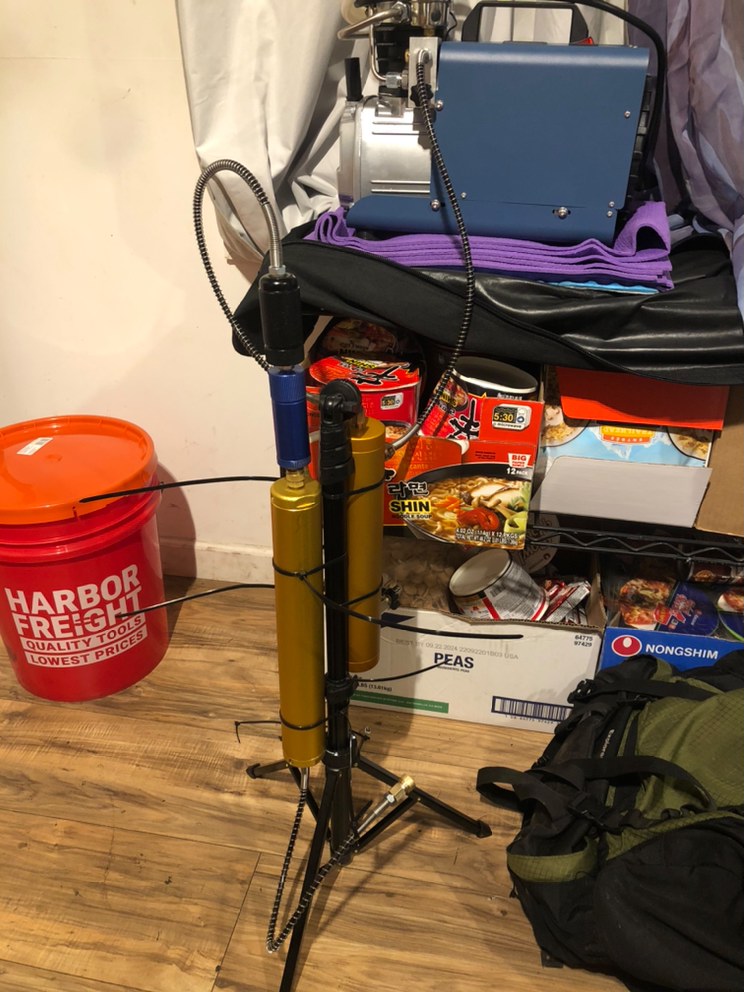

Easiest for me to show picture, then share my Standard Operating Procedure (SOP). Everything on shelf is permanent; stool, water bucket, hoses and water pump are set-up and broken down each fill session. Start by setting gun on white blanket (upper shelf) and connect fill whip. Fill water bucket and place on stool in sink. Assure water pump rear screen wide open, install hose, place in water. Attach both hoses to compressor and twist tie to bucket handle. Add ice bottles and allow water to chill for 20 minutes. Plug in water pump and pre-chill room temperature compressor to 18-degree C range. (Never pump chilled water to non-room temperature compressor.) Start rear 10-inch box fan on high. Assure drain valve on copper colored filter and both pressure-release valves on YH are open and crankcase oil level is correct. Start compressor, close three valves, during 3–5 minute fill normally open for split second each valve, one at a time, to release moisture. When gun gauge registers full open all valves, let machine run few seconds before shut-down. Water pump and box fan remain on. Release fill whip and replace with next gun to be filled. Fan and pump run till compressor cooled back to 18-degree C range and compressor feels cool to touch. Ice bottles may need replacing. Repeat SOP.
Huh What its m10 male threads that aint even a thread I redid my rig a bit i might edit it a bit later on or what not but its this, I wanted to know because maybe I might run it longer it not too long of a whip. from copper to compressor.
Sorry, that Quick-Disconnect female fitting came installed on the hose end when I bought my copper-colored filter. My guess would be a 10mm thread like you said.
