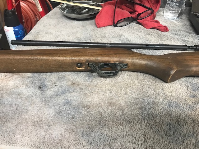

I inherited a old sears 22 cal co rifle but it does not match anything i can find. wanted to see if anyone has run into anything like this. the barrel identifies it as a sears 126.19310 which points to a crosman. But it gets odd here. see the pictures as there is no trigger guard and the entire trigger assembly is cast. One bolt thru the stock. started by trying to disassembly but appears to be a screw/bolt hold the gas holder. looked on crosman manual site and nothing matches
thanks for any leads
Thanks, I guessed the 180 and down loaded the crosman sheet also. Iif you watch any of the disassembly videos online, they all show 2 screws to drop the trigger guard w and then with the one nut under the stock it comes a part
i dont have the 2 screws. I did remove the single stock nut and the barrel pretty easy but the lower gas container and trigger wont come out seems to have something around the trigger guard holding it or it is just so tight in the stock as i dont want to damage anything to remove it

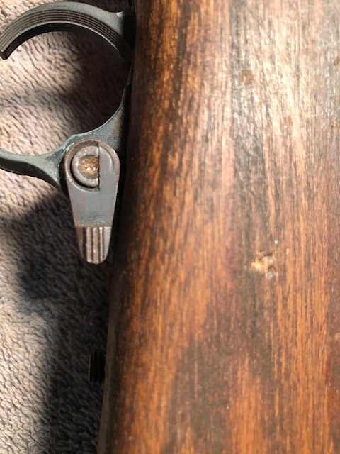

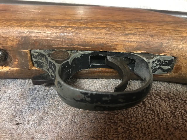

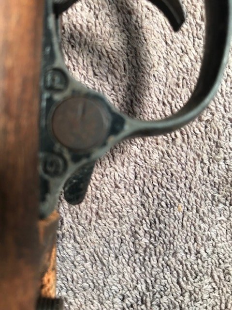

the safety is a bit rusted, have pictures. Looks like a pin in the center. Got it moving back and forth but at 90% nothing looks like it will slide. looks like a ear shaped holder which is larger than the hole. anybody have to remove one of these with a bit of rust and stubborn.
have pictures of both sides below
thanks
myles
You might put some WD40 or similar on it and get it moving freely, then turn it in between S and F and push it out. Being that it's rusty, you might have to tap a little to get it moving. Don't force... it should come out relatively easily.
Bob
the penetratingly oil over night worked, popped out this morning with no damage. T
