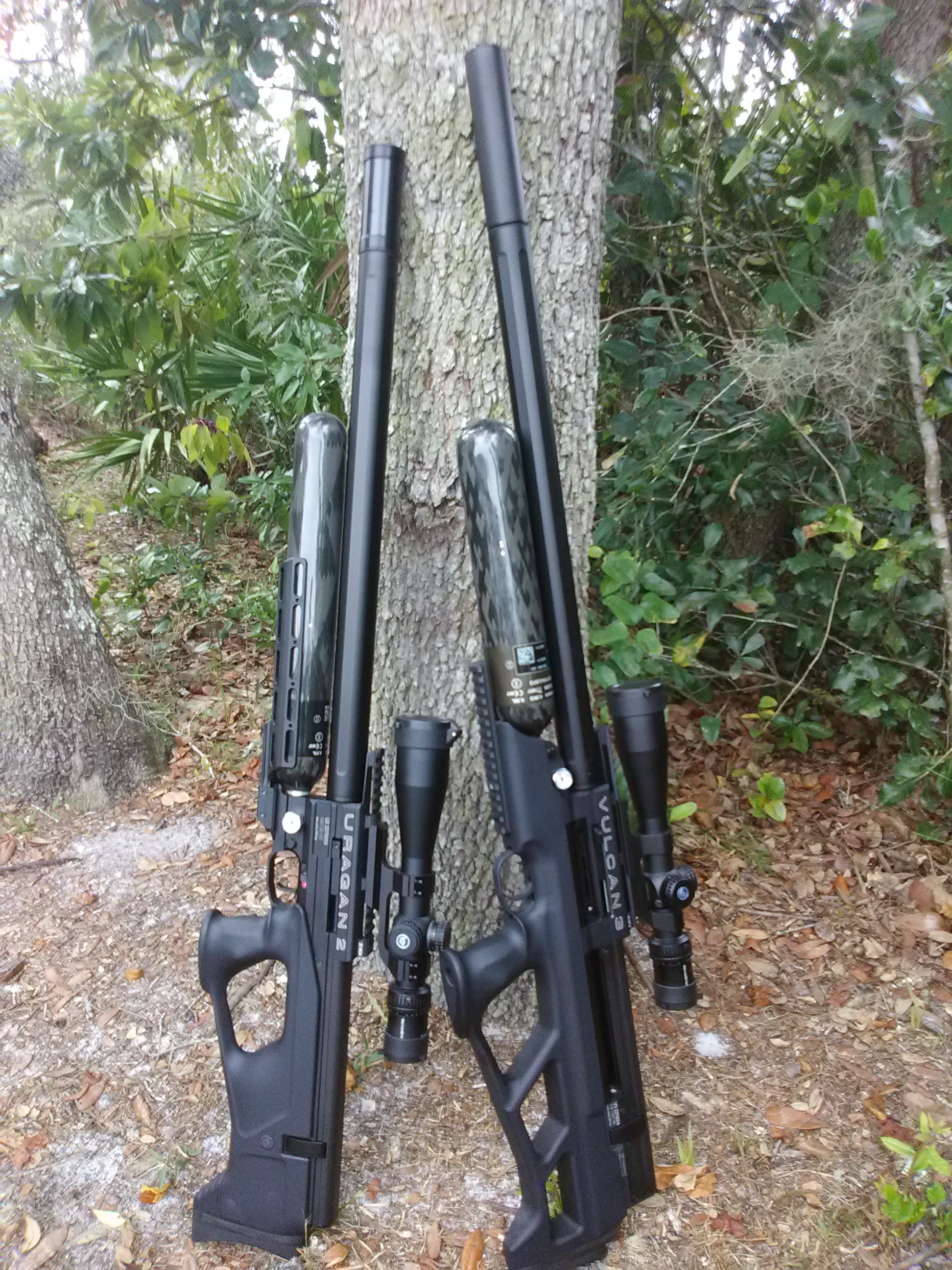

Haven't run either V3 or U2 .30s off the reg but big bottles, at 300BAR, really last. WM
Reactions: ChefSparrowRagazzi
Shot side by side for a year, similar power/accuracy, but U2, with balanced valve, is preferred. Smoother function, quieter and less ammo fussy. V3, even with factory depinger, produces loud clang in ear, hardly noticeable in U2. WM
