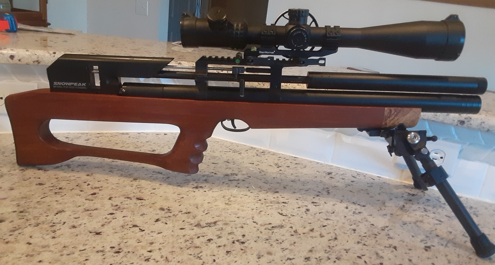

Looks like we reviving a thread from September. But just in case you don't think P35s can be pretty too... This is my P35-25 with a power plenum on it and a home made wood stock. The body of the stock is made from wood from old church pews and the nose piece is a hunk of highly figured oak from the stump of my "killing tree" that died due to root rot. With the power plenum I am up to about 49 fpe for about 40 shots. The scope is not it's normal, it is a 8-32 Vector I use for target shooting. I'm testing a new barrel for it. It shot a 192 at the 30 yard challenge with the old one and that was after only a few targets following the retune. I shot the new barrel for the first time today. Too early to say which is better. The old one is pretty good.
