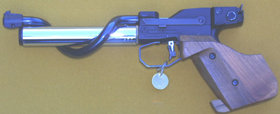

Edit: yeah google Ed Canoles, he posted the best barrel bending jig that I've seen so far. Easy to control and does the barrel re-adjustments in increments.
(who in their right mind would do that to a barrel??? maybe to win a bet?)
