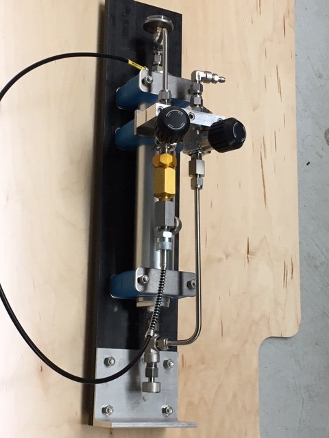

One thing I don’t see on all the YH’s and copies and anything short of a legitimate scuba compressor is an item called a PMV (Pressure Maintaining Valve). Scuba compressors MUST have one right after the molecular sieve so that the sieve does its job. A PMV is an adjustable device that is set somewhere between 120-160 bar (1740-2320 psi).
The reason for it is that for the sieve to remove moisture, the air needs a “dwell” time in the sieve. The PMV makes that happen. Dry air does not leave the sieve drier until the PMV’s set pressure is exceeded. Why they aren’t used or mentioned when used on the YH’s and similar is a mystery to me. All Alkin’s, Bauer’s, Coltri’s and other scuba compressors come equipped with molecular sieve driers and PMV’s.
I will also add though that a lot of people are running YH’s and similar with out any issues, I think ??
My first compressor was an Omega Air Charger that I added a sieve that I got from Air Tanks For Sale. The photo shows my set up that I fabricated. The gold colored item is the PMV.

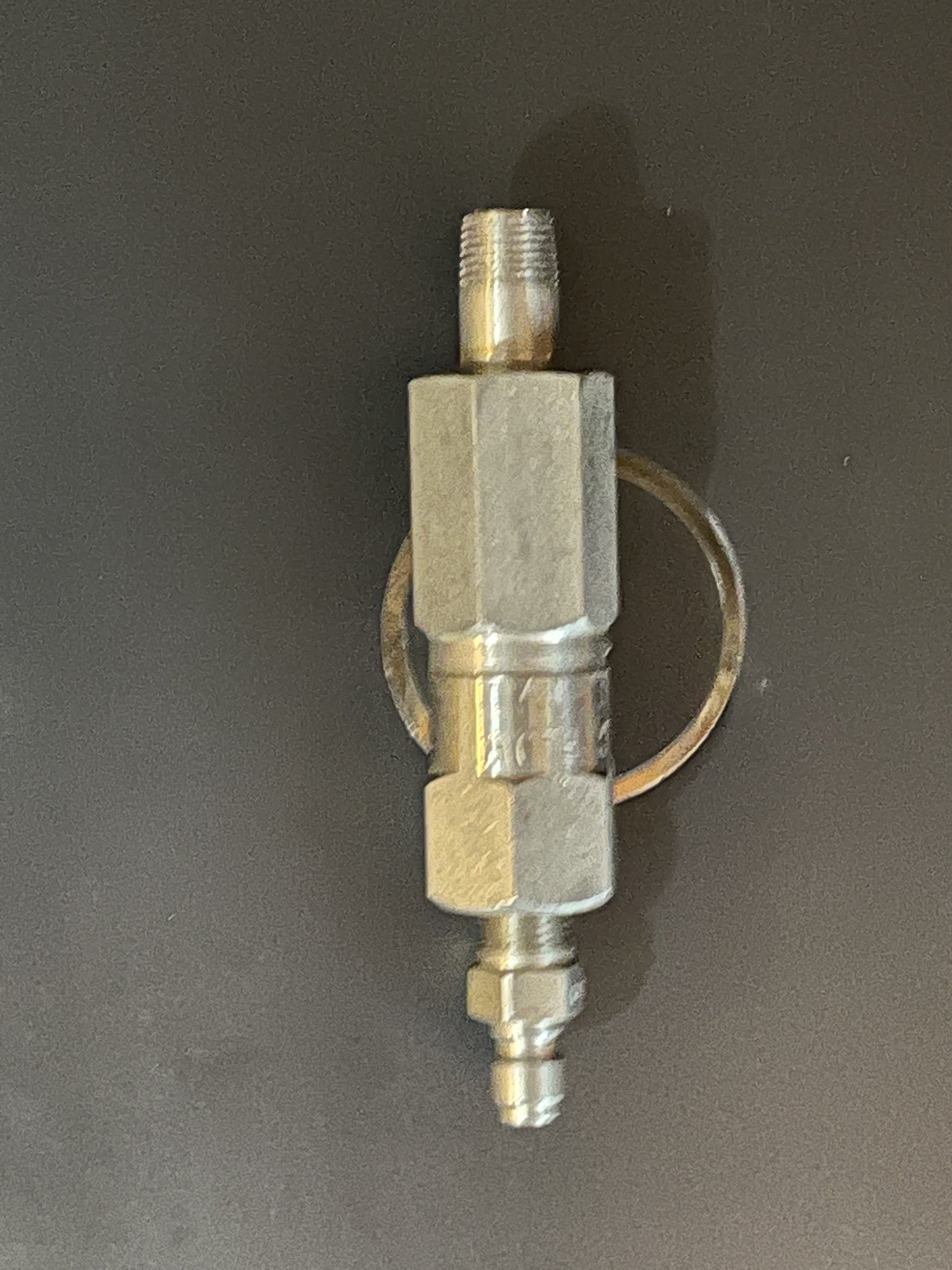

I rigged my filter up with a check on the outlet to save all my pressurized air on everything past that in case of a sudden leak on the compressor side. It also allows you to open the fill bottle and then start the compressor anytime.
Then it dawned on me the check could go on the inlet side so if you wanted to turn the compressor off all you need to depressure before a restart would be the short hose coming off the compressor. Using a check like this.
Reactions: mb94952
I agree completely about the value of a check valve. Another benefit is it doesn't matter when you open the bottle valve. Air cannot flow from the bottle to the YH overpressurizing it as it is attempting to get up to pressure. I still start the pump first and let it build for a few seconds but I don't try and time the valve opening to the point the pump pressure matches the bottle. It makes things a lot easier. I got mine off Amazon (and my male to male too)

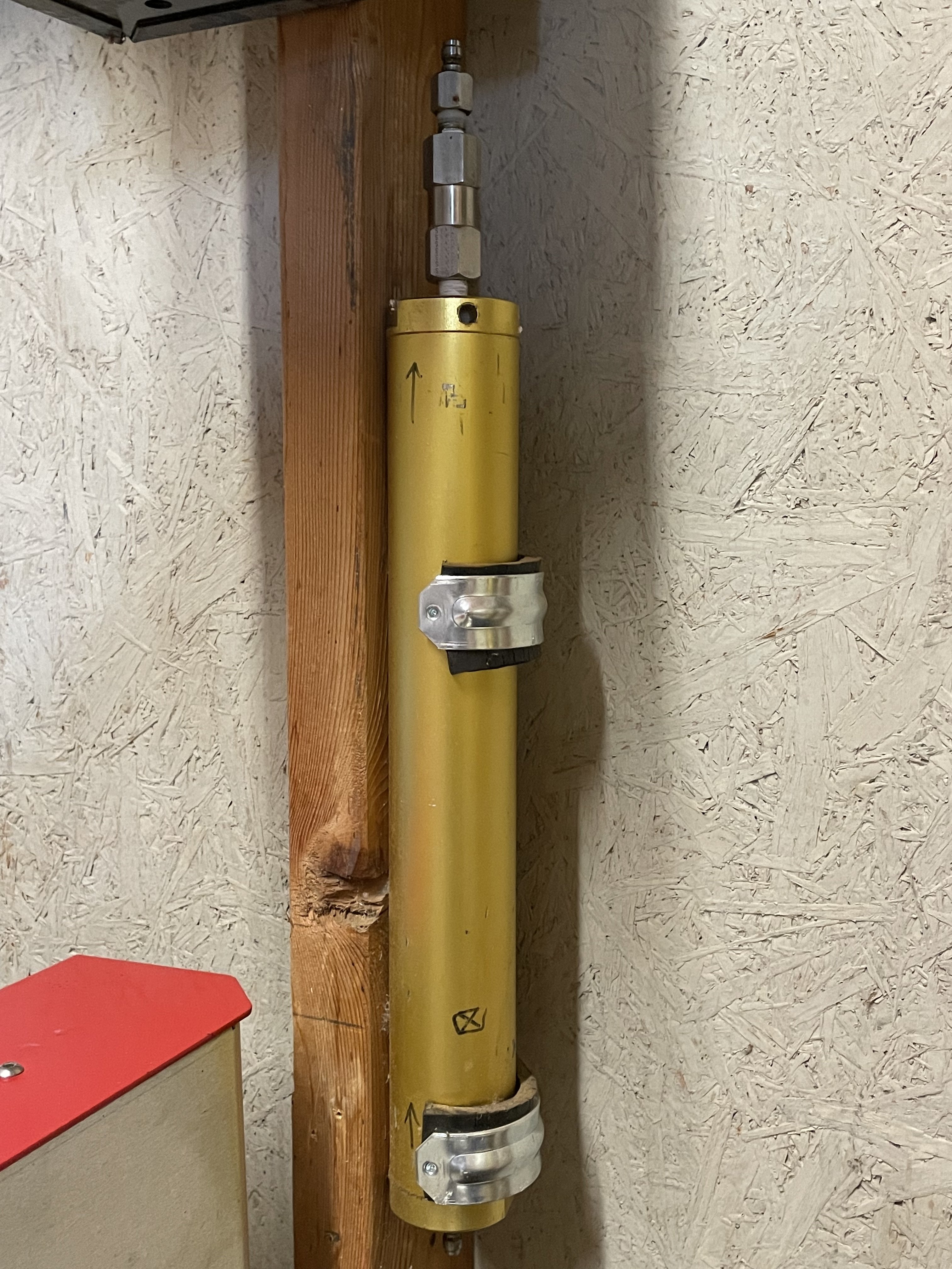

I also think having the filters vertical ABOVE the YH is much better if you can arrange it. The air will cool going through the filter and moisture will come out. If you allow it to drain back to the YH it will blow out when you open the vent. I open it approximately every 5 minutes. I have color change beads in my extra filter and I rarely need to change them, they see little moisture - despite the really high humidity here in the summer. No signs of moisture in my tank or guns.
