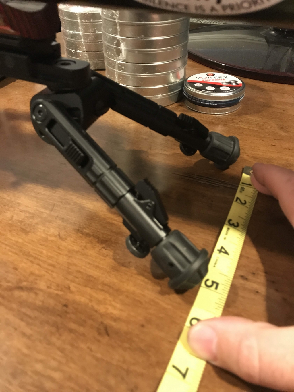

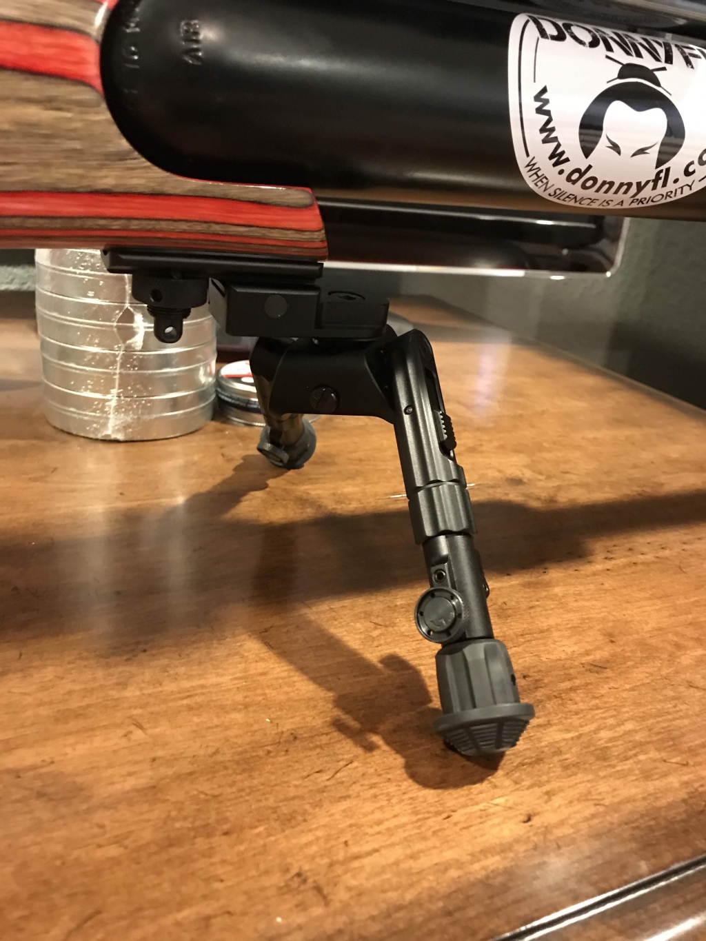

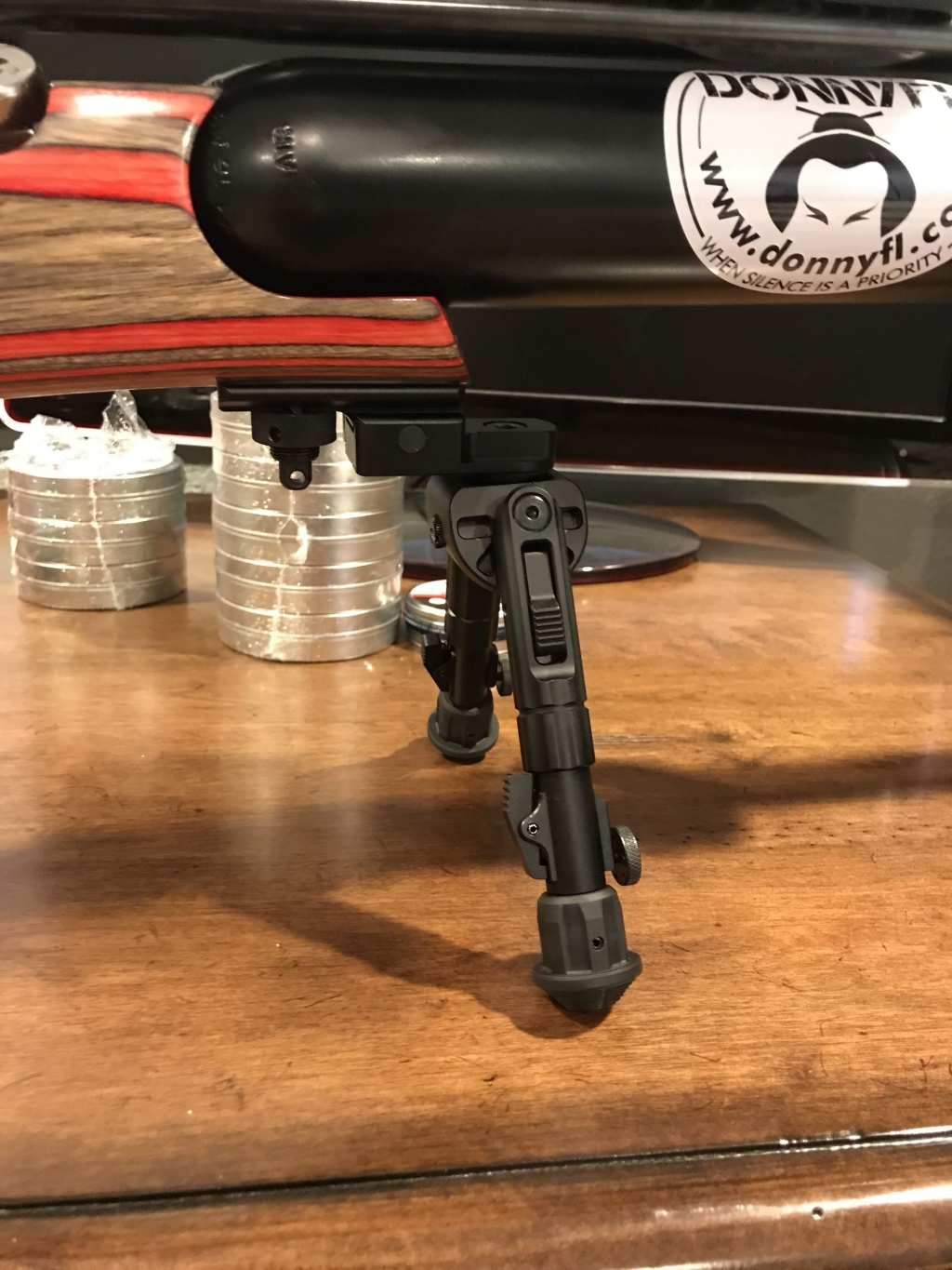

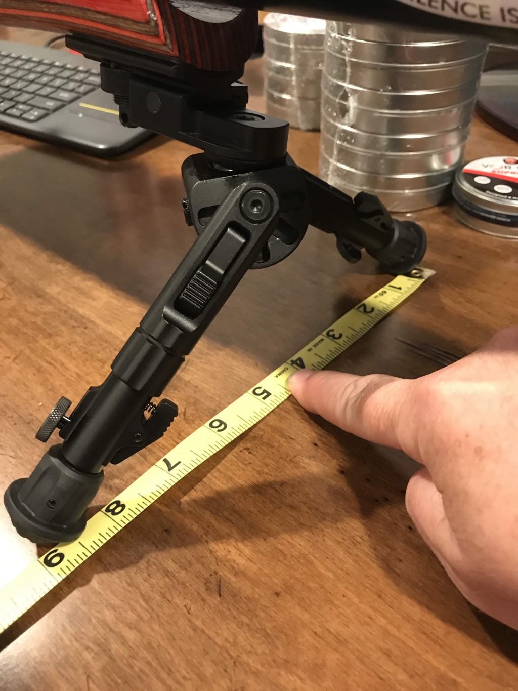

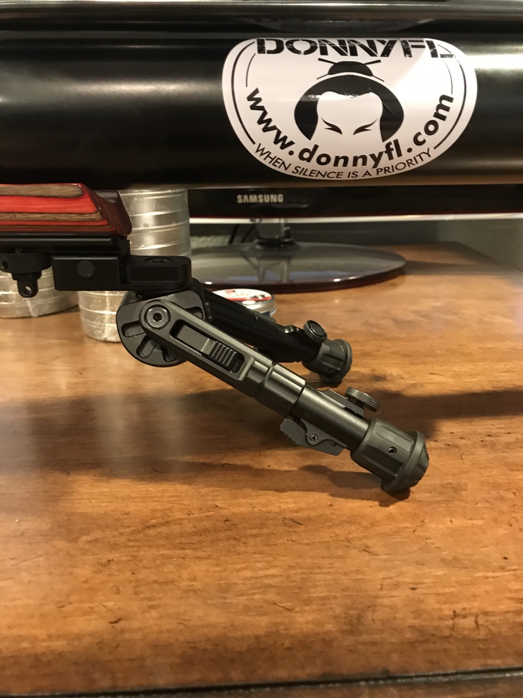

+1 for the UTG heavy recon. You can put one leg forward and one back and rotate 45 degrees to have it very low and very wide.
Standard position

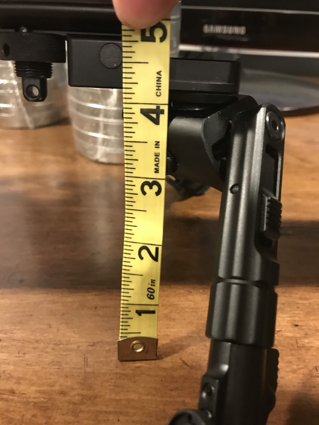

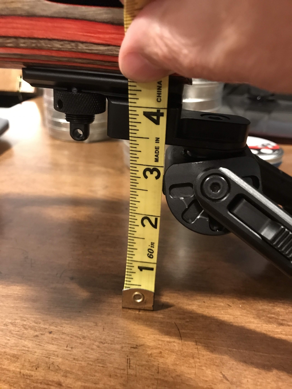

Feet forward 3.75" to pic rail 5 " wide
One forward and one back
4.5" to pic rail but now 9" wide! Very stable
As a bonus it is guilt free since it is not a knock off of someone else's design.
They are fairly cheap too, usually around 50.00.

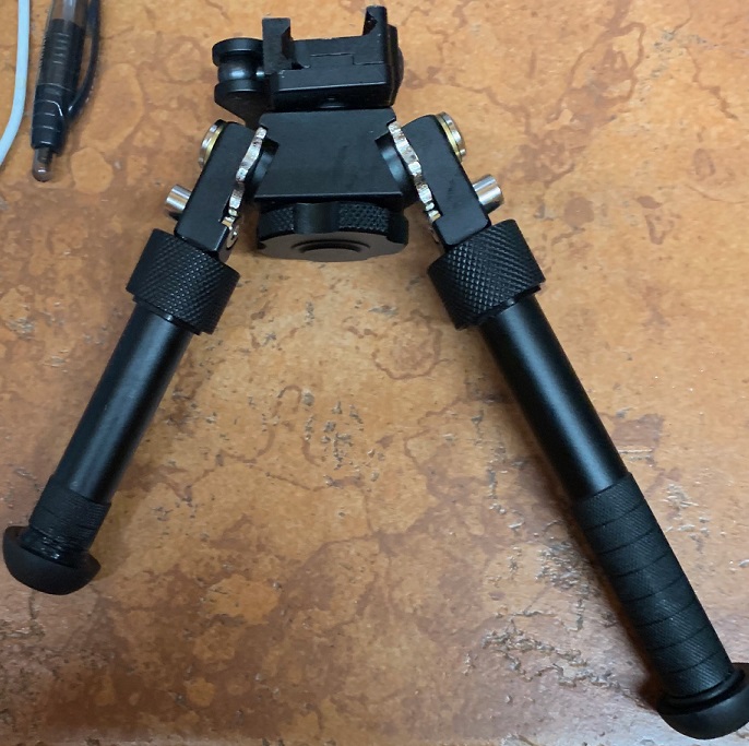

Decided to finish my attempt at my mod with hand tools on my atlas knockoff... Finished one leg.
I can still adjust 2 notches longer, but I didn't drill and slot for the stop spring so it will pull off if I go past 2 slots and I didn't drill for the foots stop detent. It's simply held in with some silicone sealant right now. Now the question is, can I duplicate that on the other leg??😂
