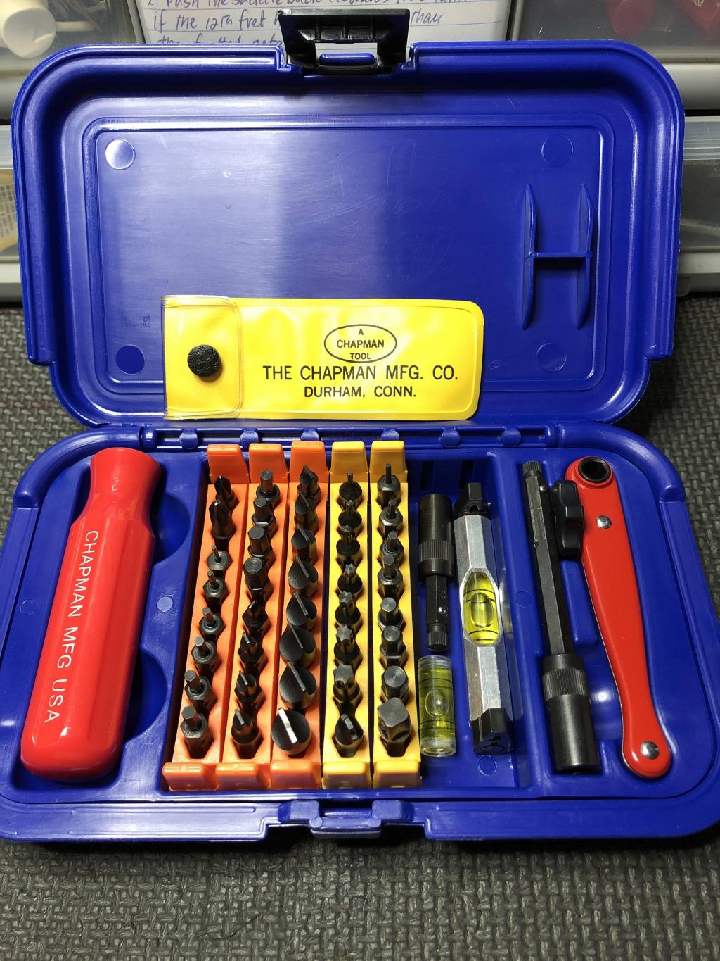

The gold standard for gunsmithing screwdrivers used to be Chapman, with the large, modular selection of bits and the ratchet that slips over the shank of the tool, allowing you great torque and control while also easy to push down on the handle. I bought a set similar to this after scratching one of my guns while trying to use a standard slot screwdriver.
I strongly support the use of Chapman-type hollow-ground screwdrivers. They help keep the heads in pristine shape. Any tapered screwdriver will deform the head. I wish the previous owners/service folks who owned the air guns I have had always used the right-sized hollow-ground blade screwdrivers! So many of them have badly damaged screw heads. I am finally getting around to ordered replacement screws for most of them. Some I might have to machine myself.
