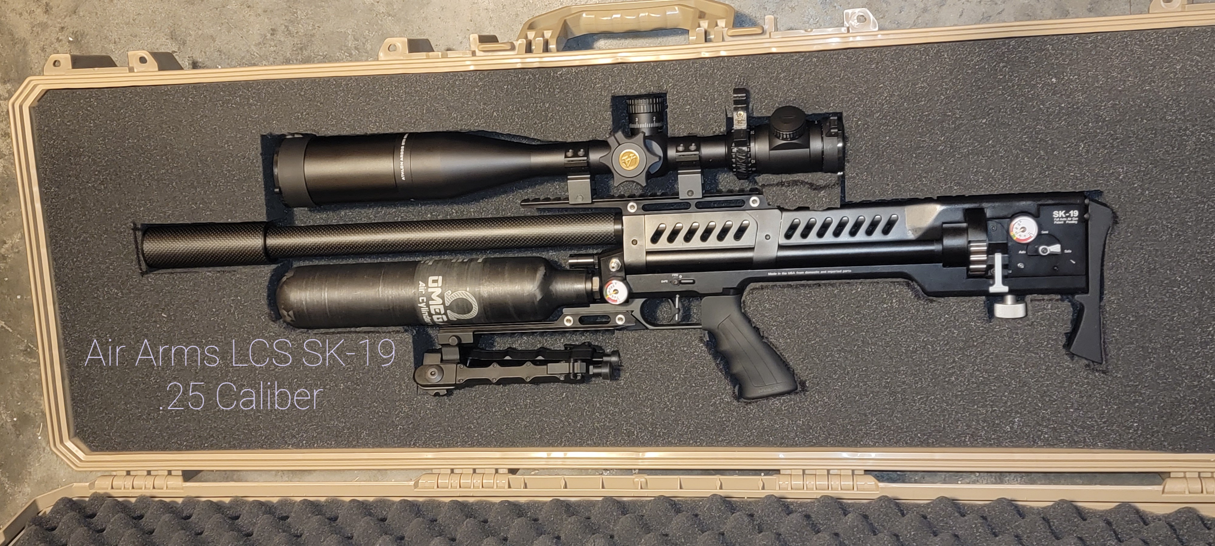

Here’s a pic to give you some ideas.

@Deltaman - Nice setup! I suggest having the grip pointed at the bottom of the case so the scope is not getting banged around. I did not cutout my rifle in the foam because padding is good and I am clumsy. I wanted as much padding as possible inside the case. Plus, I have a lot of rifles and only two hard cases so I can use any case with any rifle. I would have over a dozen hard cases!

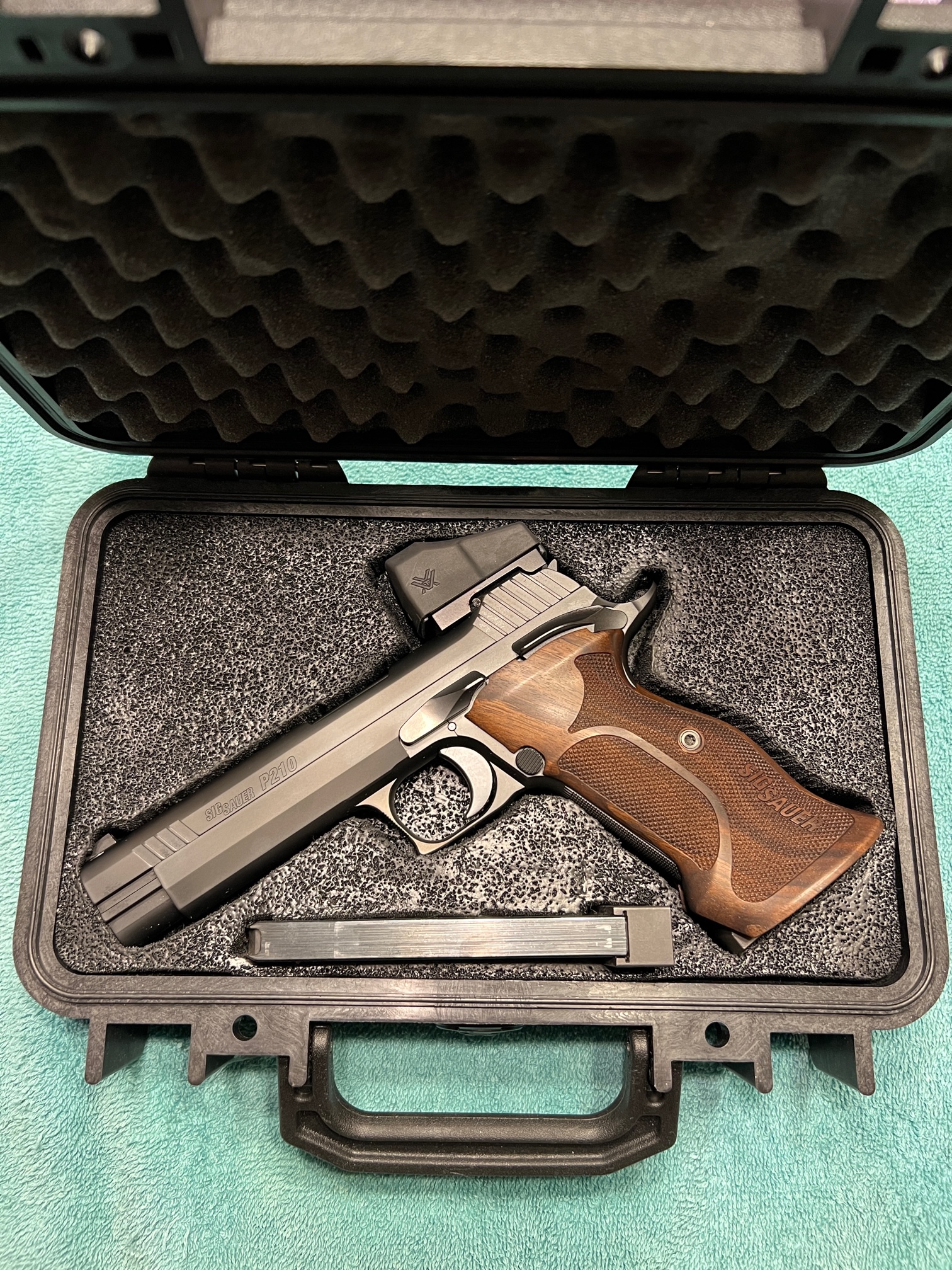

After getting the foam cut out for everything, I take the foam out the case and spray a couple coats of spray Plasti-Dip over the foam. It seals the pick&pluck foam and leaves a nice texture to it...it also prevents the edges of the cut outs from tearing and getting ragged looking over time. Here's one of my target pistol cases that I did it on.

Place your gun so that scope is next to handle, not hinge line. Then your gun will be upright when you carry the case.
Lastly, place the butt of your rifle at the end with wheels so that when towed, or stored standing, the gun will be pointing muzzle up as you would store it in a gun safe.
