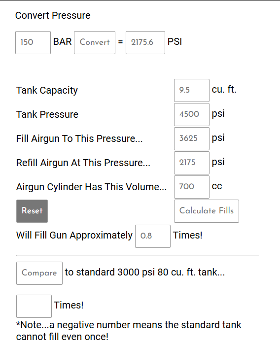

sorry- did it wrong.. 1000cc tank is only 0.035 cf but under pressure of 4500psi its 9.5cf
but its still not making any sense because it says that i will get 0.8 fill so not even 1 full fill although i am filling from bigger 1000cc tank at 300bar into smaller 700cc tank at 250bar... weird

Those calculators will get you really close, but the best way is to just fill and see what happens. Remember that it will depend on how low you get your tank on the gun as well. And typically we don't fill at the EXACT same pressure each time.

but in this calculator one puts in the exact amount at which the gun bottle will be filled from the tank- in my case at 150bar, no sooner and no later..
i don't get it why a bigger 1l tank at 300bar will fill a smaller 0.7l at 250bar tank only 0.8 times 🤒 it should me more like 1.3 times or something like that.. it makes no sense but ok, lets just leave it at that..

While I agree with AlanMcD's analogy I don't think it takes into account the "fill" level of 250 bar. This is where the fill calculator is accurate and the above description needs some refinement.
The 1000cc tank is only good to refill until it's pressure equalizes to the pressure of the 700cc tank. The gun fills to 250 bar - so you only have 50 bar x 1000 cc = 50,0000 bar-cc until your source reaches the fill pressure of the gun. At this point you've only filled 50k bar-cc of the required 70k bar-cc for a single fill. It's all downhill from there and I would expect you'll even out around 225-230 bar. Taking into account losses from heat and fill tube air losses I think the original 0.8 time from the fill calculator is accurate.

Sorry my man - see my reply above. Trust the calculator - it is correct here.

Great info! thank you so much for accurate data.. the other pcp friend just made a calculation mistake somewhere, its all good - happens to all of us!
so i should still get 0.8 refill with 1l tank but with 6.8l tank that should be around 6.8 x 0.8- 5.44 or just shy of 5.5 refills right??
