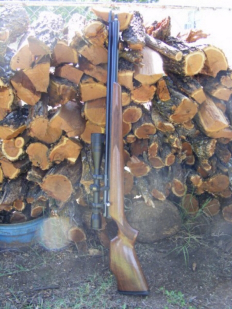

That AAA fits the bill and is nice, but it's more than I'm wanting to spend. Thanks for showing me.

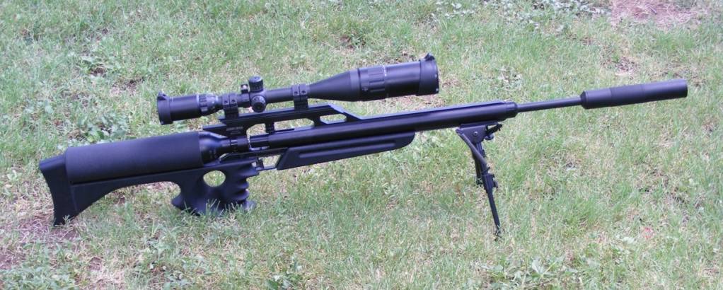

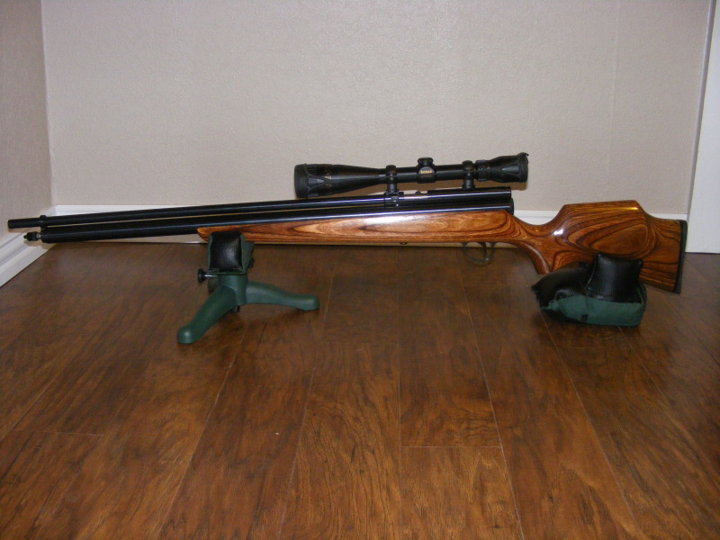

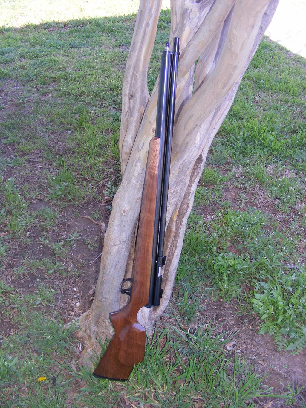

For fun. My old DAQ's. Missing that .458 Select/Laminate.
