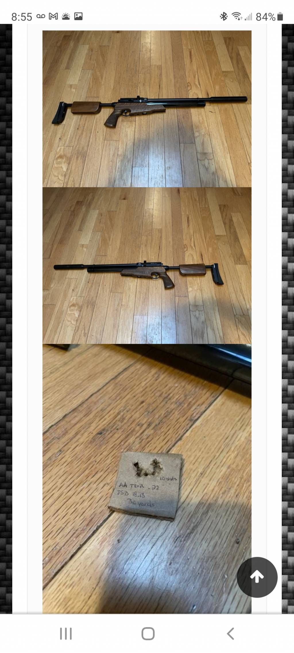

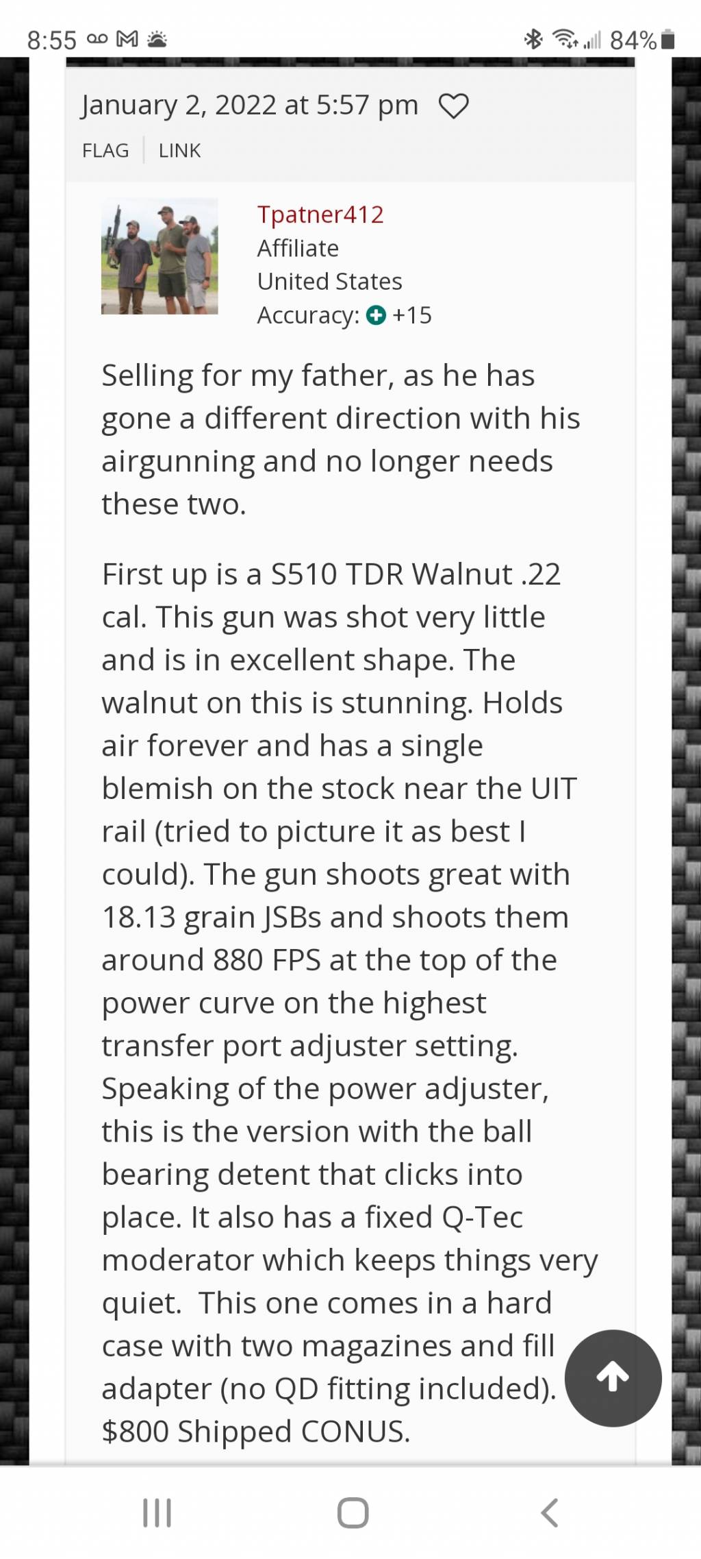

For your $800 budget I would take a very hard look at this gun sitting on the classifieds now. A quality gun and known accuracy
I think the classified are a great place to shop for what you describe as wanting. I hear great things about the S510s although I have no experience with them. I have a Marauder gen 1 .25 I would describe as the Jeep CJ of the PCP world. Rugged, reasonably accurate, they have been wildly and radically modified, or left as stock workhorses. A field and target model would suit your described uses well. Whatever you get I recommend an air dryer and pump. Hand pumps are notorious for adding water vapor that condenses causing corosion.

^^ Not knocking the Air Arms brand except but in this case. Usually well known for manufacturing accurate guns since they supposedly use Lothar Walther barrels.
That 10 shot group is from only 30 yards. Looks like over an inch. I wouldn't buy it if I wanted to shoot any farther than 30 yards especially 50 and 75 yards as the poster mentioned. At least not with that barrel.
A buddy of mine has an Air Arms 410 which is probably close to 10 years old and I got to shoot it a while back. Groups were easily consistently half that size at 50 yards all could cover with a dime. It also did not have a regulator just like that 510 for sale which appears to be unregulated as well.
