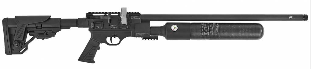

My new regulated Hatsan Factor RC comes with a transfer port selector dial with 3 power levels, and a hammer spring tension adjustment wheel. I don't understand when I would want to touch the HTS spring VS lowering/upping the power via the transfer port dial. Is the HTS wheel to fine tune the velocity once I select my power level? -Nate

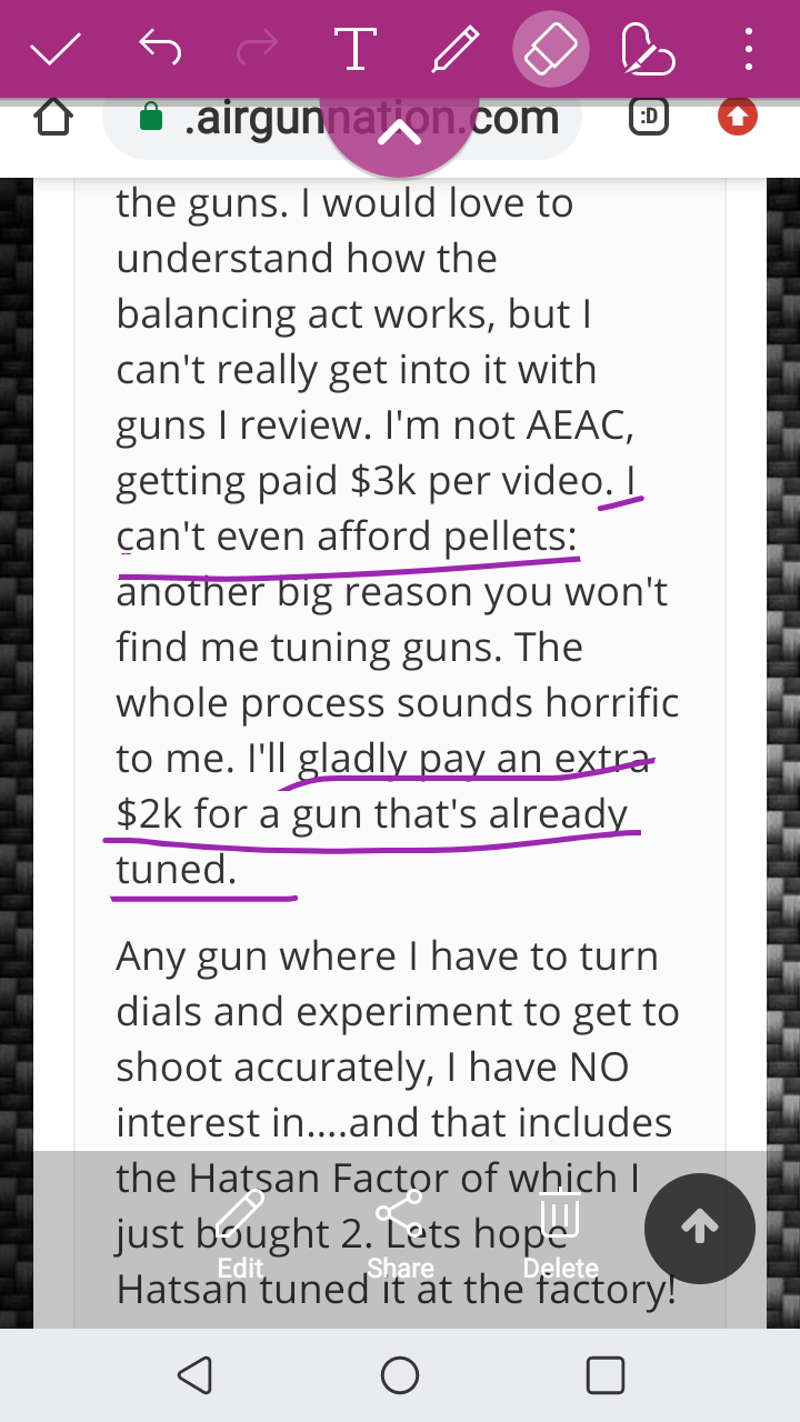

On my channel I test guns "out of the box". I don't have the patience or time to tune the guns. I would love to understand how the balancing act works, but I can't really get into it with guns I review. I'm not AEAC, getting paid $3k per video. I can't even afford pellets: another big reason you won't find me tuning guns. The whole process sounds horrific to me. I'll gladly pay an extra $2k for a gun that's already tuned.
Any gun where I have to turn dials and experiment to get to shoot accurately, I have NO interest in....and that includes the Hatsan Factor of which I just bought 2. Lets hope Hatsan tuned it at the factory!

Thank you! That totally answers my question. I wanted to know if I had to do the "balancing act" thing...I was afraid having 2 adjustment knobs meant that.
