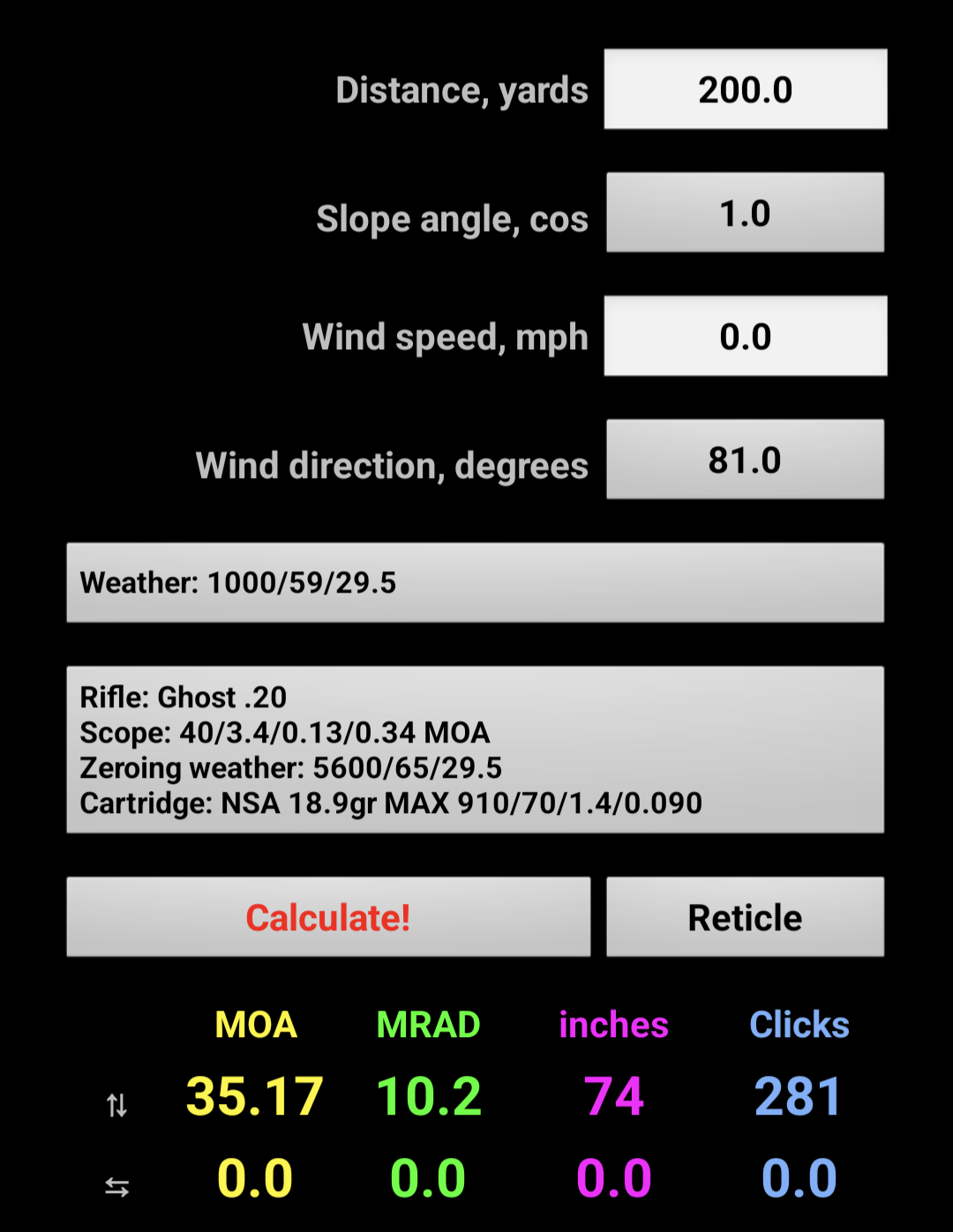

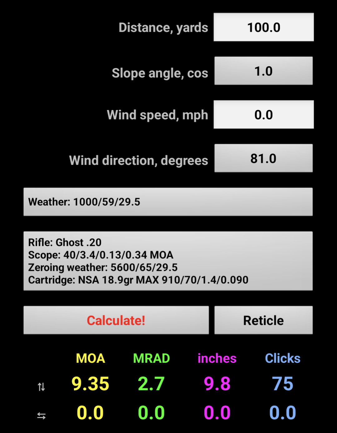

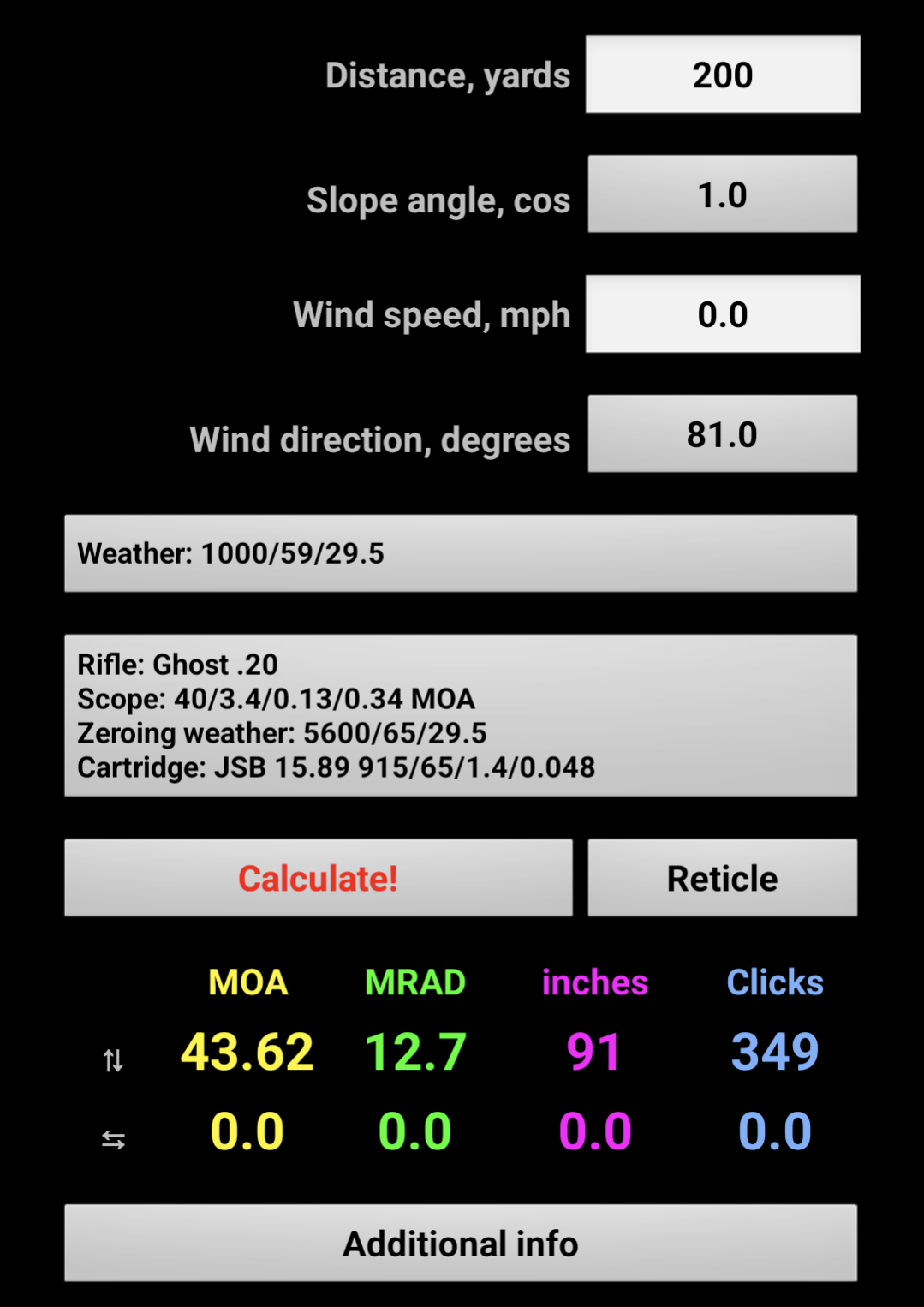

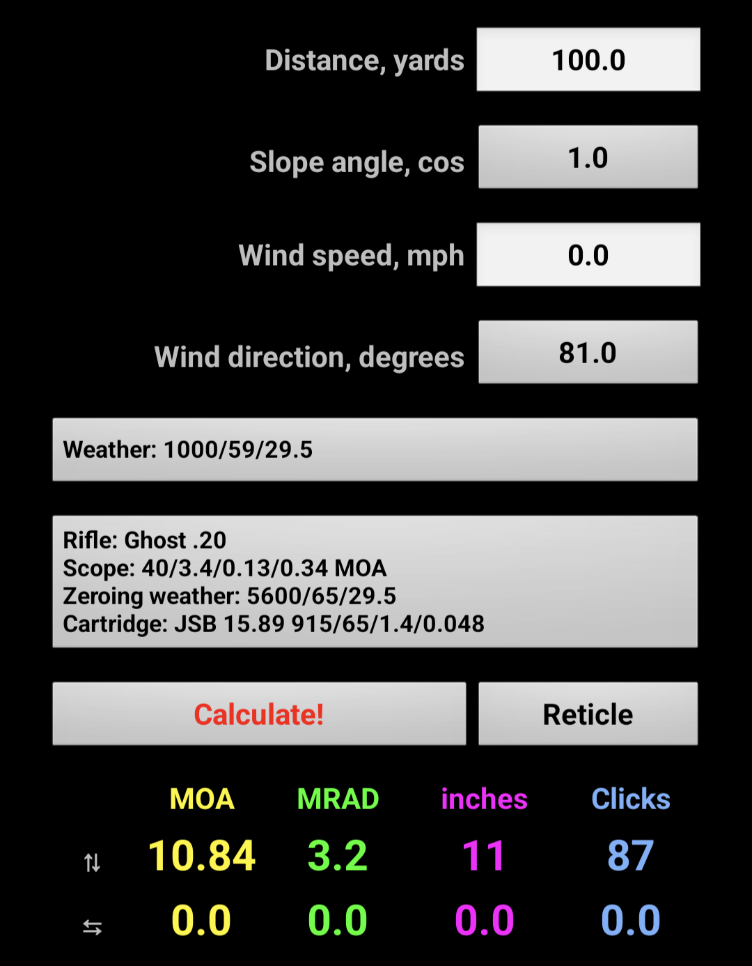

Yes, slightly flatter with the slugs. These are screen grabs from actual setups that I shoot a lot of.
100 yard comparison first...relevant data is bottom right. Projectile data is listed too (JSb 15.89 versus NSA 18.9)
200 yard comparison
In this particular comparison they're going nearly the same speed. This slug has about double the BC of this pellet.
