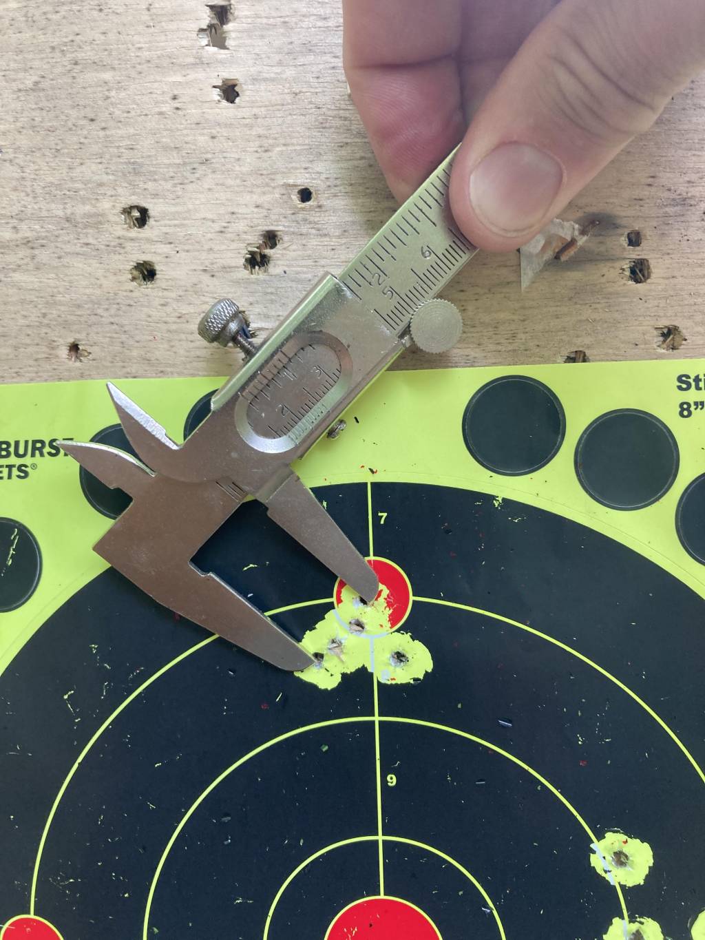

Just I’d post an update. I’m still not excited by the ES I’m getting, but some of the comments reminded me that I have some 24.8 grain NSA slugs. Here is string where I shot the NSAs with at least 10 secs between shots:
Shot count: 10
Low: 895
Hi: 919
Avg: 907
Spread: 24
STD Dev: 7.7
909
916
907
907
898
919
902
905
914
895
BUT.....here’s a group at 100 yards with same settings:
shoot a full tank over the chrony. 5 - 10 shot isnt enough data to be telling
If your spread doesnt get bigger over a full tank, then yer good (above suggestions might still be helpful)
IMO people dont collect enought data from the chrony to be as helpful as that data could be....
What he said, but at the same time people go too crazy with the numbers, a gun with 20FPS ES spread can be very accurate.

I should have mentioned that the NSA slugs are .218, and they seem to shoot more consistently in my Maverick than the JSB KOs. Of course, now NSA is out of the 24.8 gr slugs! I ordered a couple packs of the 27.5 grain .218 slugs to try.
I'm definitely going to work on getting closer to the velocity plateau. There seems to be a consensus that really close--like with 10 fps--of the plateau may be best for the AMP regs and consistent velocities. It is a little hard to get that close when the velocity varies. I guess people just crank out on their HS in tiny increments (which increases velocity on Mav) until they get the tightest spread and best harmonics (checked with groups)?
I would honestly just let the targets tell you if the gun is right or not. I never stress over the ES much at all. I mean, sure I care if it's jumping all over the place, but 20 fps would rarely worry me. If the gun is grouping well and the POI is always consistent, then that ES don't mean much :D There isn't a full consensus on that plateau tuning. I run my Maverick with the power wheel on 6 a large majority of the time. As I mentioned before, that usually means 25-35 fps below the plateau with my settings. Actually, I will run it on 1 for house duty with lighter weight slugs, and it is still one ragged hole at 40 yards. What good is a power wheel, if we don't get to use it ;) I'm going a little against the common grain here, but I have no interest whatsoever in seeing how low I can set my reg and get the speed I want. I prefer the gun shooting further below the plateau than close to it. It is quieter, and usually more efficient that way. It also gives a little headroom, when switching to heavier ammo. I usually tune my gun to where it is a solid 10-15 fps below the plateau at 7, but I try and tune it where the speed I want happens at 6. That's just my personal preference though.
