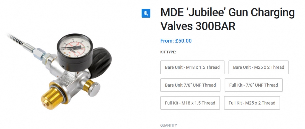

Makes sense then, not seen them used widely here, I would only ever use the BEST FITTINGS dedicated airgun valve, BF import most of the above cylinders so fit their own valves. I have bought a lot of cylinders direct from ACECARE but always bare and fit the BF valve myself.
Does the DIN fitting I presume being used for SCUBA require a different testing period?
BEST FITTINGS UNIT!
The above valve is a DIN 300 valve. The interface between the hose fitting and the valve is G 5/8 or 5/8 BSPP which is also known as DIN. Here in Australia, it is pretty much the standard for all high-pressure breathing systems, scuba or scba when pressures are higher than 200 BAR. lower pressure scuba normally uses the yoke type connections. As far as I know, CGA 347 and 346 is what you are referring to as scba is only used in the USA. As for different valve inspection intervals, I'm not aware that there is a requirement for periodic inspections on valves but I'm sure that they get looked at when the tanks are hydro. tested and if unserviceable won't be reused. It's your prerogative to get your gear from where ever you want but you will save yourself a lot of money if you do a little research before handing over your hard-earned on a one-stop-shop for all things air. There is nothing wrong with the Chinese stuff if you do your homework and I wouldn't be surprised if a lot of best fittings stuff is coming from there anyway.
