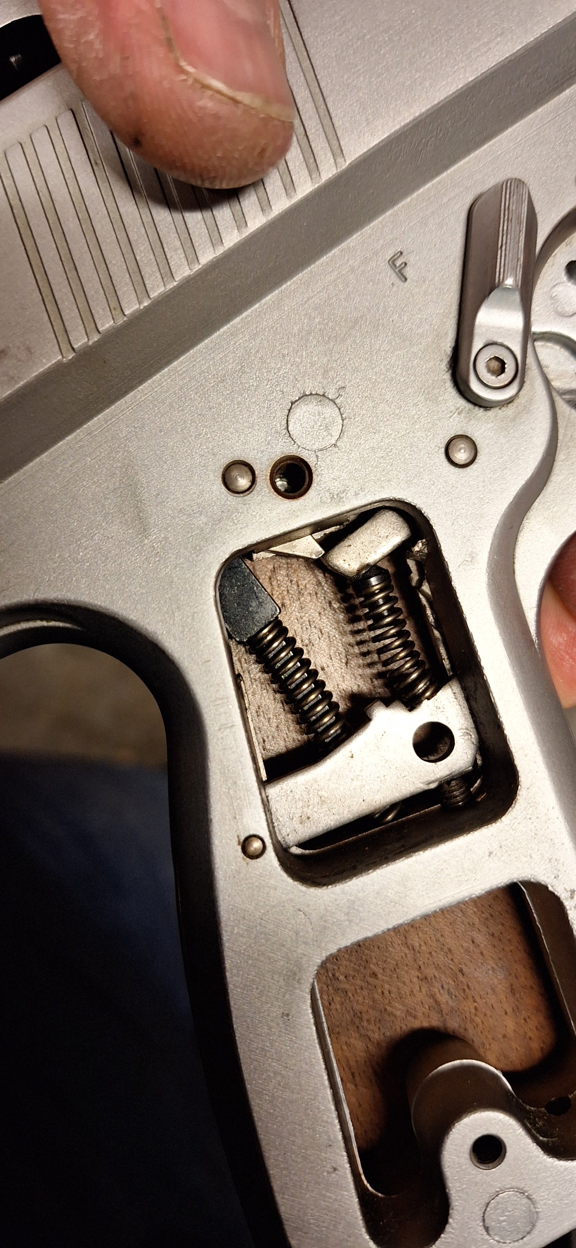

I bought a pretty good P 1 from AOA. I opened the top to look her over and spied a small spring lying between the compression tube and the frame. It was lying there loose and no indication from whence it came. The rear sight looks like it could be for upward pressure but it works fine. Up- down, side to side there is pressure. It is smaller diameter than an ink pen spring and about one third the length. All seems to be in order and shoots nice. Cocking is smooth with both settings being obvious. Safety works. ? ¿ ? Perhaps someone was working on it and lost the spring when it launched. Or the original owner wanted me to have a spare? Any Ideas from guys that have repaired a P 1? Be Well Brothers, B.

i thing you might find is the spring is not from the pistol
take a grip panel off there should be 2 spring visible

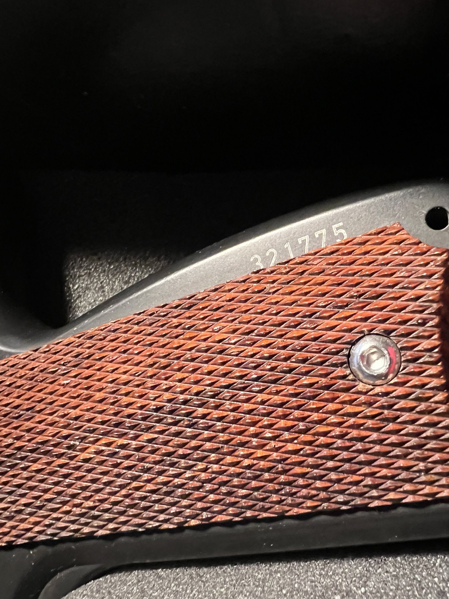

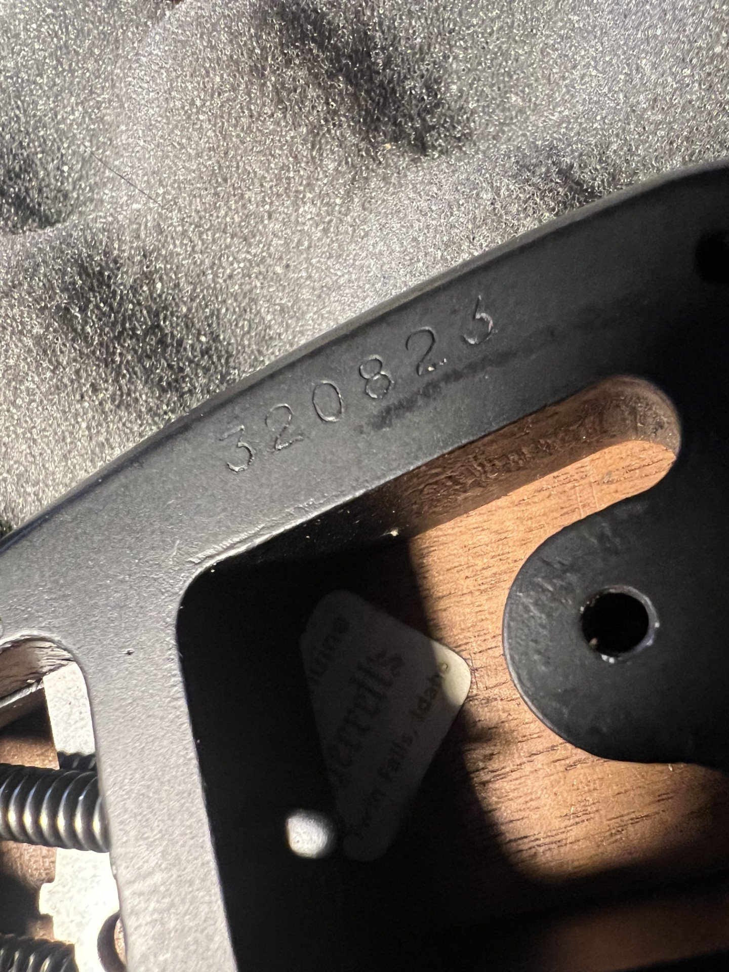

Another question on the same pistol. How to narrow down dates? Right now I see no indicators of a serial number. On the side: Beeman Precision Arms, Inc.
San Rafael Calif. 94903 U. S. A.
Made In West Germany
Other side: Beeman P 1, then the caliber and depiction of the recommended styles of pellet X 2. And Cal. 177”/4.5mm in the upper front left
Anyone able to narrow the period of production other than the San Rafael and West Germany? Thanks for your time and knowledge guys. It is hard earned in some cases. Bandito.
Sounds like this is the spring you are referring to:
It is located in the center of this pic:
