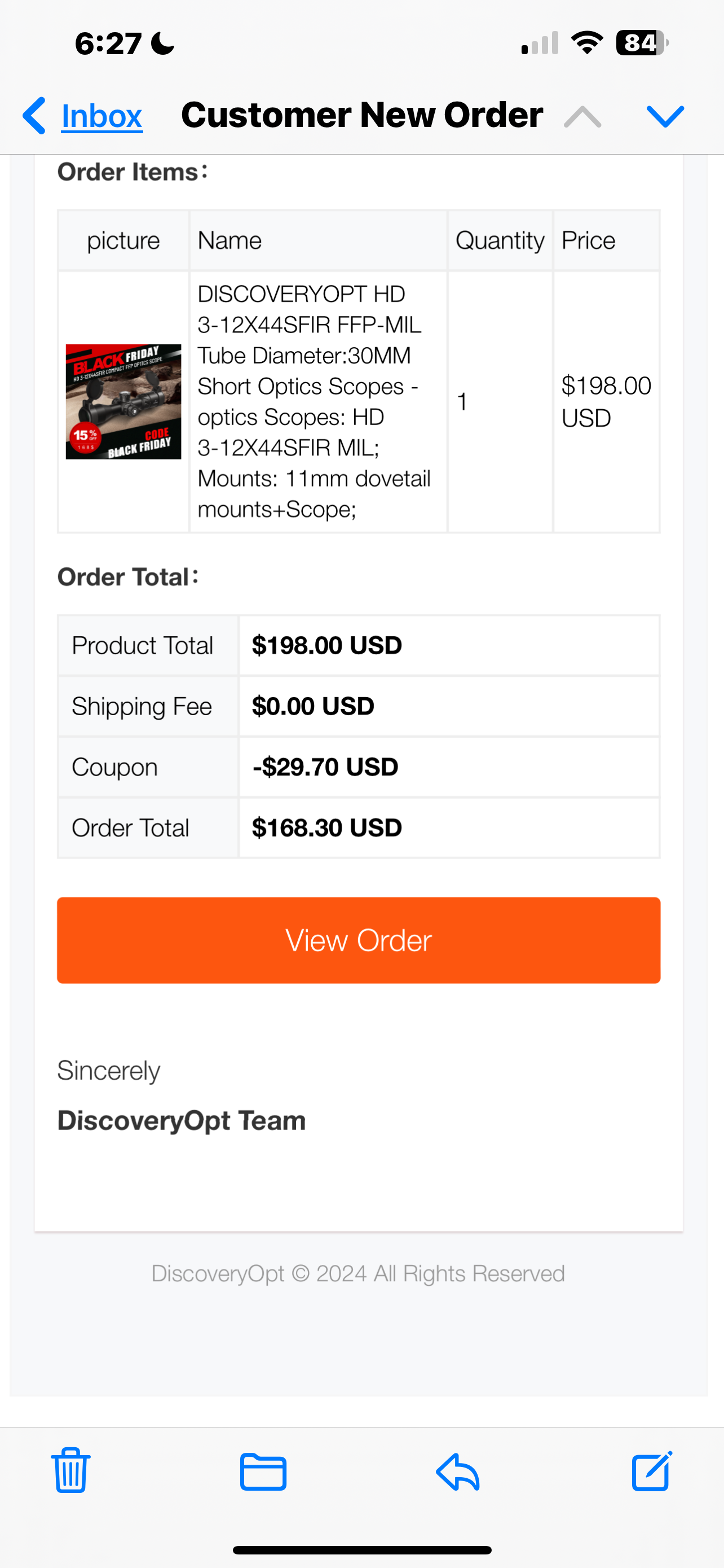

Just recently picked up this Discovery Optics HD 2-12x24 FFP scope that focuses down to 5yds, pretty good glass too with an illuminated reticle only 16oz...165 TYD thru DiscoveryOpt.us. I myself prefer FFP too as it allows for magnification changes on the fly in the field without changing POI. Have it on my Notos.
