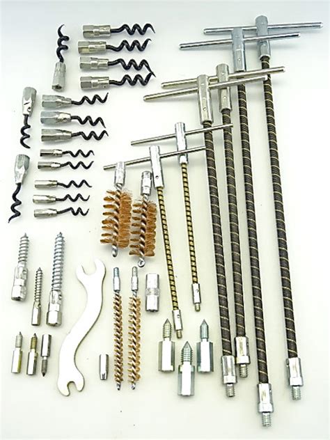

I made a puller out of hi tencil wire and made a packing puller type thing with a cork screw end to dig in and pull ..
My patch was deeper in maybe perfect 1/2 way ( my luck). Pushing it was no option and mad it stuck tighter..lol then .177 too boot so not much room to work..
Anyway heres a look at packing pullers and the tips for ideas to make somthing if needed.
That is brilliant! I was actually trying to picture something just like this. The patch is so close to the muzzle that these would work perfectly. Are these the pullers that you created? I don’t know how I would make these but would love to buy something like those
No thems store bought for example to make one up. I had a hi tensile strength thin rod near wire size ( all most wire coat hanger thickness ). And made the needle point on one end and a cork screw like hook on the other ( not easy to bend with out heating it up.
The sharp end made like a pilot hole best i could and then screwed in the cork svrew end best i could if it felt i got a good hold id pull. At first i get bits at a time then finally got a good hold and it pulled out. Whew! I was glad too.

Thing is the store bought stuff like that puller , will it fit in the barrel? .22 and up maybe a good chance you find somthing to get down inside . Like me as i said im not going to be lucke enough to have it at the ends its going to be stuck smack in the middle..lol. Thats why with that .177 it was make my own thing.. seems anything under .22 is non-existent.
Ya, that stuck patch a s a thing and hope never happens again. But if so im a bit smarter and prepared now. You know that experience thing .😜
