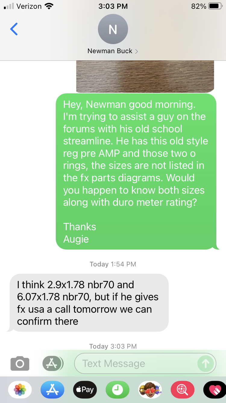

Does anyone know the size of the O-rings on the brass part of the pressure regulator?
@Bigragu in the original post it reads "FX parts list the pressure regulator as one part number." The O-rings are NOT listed individually. I sent FX an email on Sunday and apparently they were closed on Monday, July 3. RBR is always a good policy...
