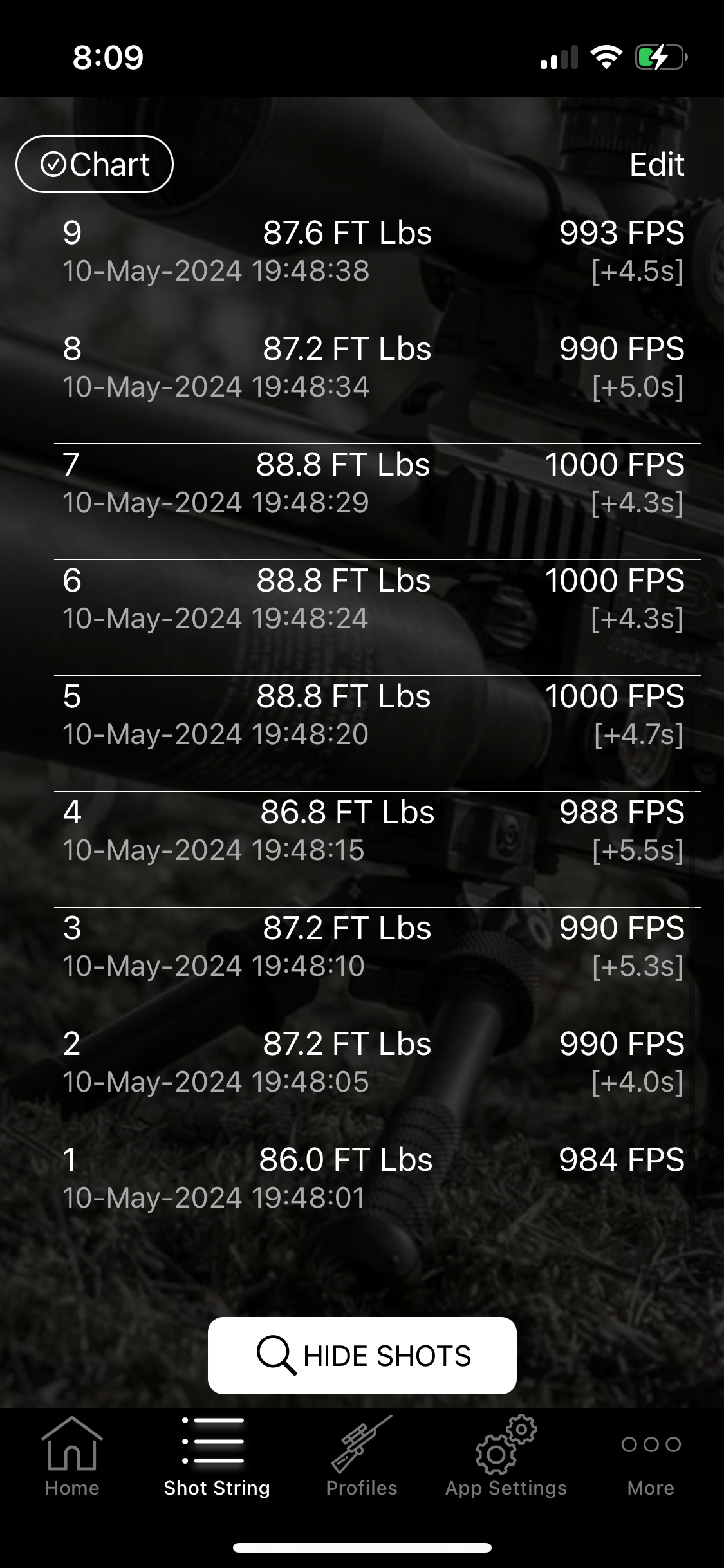

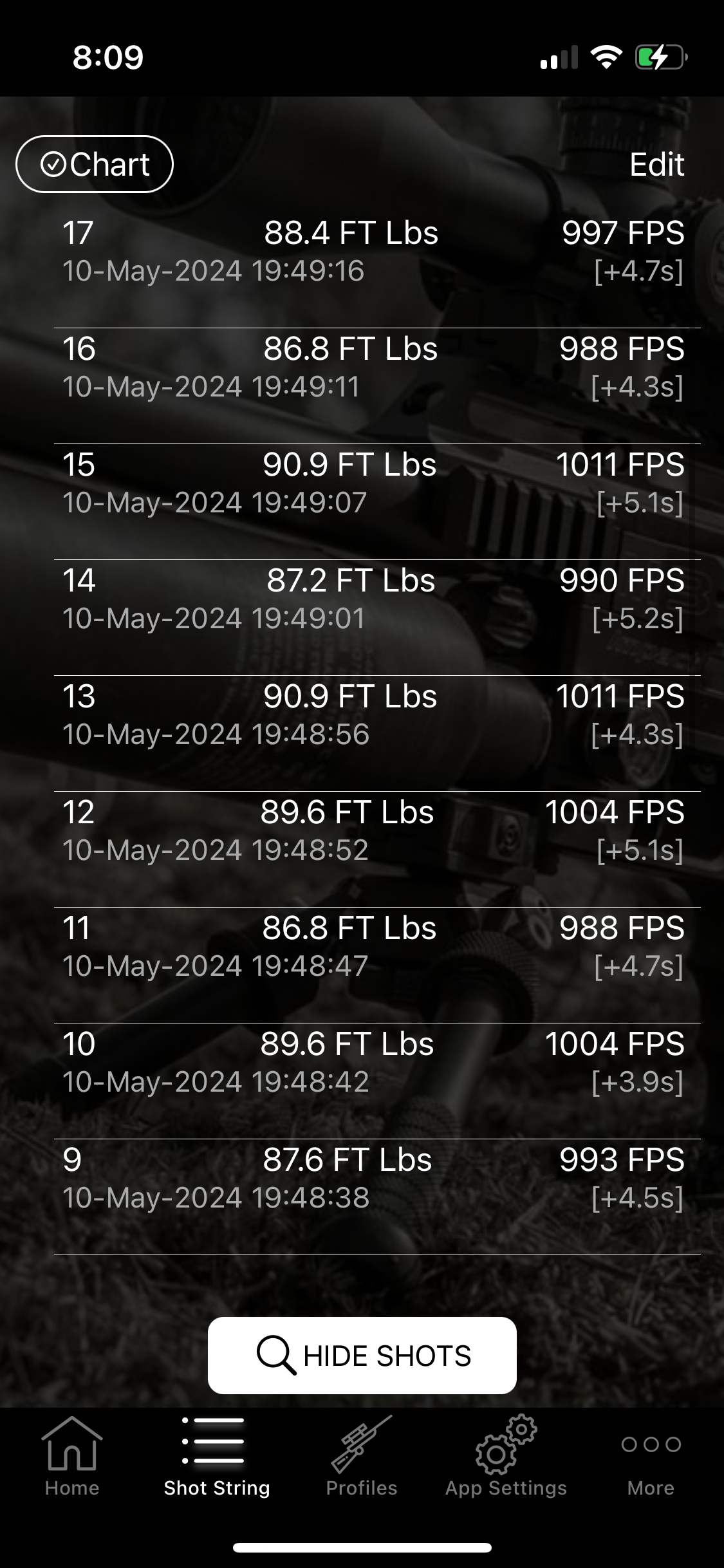

Somewhat struggling getting the SD/ES to tighten up. Info below. My pellet M3 is in the single digits but this one is hovering a bit.
Impact M3 .25 700MM
Slug Liner/Tungsten Hammer
Reg 1: 190
Reg 2: 155
Macro: 15
Micro: 4
Max speed is about 1035 fps or so. I know people say to be 3-5% lower than max. I could cut a touch more speed to get it in the 980’s?
