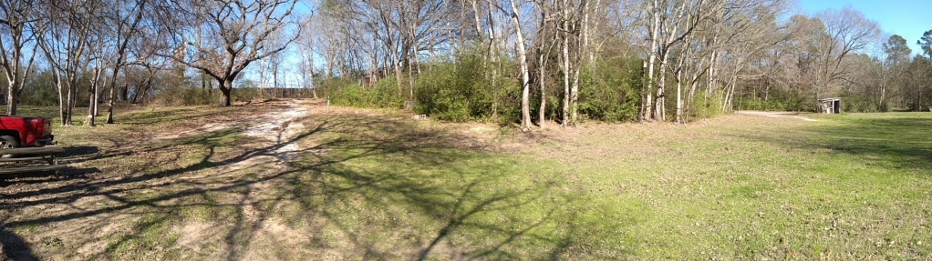

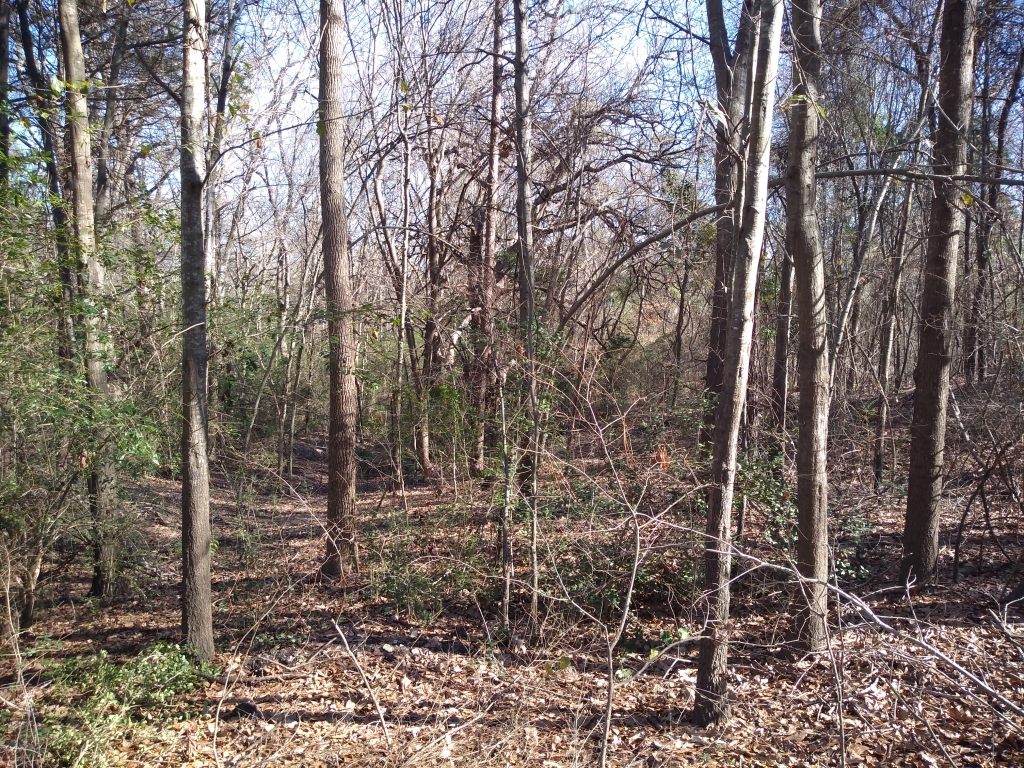

We are located in Tyler TX and have a 100 yard range, next to that we have a road/path running up hill that is another estimated 200 yards that will allow shooting lanes to be cut into the wooded area that would place the lanes parallel to the range. FT shooters will be shooting into a natural area with woods and stuff allowing for some added difficulty including actual off limb and tree shots. I can easily see 15 to 20 lanes being cut into this area without being to close to each other, Further the lanes would be angled so that the shots would in no way cross over the range itself. We are planning our event for April the 4th but that is still open because we are still in the building phase and I still have to get all the lanes cut out. At this time I am the only one doing this

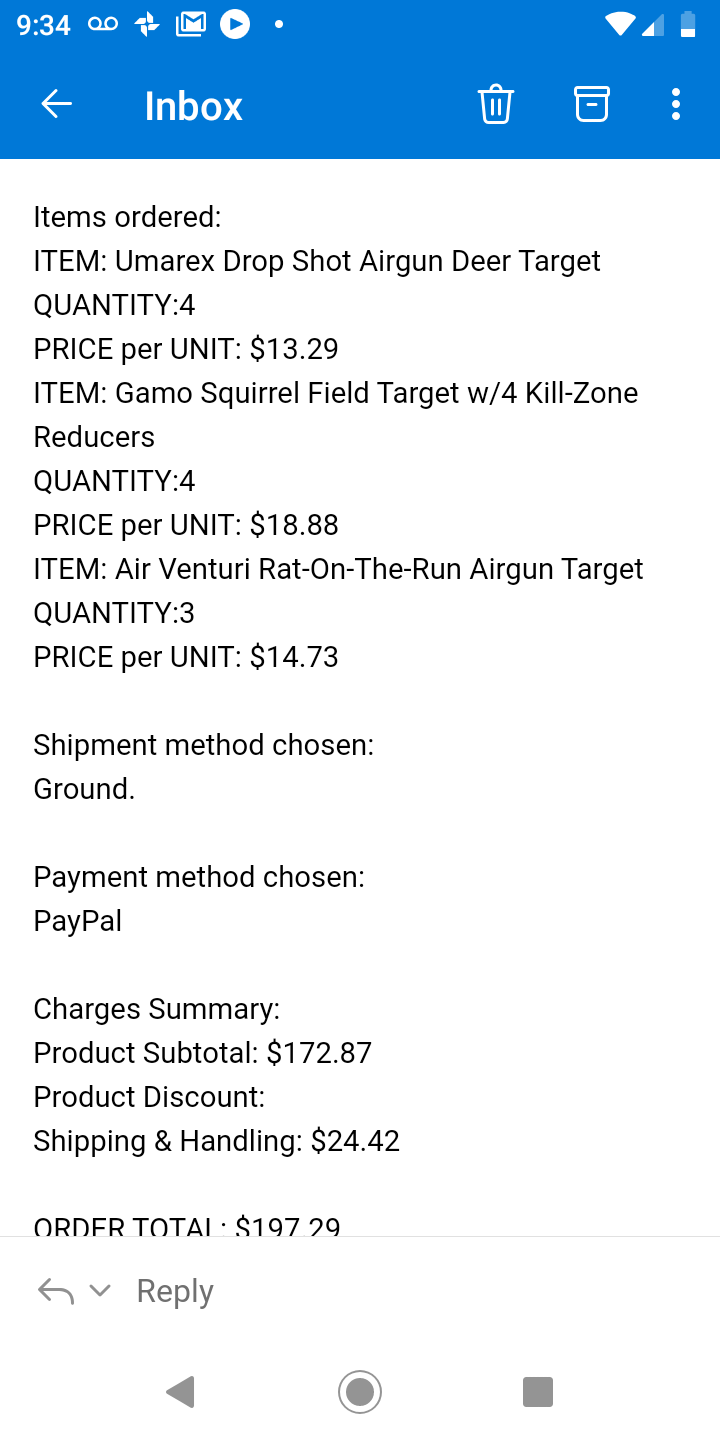

I went through the same thing as far as targets. I considered making some for our FT range, but since we had lots of other work to do and not enough bodies, I bought targets. Cheapest I could get at the time (Gamo) and am still using them seven years later.
Air Venturi, Crosman, and Umarex field targets are $20 ($17 if you wait for a sale and free shipping). And they include strings. It's hard to match that price, even building targets yourself.

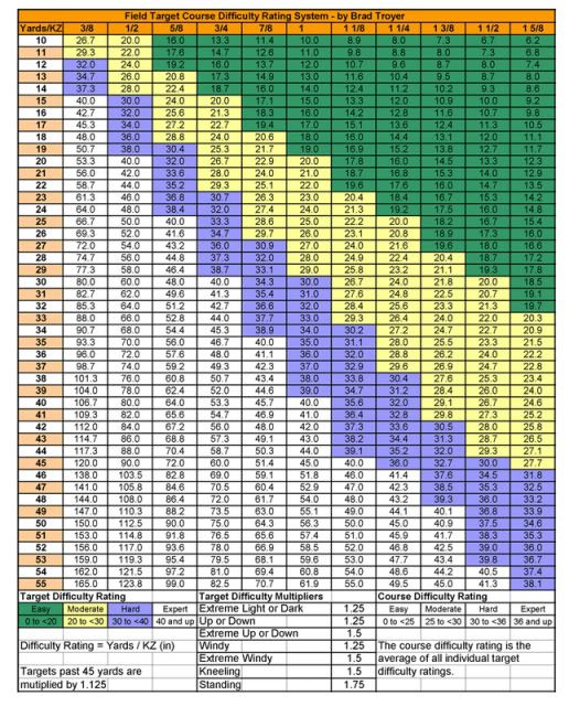

KZ size relative to distance (how far out the target is placed) is much more important than location on the faceplate. That chart that 18.13 provided is quite useful. Our clubs average Troyer factor for a monthly match is typically around 30. We occasionally have someone shoot a perfect score, but not often. Our club has a handful of Nationals champs too, so some really good shooters.

Of the budget FT targets available out there, the "rat on the run" target are best IMO. Maybe slightly limited in kill zone sizes, but the hardware is better and they work well. Check them out on Amazon- you can sometimes buy them used on Amazon for $16 (as I type this). Only difference I've seen from new to used ones is sometimes the box is a little torn- target has always been fine. I have a video that reviews some of the FT targets available out there.

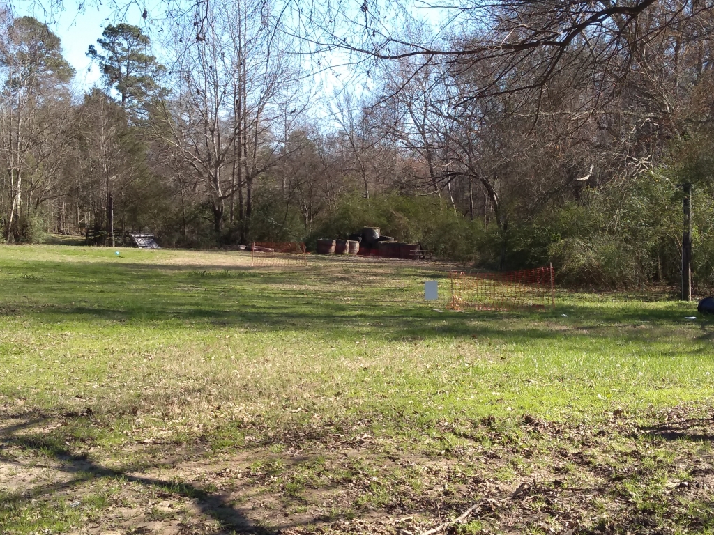

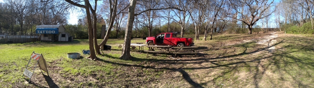

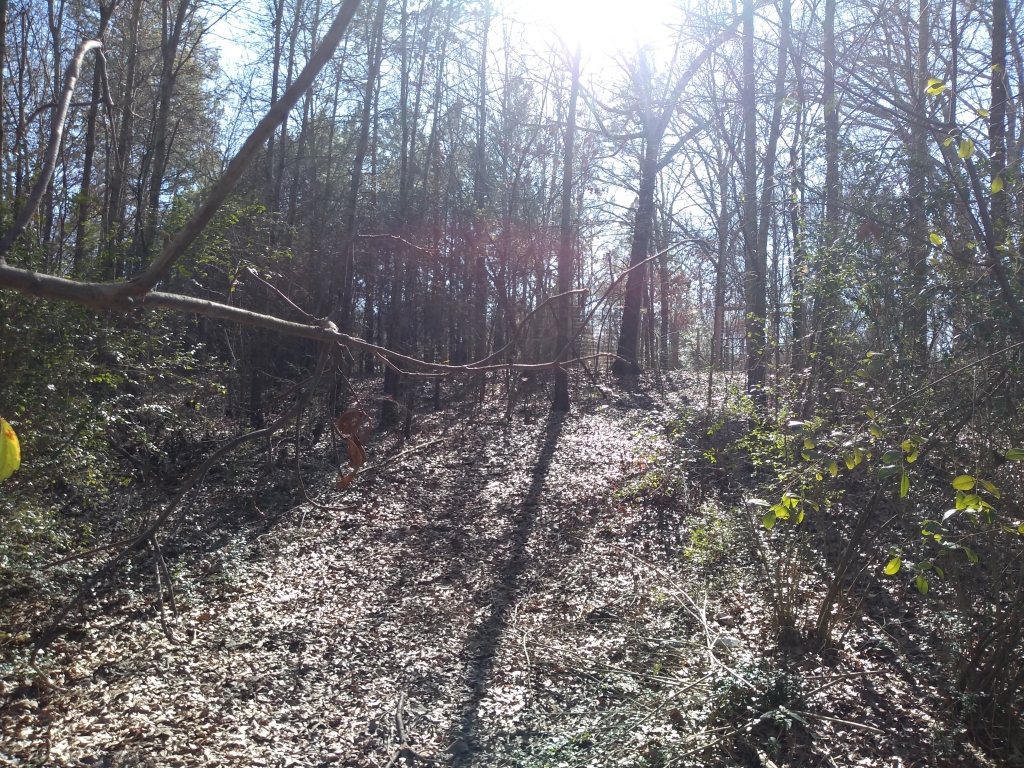

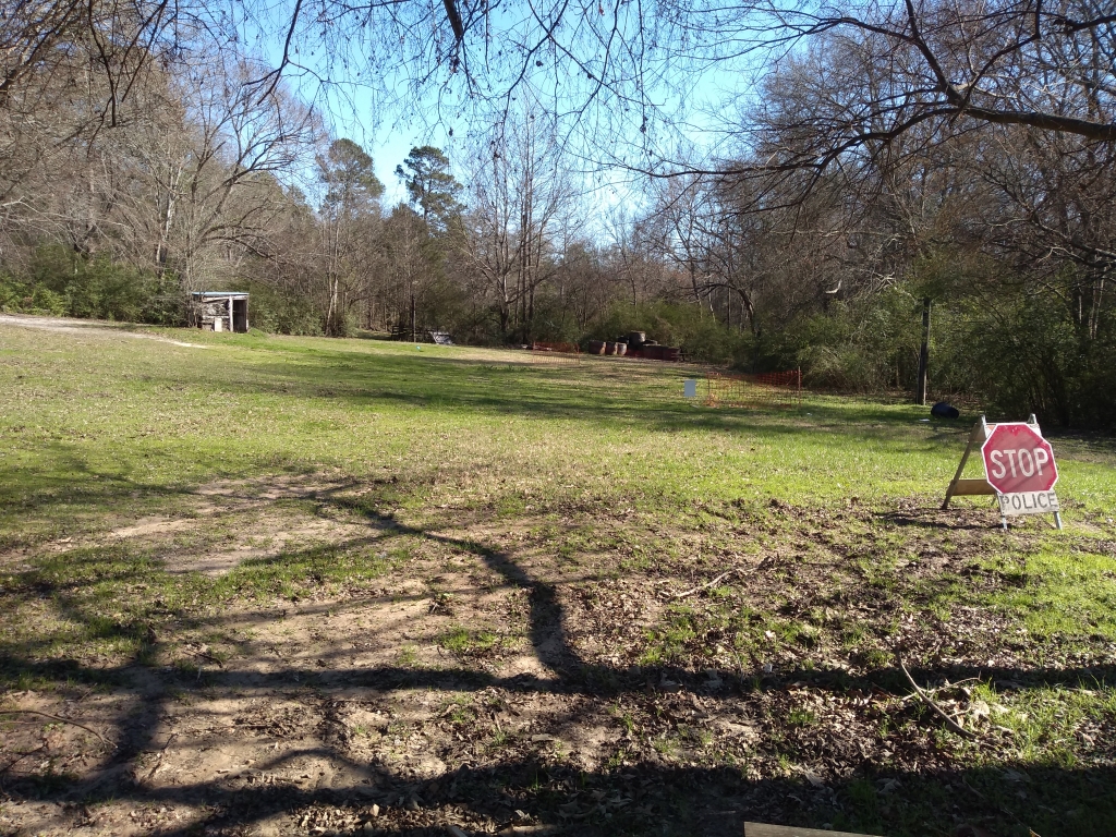

We just got a huge amount of area cleared
For those that go to the Arlington FT and thought that Jeff could be evil when he puts targets out
👹👹👹👹👹👹👹 You ain't seen nothing yet
We now have land cleared butting up to a dry creek bed that is cut down 10 - 15 feet in some places . So we will have plenty of room for down angle shots, past the creek the ground elevates higher than the shooter.
There is some spots with rolling hills that is going to really mess with your yardage estimations
Oh this is going to be a lot of fun
