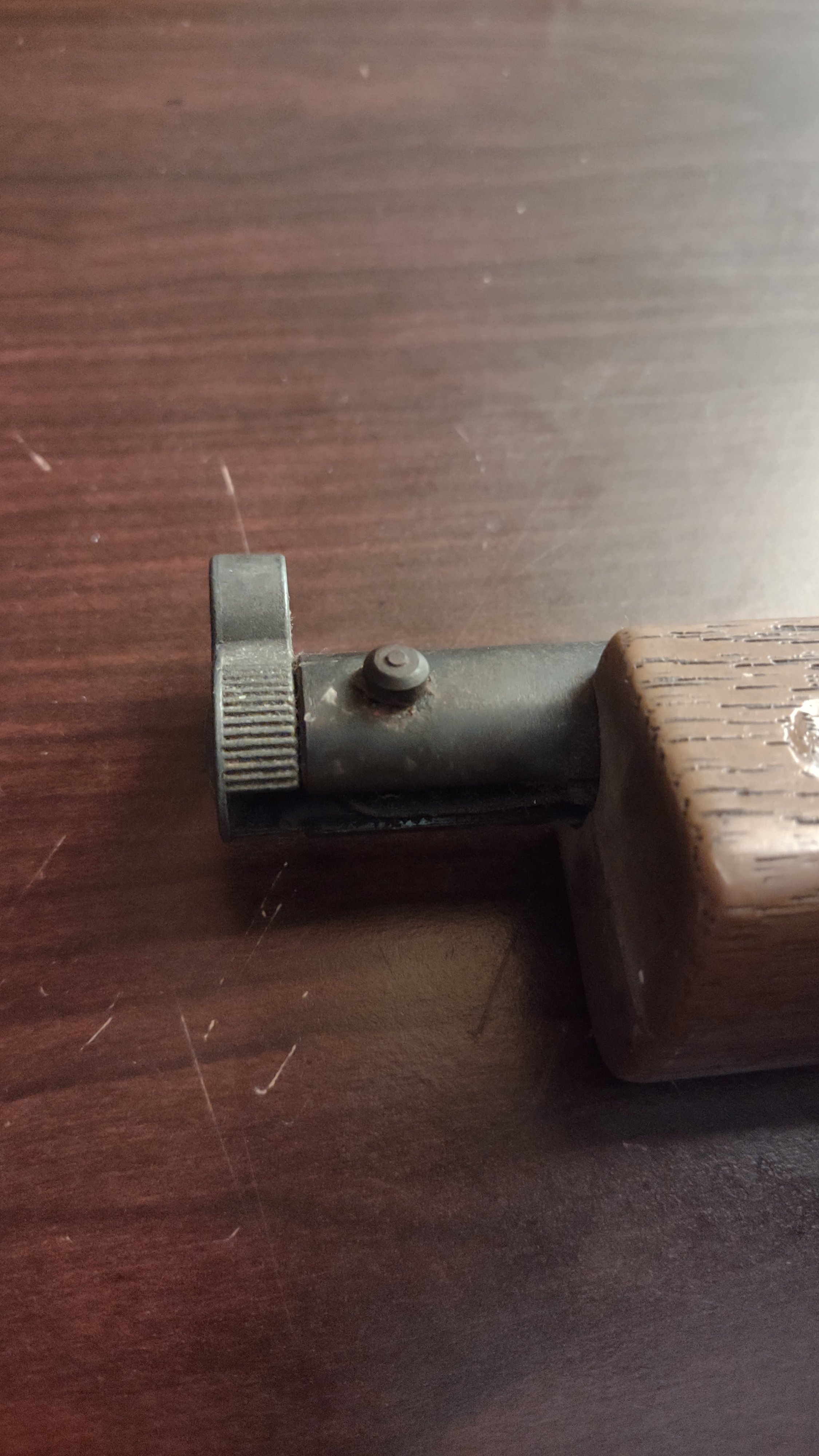

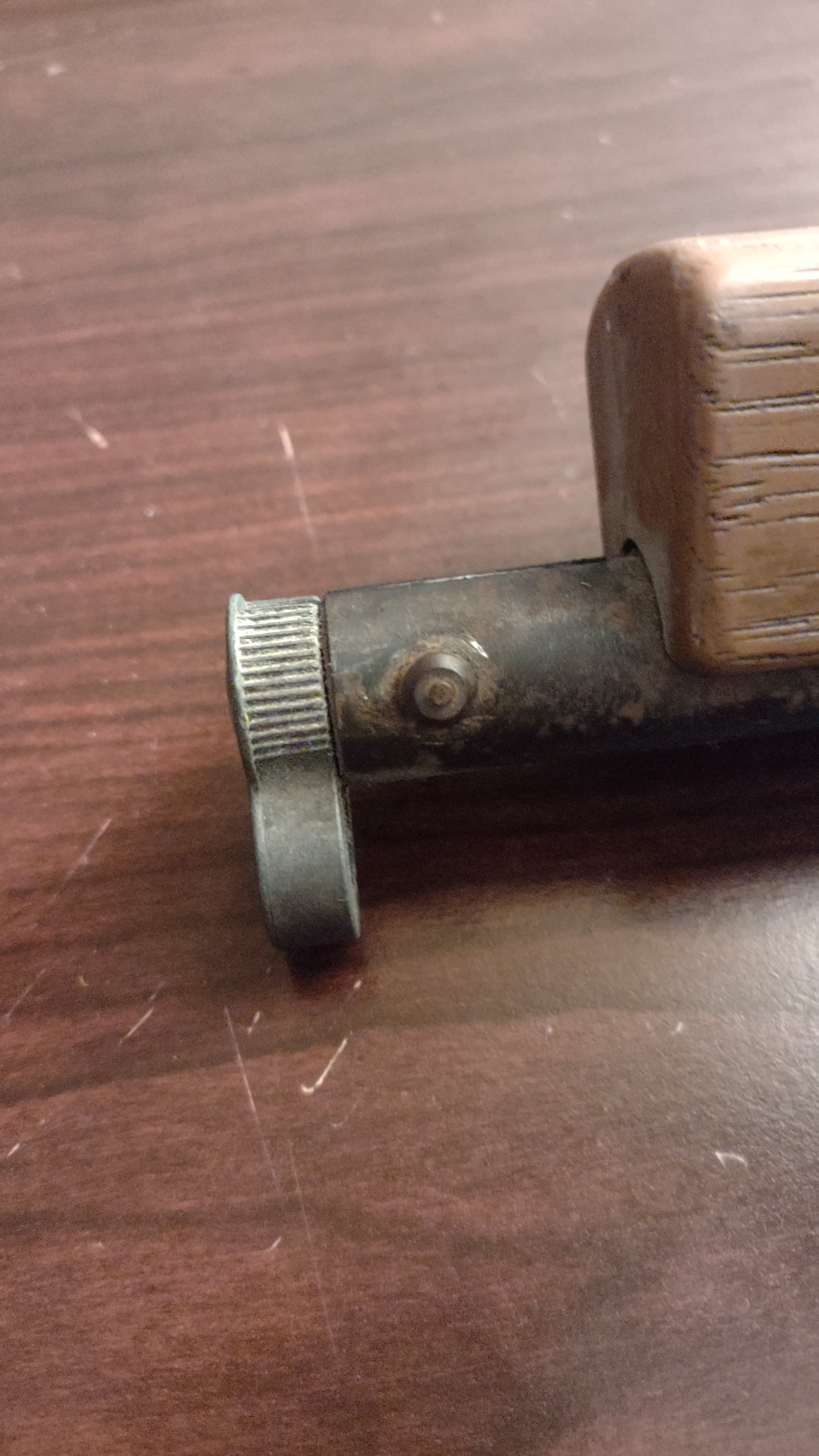

I am going through my pumpmaster 760 and I have run into a problem... I can't figure out how to get the pump pin out. How do I take out this style of pump pin? And what's the best seal kit I can get for my air rifle? Should I replace the valves and where should I buy them? Any help is greatly appreciated! Thank you for your time reading this.

They threw me as well. A set of wirecutters works well to gently pry those off. Do one side first, then push on the pin that goes all the way through.

That's what I ended up doing after I read jimbentley's comment:
That is cap over the roll pin. It should just pop off.
Thank you both for the help
