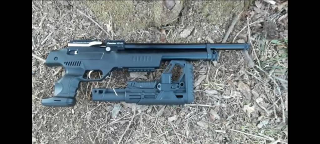

Kral NP03 in .22 or .25 can be set up at 25 shots at 30fpe in 22 or 40fpe in 25. Less than 6 lbs with air and lead. A small optic for 30 yard shooting or less wouldn't add much weight. 16" barrel and less than 2 minutes adding and removing the stock. Comes with threaded adapter to add a quiet device so the deer don't spook.

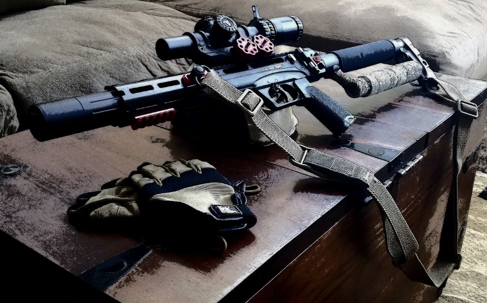

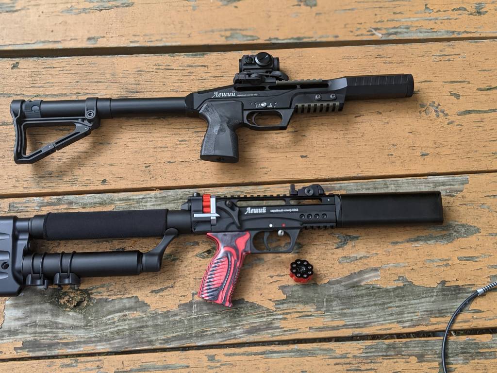

I 2nd the leshiy classic. I have a .22 and .25i n the 250mm barrel configuration. The .25 tuned to about 30-32fpe is very quiet and would do the job in your circumstances. It's my favorite pack gun by far. That's my uncle's L2 and it's much louder and a little heavier than the classic. He still eyeballs mine and I can tell he's pissed he paid more 😁

I am now toying with the idea of a leshiy classic in .25. I like the leshiy 2 but at such a higher price, more weight and actually a tad bit louder not sure it’s worth it for me in what I would be gaining over the classic.

if you don't mind spending the money, you can make the leshiy 2 considerably less noisy, but i think the leshiy 2 action is the limiting factor on quietness
if double-taps aren't a requirement, or arcade style shooting isn't appealing, the classic might work fine for much less.
being able to pop off 8 shots as fast as you can pull the trigger (<2 seconds for me) is what you get for that weight and sound penalty.
i was able to knock off 15db from the stock shroud on the leshiy 2 long by adding a MOD50, but that again adds to the price and length =/
on the plus side, am able to knock off 5db without making it any longer by only using a couple of sections of the mod50.

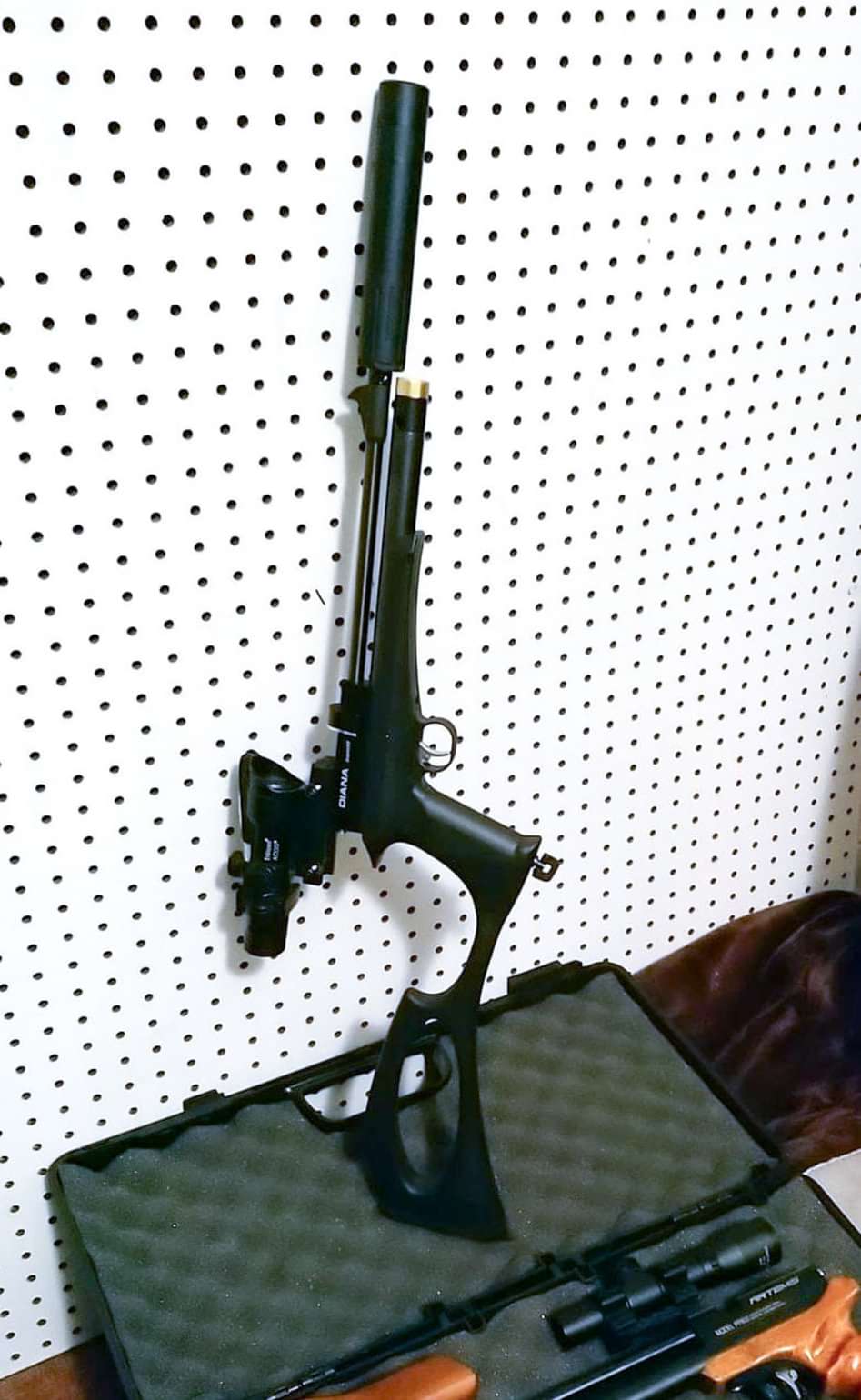

My backpack gun is a PP700 177 with a red dot weighting in at just over 2lbs(pistol form) with 3d printed moderator. Looked into everything else and everything else not only cost a boat load more but also more than twice as heavy. If needed I can even add a small scope and still be about 2.5lbs suppressed in carbine form with a 20 pellets in a pellet pen. I've rode my mountain bike 20 miles up and down the trails with it and didn't feel like I'm carrying a brick, hardly noticed it in fact. It's deadly out to 25 yards or 40 yards with the little scope I have for it, plus it's super sturdy with zero POI change being in my backpack.
