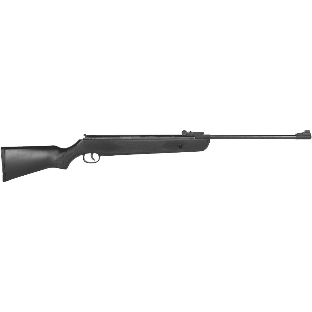

I love this air gun. My plastic dial sight on the right side of the gun got tweaked won't turn anymore. I believe it's called an iron sight? on a break barrel gun. Not sure being a newbie here . How to fix, replace, or upgrade to a better sight? I'm getting mixed results searching online just want to fix my gun with the proper sights to fit it.
I would try Daisy. I'm pretty sure a Xisico sight will also work.
Contact Mike Melnick
Yeah I have that gun but my Fiber Optic Front/Micro-Adjustable Fiber Optic Rear sights are broken. There's not any replacement sights on the website the gun is discontinued.

Well if you need to cross fit or try a fits other models there's 2 things you may best know first off.
Your barrel diameter in mm. So a slip on type fits that snug
Then is the barrel cut with a dovetail or flat spot or whatever as a centering index .
Then don't even bother looking in the USA cause there not telling you a thing on fit or size nothing no real details .. may fit other. .lol.
Then today finding anything in stock / sold out ..
P.s
I thought that gun was a hatsan built gun? Maybe cross fit to something from them?
