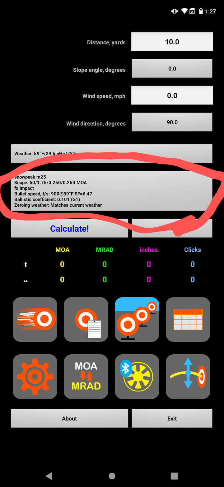

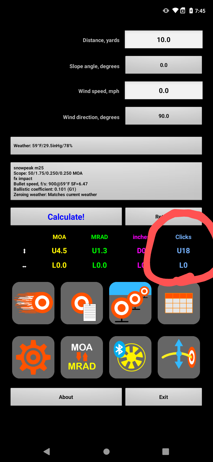

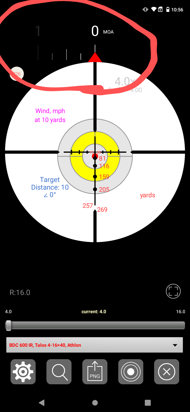

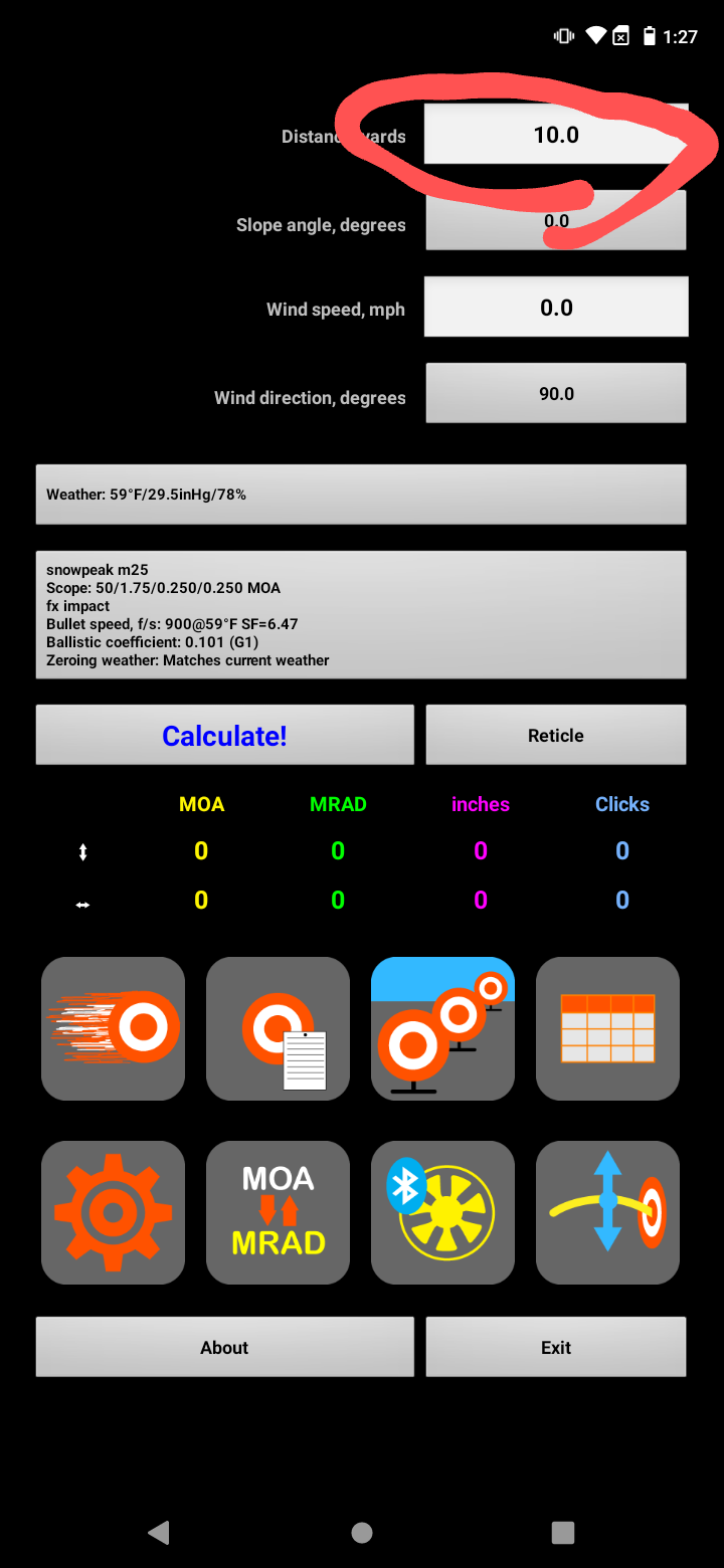

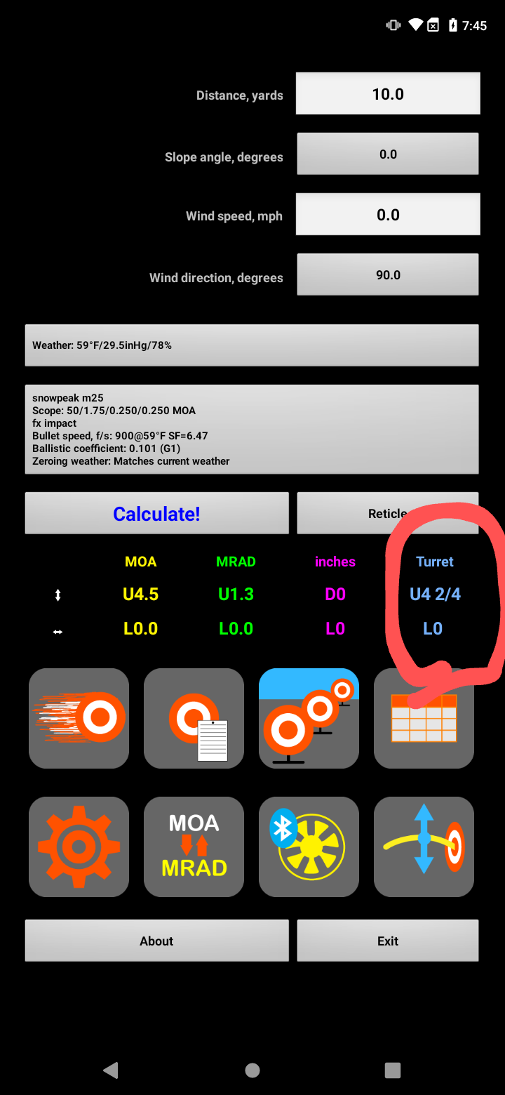

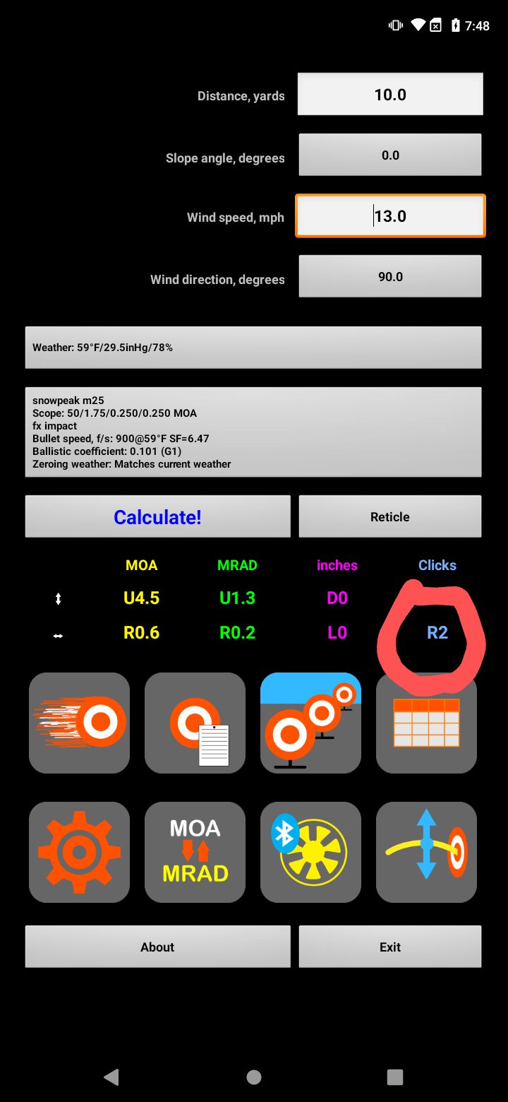

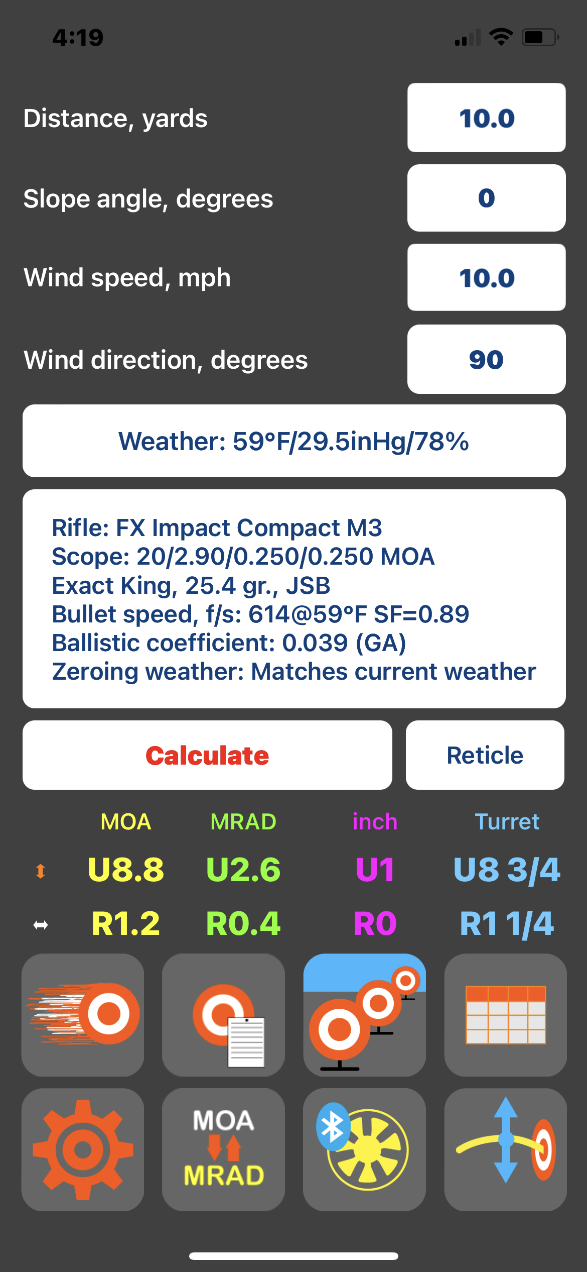

Very top. Its a whele slide for elevation. Windage is on main page where it says wind speed. Have to hit calculate. Numbers will be in color. Graph is in red circle

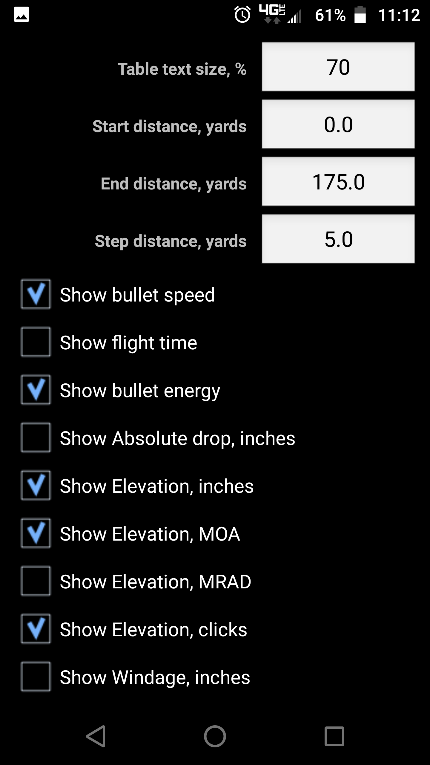

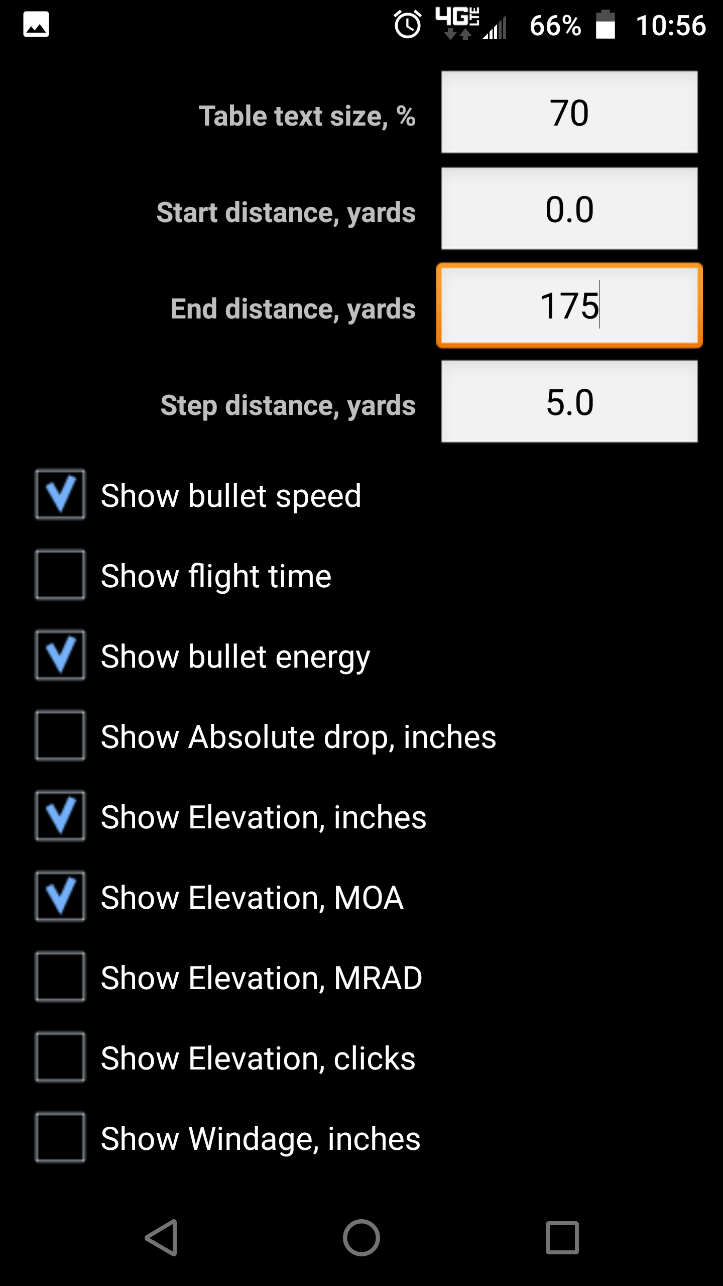

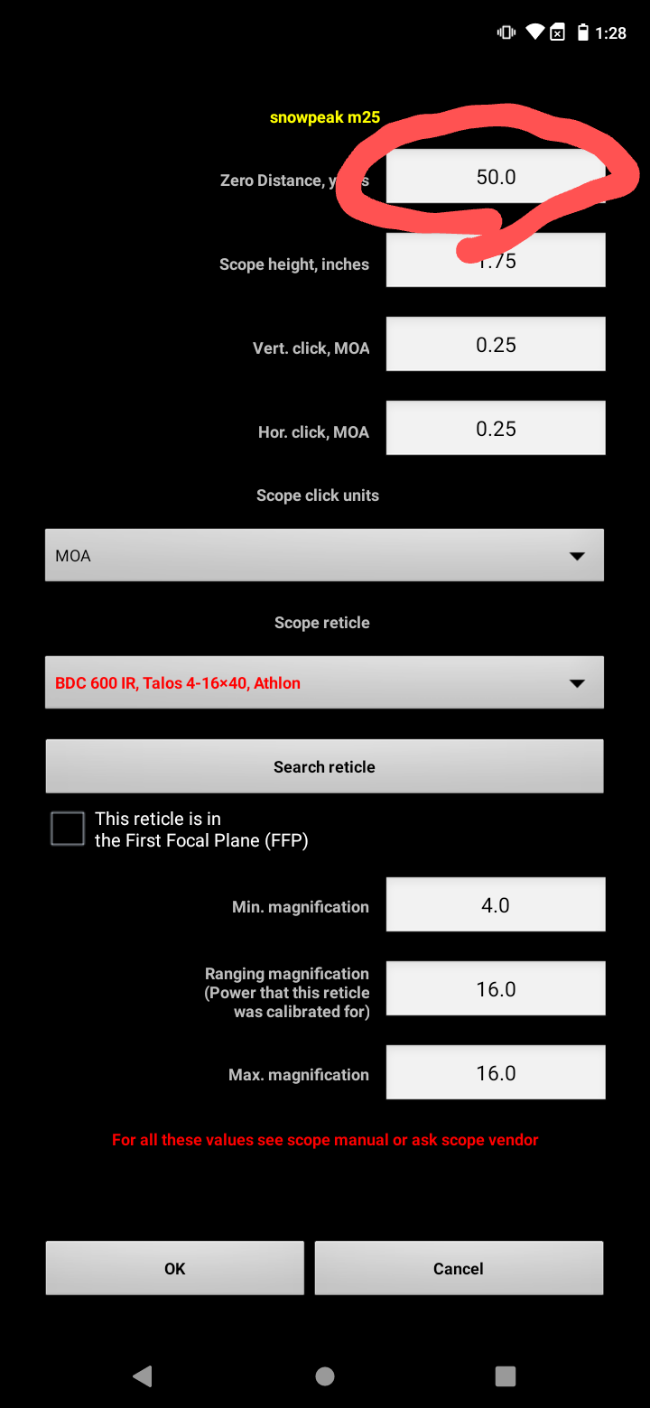

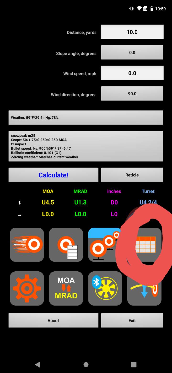

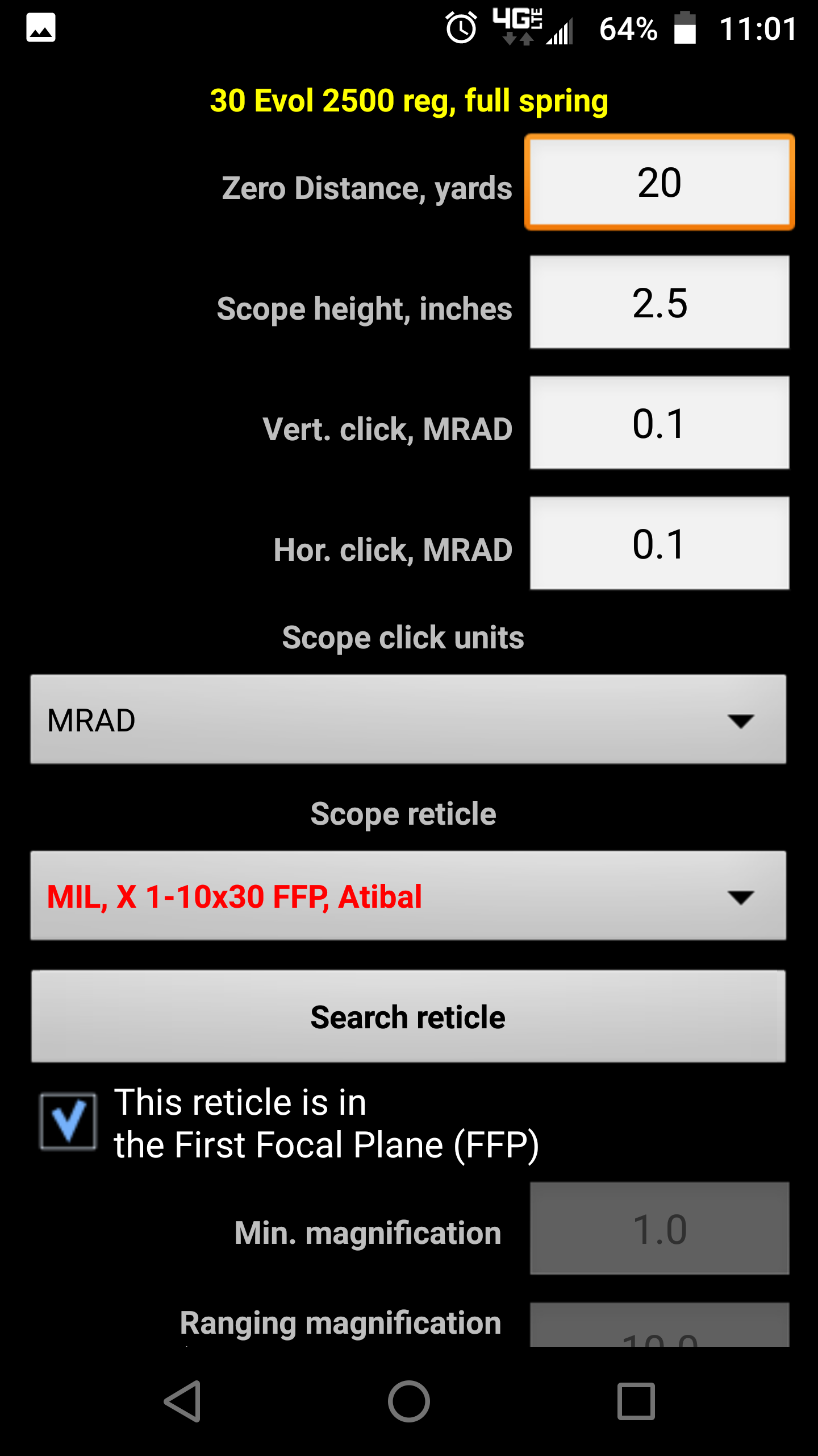

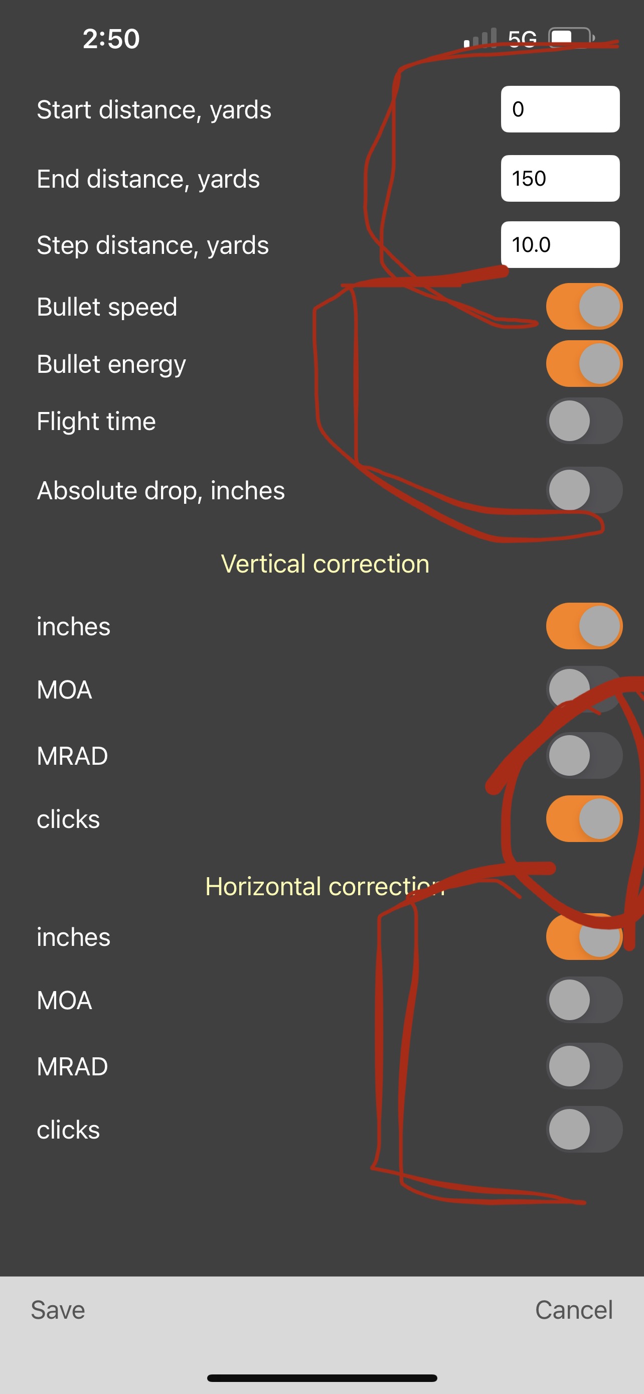

When you open the app with the gun, it will give icons on the bottom. On the right side there's an icon that resembles a calendar. Click on that. The settings icon for that is the lower left, shaped like a gear. Click on that and adjust your setting similar to this. Poke on the "Show elevation, clicks" box to populate that column also.

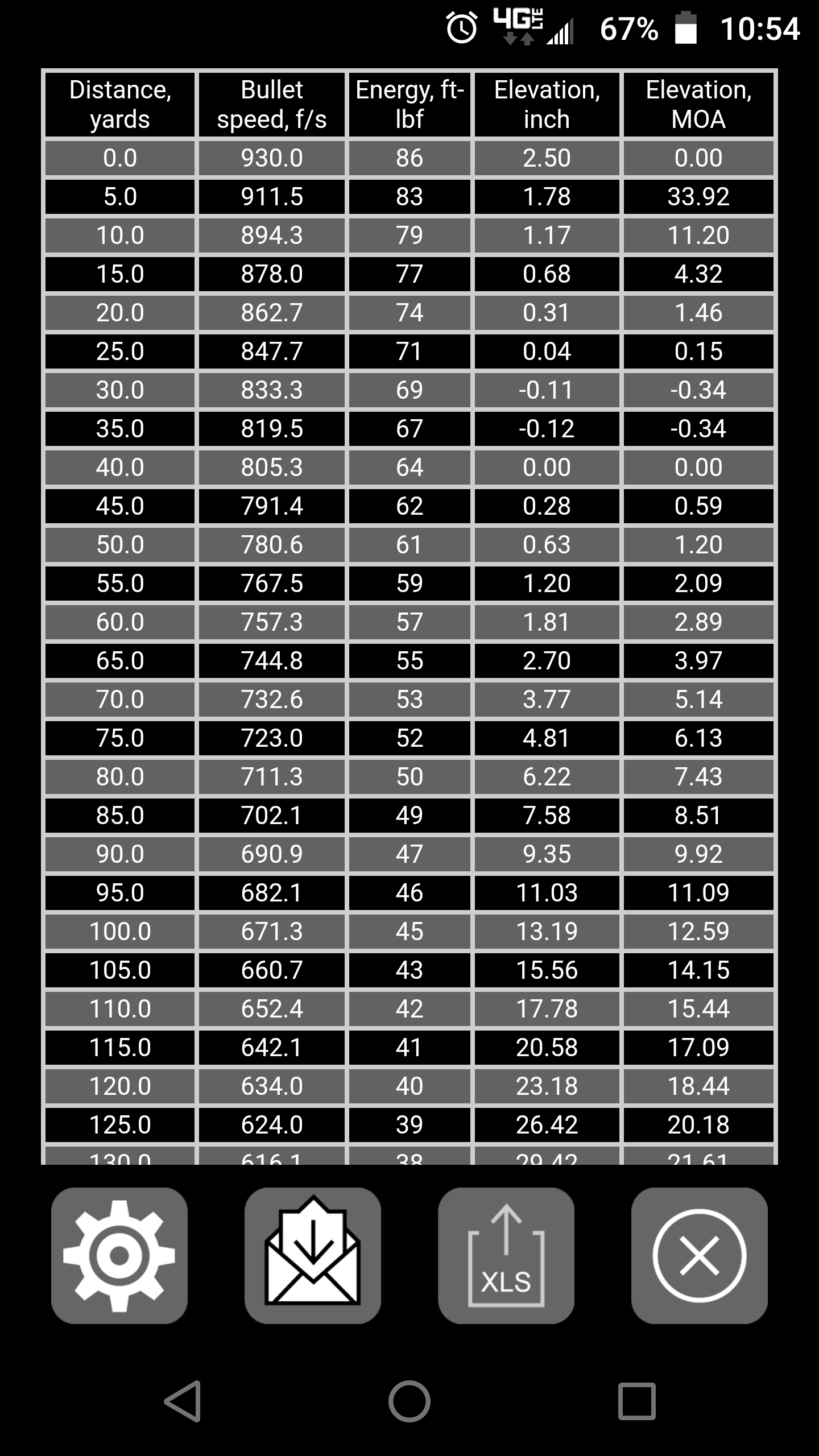

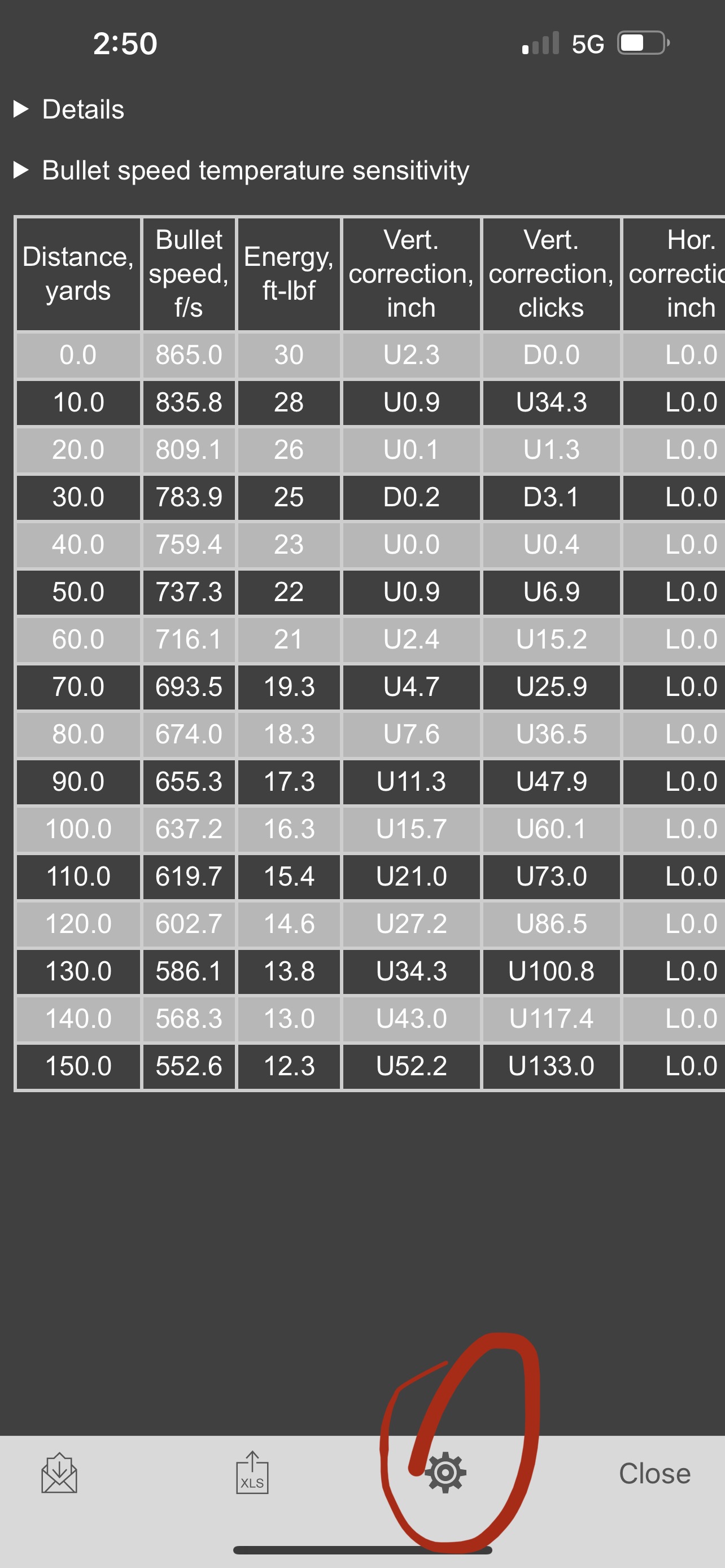

This is what I get
Once you input all of the correct information, do a calculation for the yardage per sight-in, which should come up "0", then open up the chart (as explained by others). Once the chart is open, then go to the gear at the bottom and tell it by checking the boxes what you want on the chart. Also, input the information that you want into the white boxes at the upper right.
Such as "Start Distance", input 20 yards. "End Distance", input 100 yards. "Step Distance" is the one that you want for every 5 yards....input 5.0 yards.
Open the chart and all of the boxes that you checked, plus the info in the white boxes will appear, you will have the information in a separate column for you to read on that chart. If there is so many columns that you cannot view the entire chart, then just move the chart in the direction you want with your finger by swiping it across. OR....you can make the font smaller by going back to the gear icon and entering the size of font in the first white box at the top showing "Table Font Size %".
