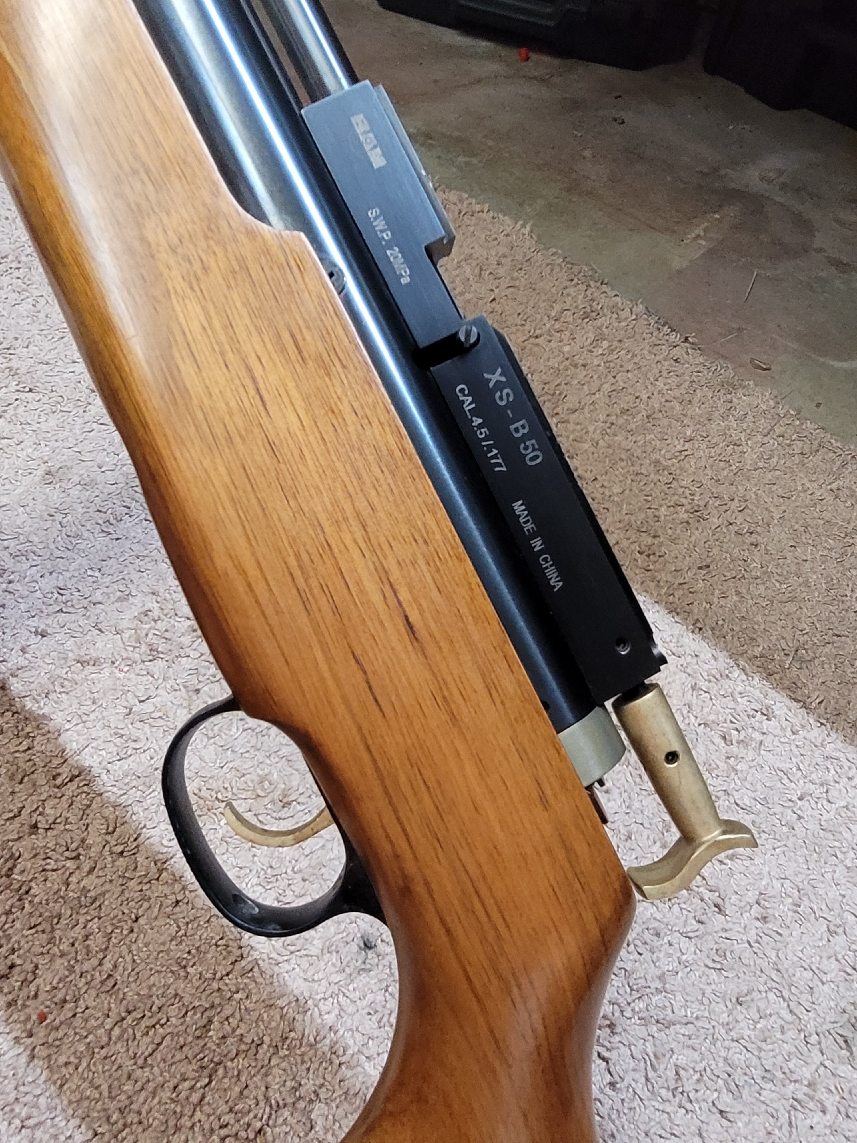

Just got a XS B50 delivered. Don't know anything about em. Tried giving it a fill from my tank and the air vented out the barrel as fast as I put it in.
Before I pull it apart I wanted to be sure there wasn't some trick to filling. I tried both cocked and uncocked.
What's going on? Pull her apart?
