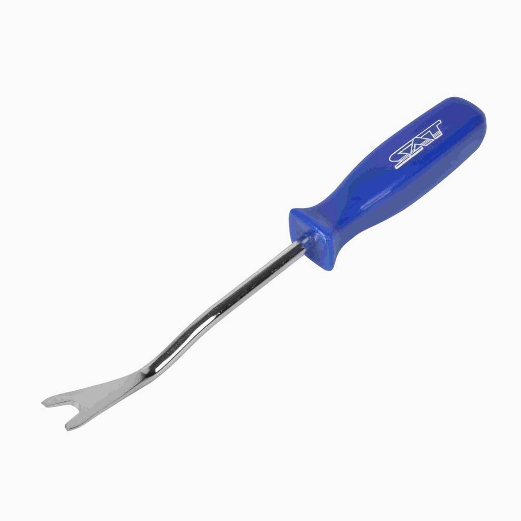

While the 2 screwdrivers work, its easier using a car interior panel removal tool like the one pictured, then you can hold the tank with one hand, then use the tool to pry out the tophat. I use one from harbor frieght.
