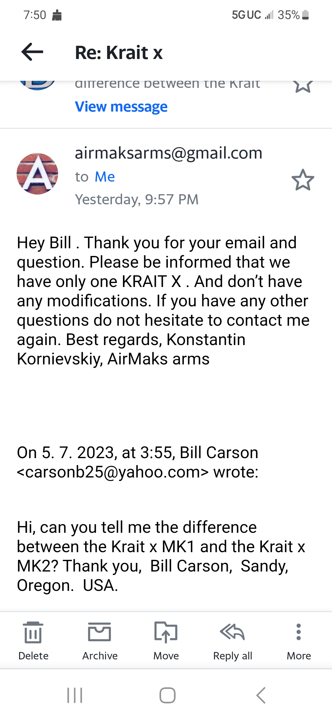

As I said the MK2 reg I have has the big pin and doesn't fit the block. Calipers are not necessary to know which reg is needed. See Humas web sight. You are correct about all blocks being the same, except for slight modifications for the 2 different regs. I am returning the MK2 reg and ordering the MK1 reg.
I have been thinking about your gun. Here is what I would lay money on. UA isn’t selling a gun with a MKl block on it. Your gun was updated with a MKll block and that’s why they sent you a MKll reg. You played with the reg adjustment or did something to cause it to bypass and follow tank pressure as you filled. You are now in the process of exchanging the right reg for the wrong reg. Refusing to measure your reg pin hole did not help with us moving forward to get your gun working. I hope I’m wrong but if I’m right, I feel like I’m about done trying to help someone who won’t listen.
