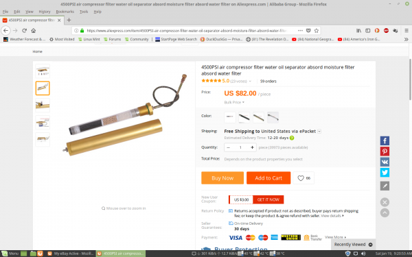

With regard to differences, there are differences in price, function and quality. I have the Diablo Air Dryer filter, which I have used for about a year and a Chinese "gold filter" made by Tuxing which I recently purchased, mostly out of curiosity and as a possible backup. The Tuxing uses replaceable cartridges. The Diablo (which may not be available anymore) does not use a cartridge, you fill it with fresh molecular sieve or dry out the used sieve when the indicator beads change color. Without a cartridge, the molecular sieve beads come in direct contact with the walls of the cylinder, which it has been said can lead to corrosion. Although I have not used it yet, the Chinese Tuxing filter quality surprised me. It appears to be very well built with double o-rings sealing the cartridge and long threads on the end-caps. Replacement cartidges with various media types are available from most filter sellers.The weak link with some of these knockoffs seems to be with the hoses and fittings but those are easily replaced if necessary. I am sure others that use the gold filters will chime in with their experience, most of which seems to be positive. The biggest difference I have seen between the Diablo and Tuxing filters is the cylinder wall thickness. The Diablo filter walls are approximately 10mm thick and the Tuxing is 8mm. The Diablo was also double the price.

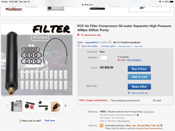

If you use a good desiccant filter like a Wilkerson X06-02-000 between the CAT and your Shoebox you don’t need an output filter. Shoeboxes fill so slowly that you are adding significant extra fill time if you use a typical full size filter like an Alpha, Diablo, or gold filter. If you insist on an output filter, then get the $28 black filter shown in this thread. It will suffice and not add nearly as much extra run time to pressurize it compared to the other filters.
The appropriate molecular sieve type is 13X. The most effective bead size is 8x12 which is smaller and packs more densely in either gold or black filters. 4X8 beads will also work but aren't as densely packed , especially in the $28 black filter housing There are many sellers in the U.S. that sell this desiccant. Ebay, Amazon, and Google all have multiple seller listings. The commercial replacement cartridges sold for compressors use 13X sieve. It filters out more types of impurities and vapor types than the smaller number desiccants such as 3A, 4A, etc.
