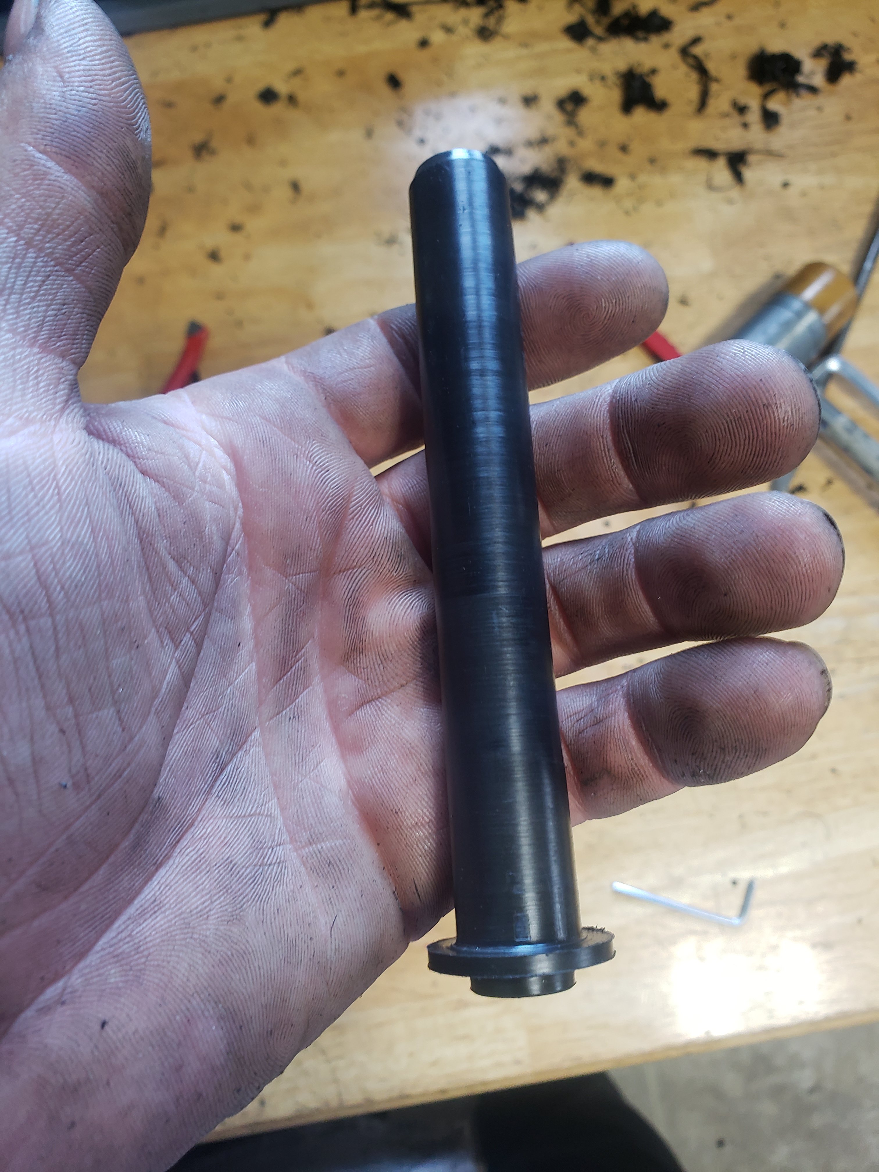

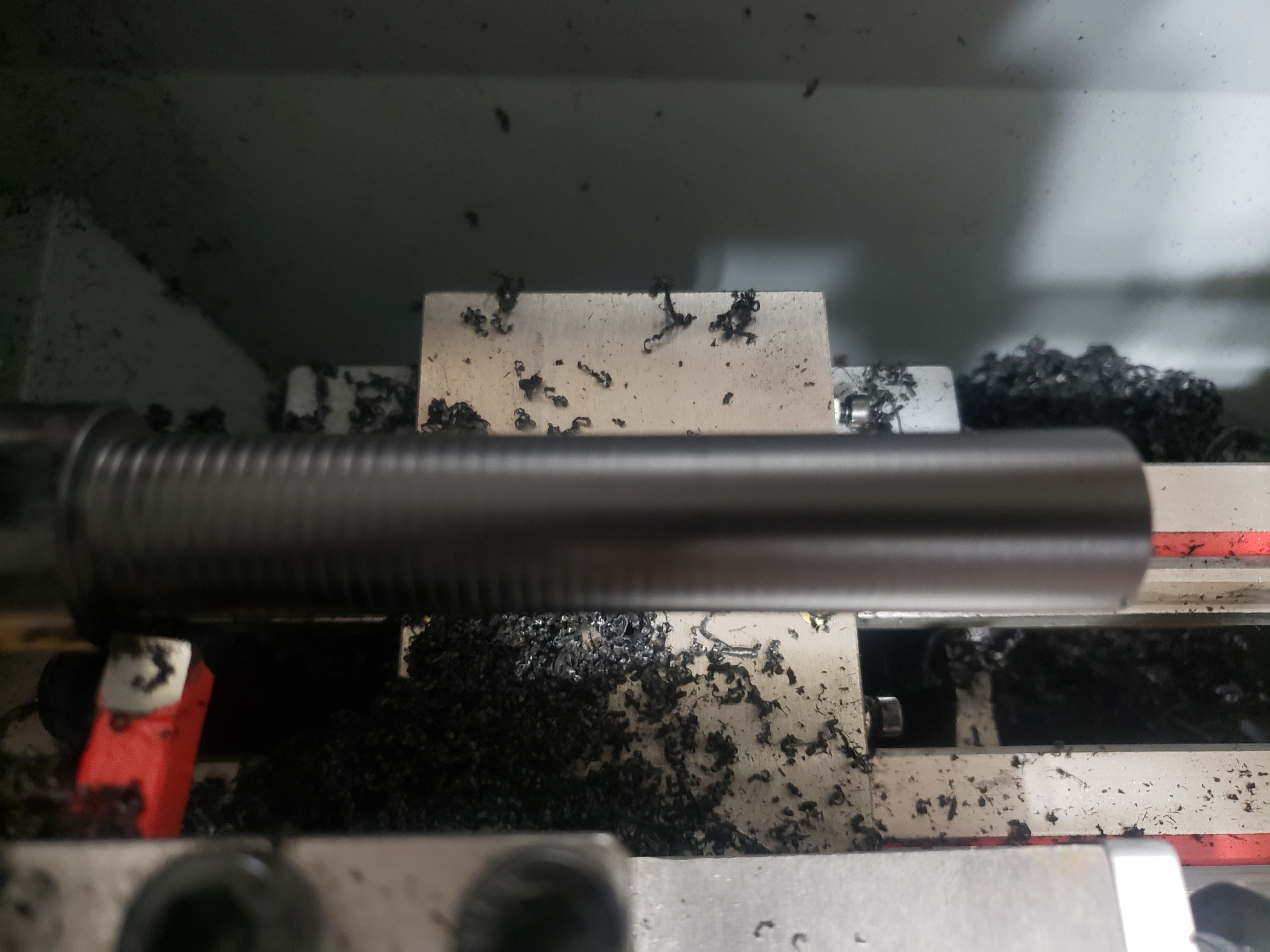

Im trying to teach myself to make my own guides but seem to have run into some issues. My cuts seem to start out well but as I get closer to the chuck I start to get "ribs" in the material. I'm a complete beginner so any advice is appreciated. Thank you!

As others have mentioned, hss and sharp. Round nose.

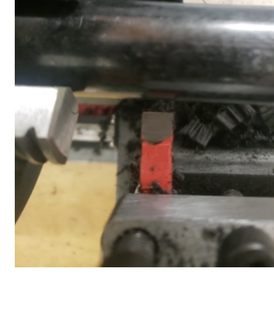

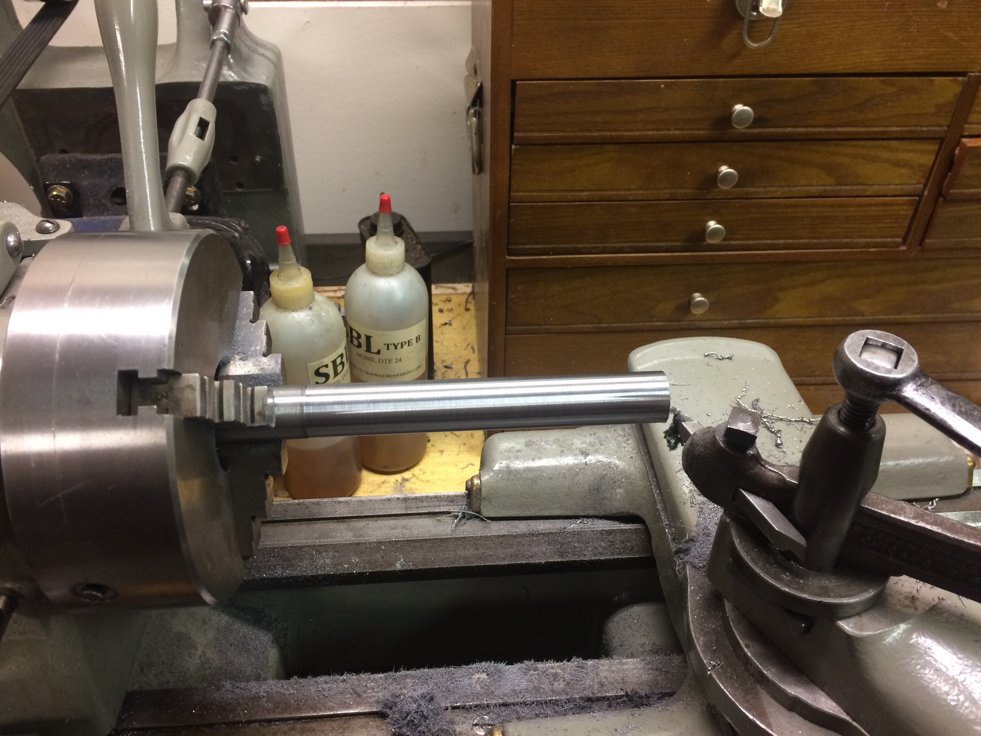

Something else I noticed in this picture
Your tool presents quite a bit of cutting edge to the part. If you’re like I was when I started, I didn’t have a bunch of bits and had to make do. Try setting that tool at a 45 angle to the workpiece, it will present a smaller ‘nose’ to the workpiece, you want just the corner of it touching.

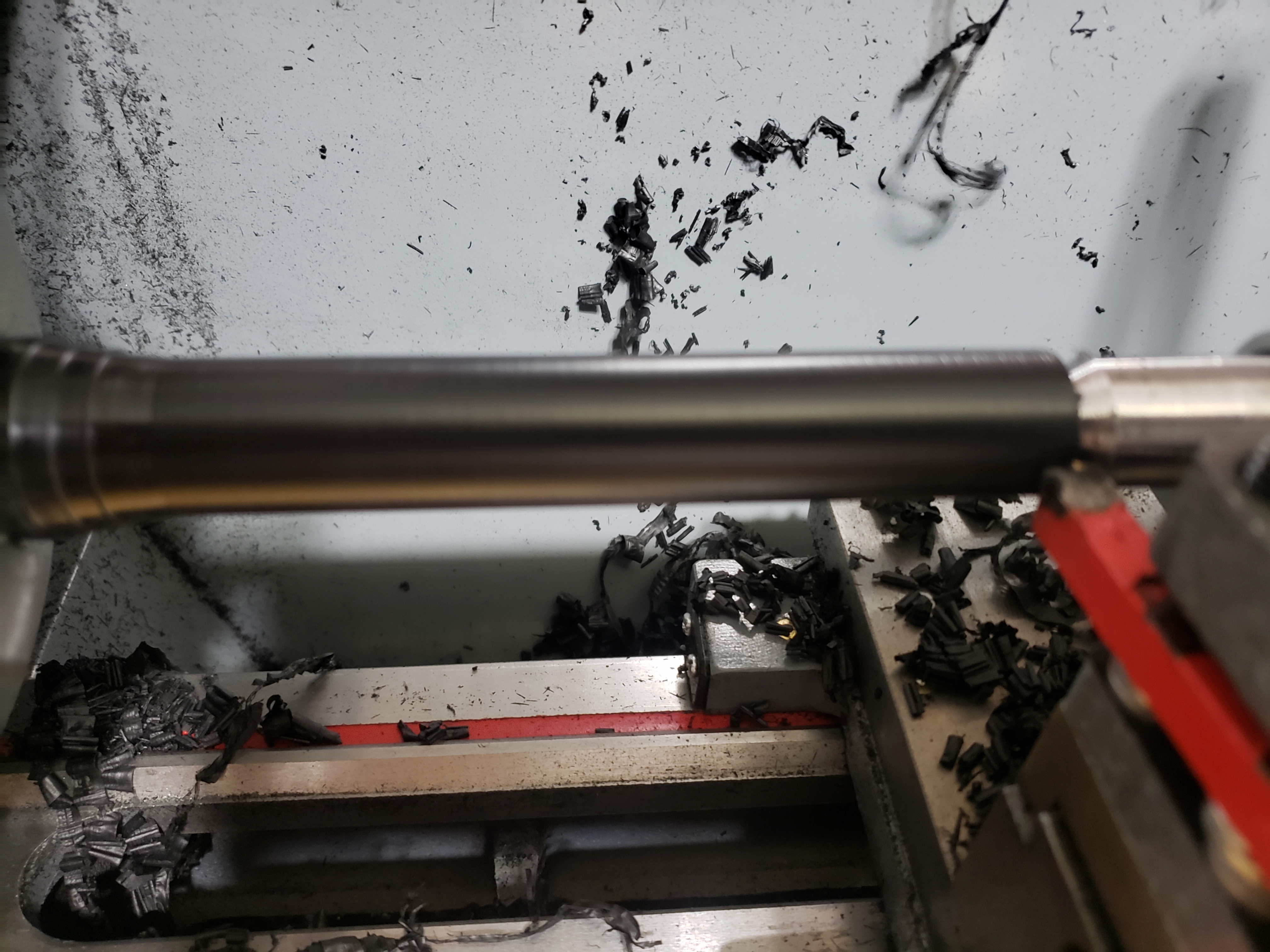

hmm .. i would guess its a screw out of round (bent) combined with some clearance play in something, maybe a few things .. in other words a scenario which may or may not be the case but as an example - if there was a warp 'bind' or trash in the lead screw and you were using it to power, it could lift and move the entire carriage on each revolution ... i rebuilt and scrutinized every part of my chinese mini lathe and found many small issues to iron out, that combined could lead to larger problems for sure ... spent almost a month of spare time on the rebuild .. an out of the box precision machine a cheap lathe is not, but they can be with alot of attention ..

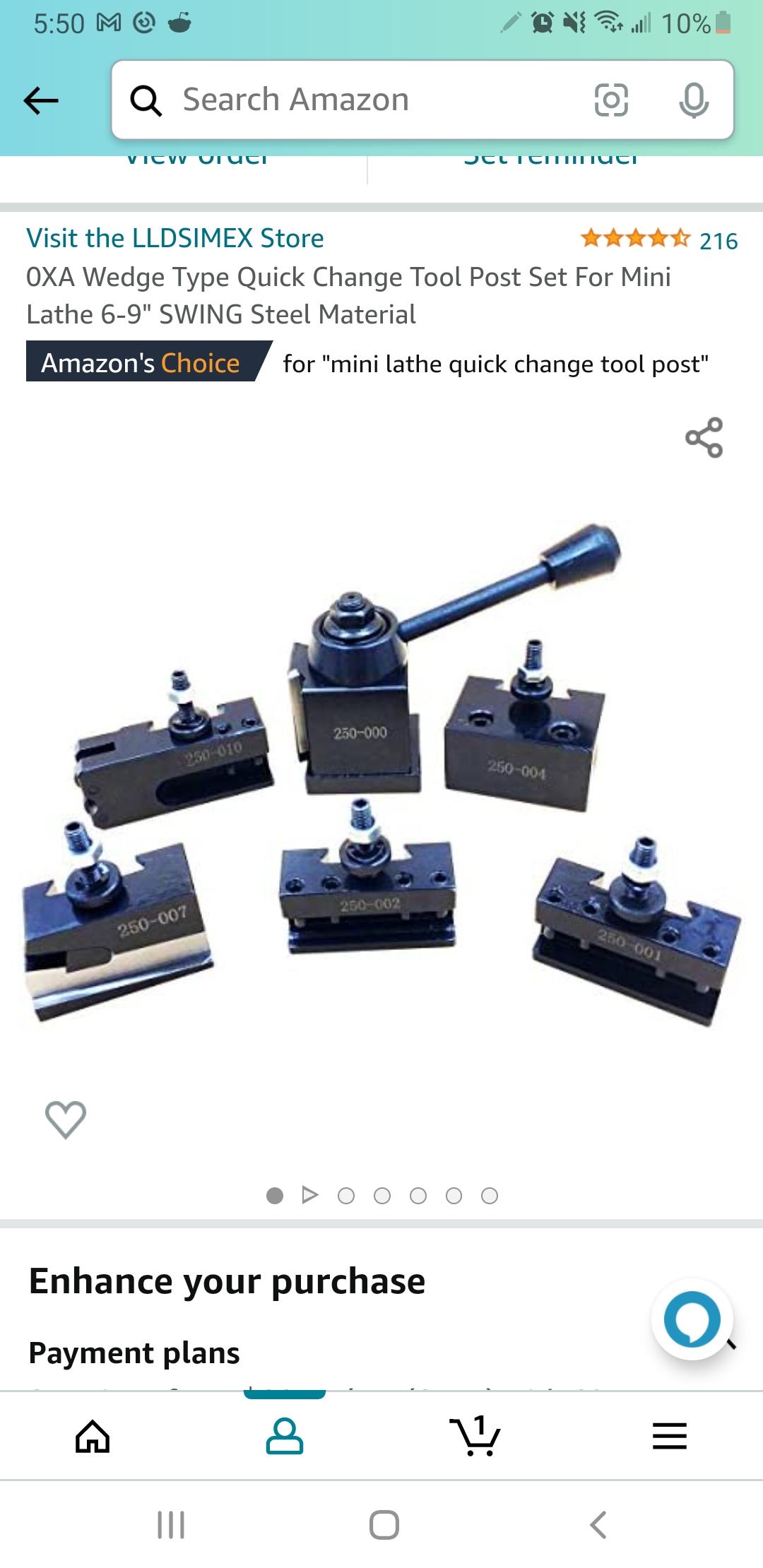

I'll be ordering some new tools, a quick change tool post, and a live center tomorrow. Excited to really get into this. My first guide is done (not great but its done!) and I'm looking forward to trying again and doing a bit better
Be sure to get tooling that fits your machine. If you need help just post the machine info for suggestions.

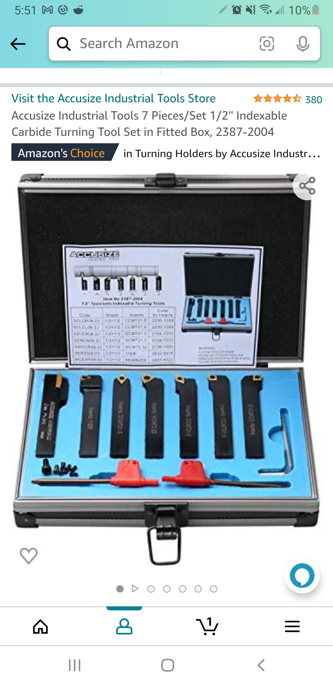

Throw that brazed on carbide bit in the trash. That's your problem. It might be useful for making butter sculpture. Total useless junk.
Its getting better lol but yeah I wasn't expecting this $14 Harbor Freight set to be great and as it turns out, it isn't. If someone would like to share a link of some decent tooling I would appreciate it. There are too many options and I dont want to buy something else that doesn't work well

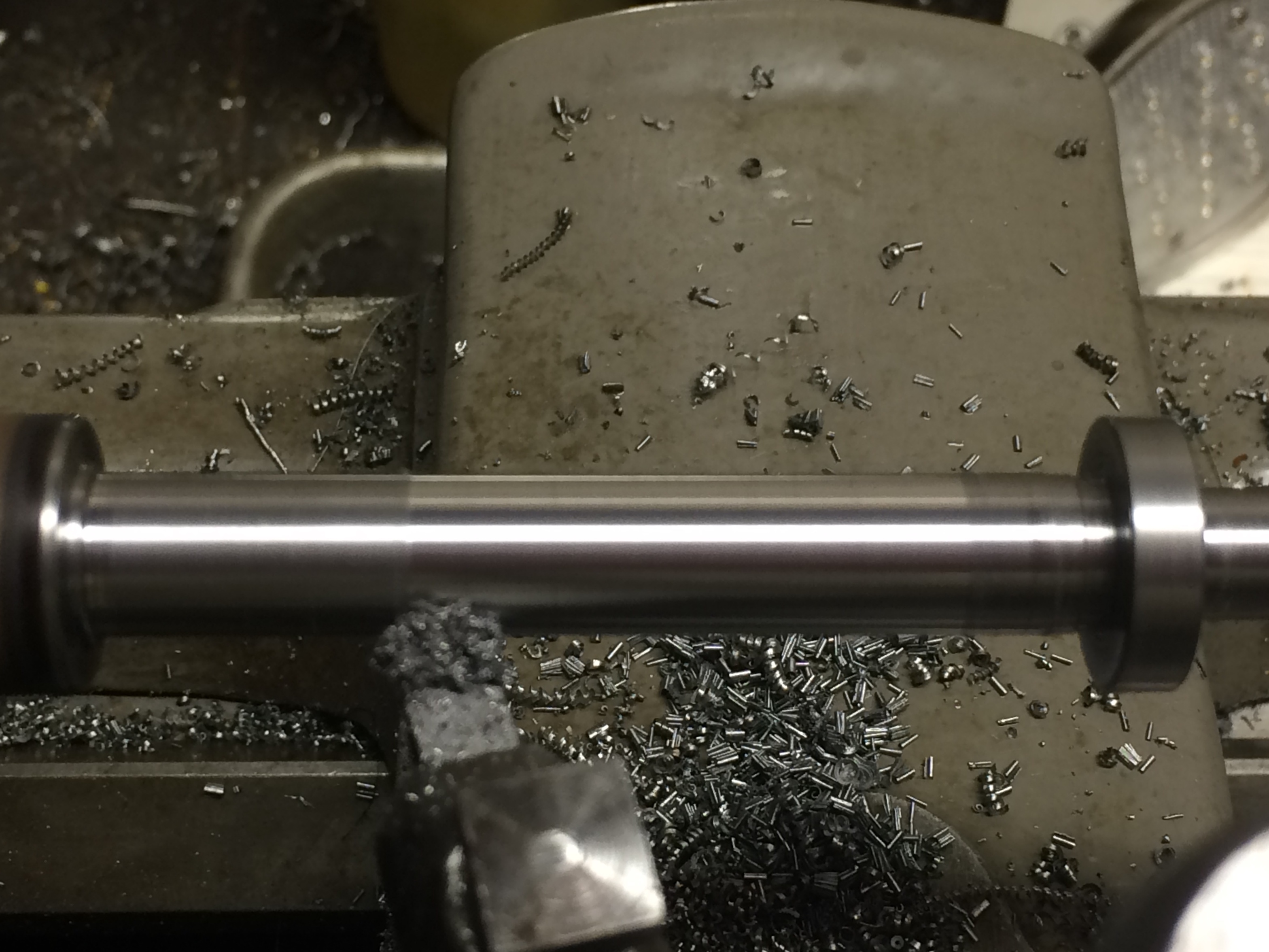

Im trying to teach myself to make my own guides but seem to have run into some issues. My cuts seem to start out well but as I get closer to the chuck I start to get "ribs" in the material. I'm a complete beginner so any advice is appreciated. Thank you!View attachment 291346
Has to be increased vibration as you approach the Headstock. Make sure the live center in the Tailstock is locked down and applying enough pressure to the stock as it's chucked. Is there looseness/shakiness in the headstock as you apply pressure?
Also, you may need to tune/tighten the screws to the gibbs on the tool post or where the Carriage meets the lathe bed.
When I bought my Harbor Freight 7" x 14" Lathe, I spent a week just tuning/adjusting/fixing it ...

The Key is to listen and watch how the finish is on the part you are turning...
Chattering and squealing..means your tools is vibrating.... Poor Finish!!
Adjust your speed and feed .

Also check your tool height...

It is hard to tell from your photos but your tool looks like it is sticking out a bit too far from the post. Also have you tried to feed from the Chuck toward the Center? If you have a Carbide tool try using it.

I'd use a radius tool instead of sharp with more shear angle. It'd make for a smoother cut.

That's a bit overkill, The inserts have a nice enough corner radius on them, trying to dredge up my memory on them, been a few decades. I want to say about .016 to .032
