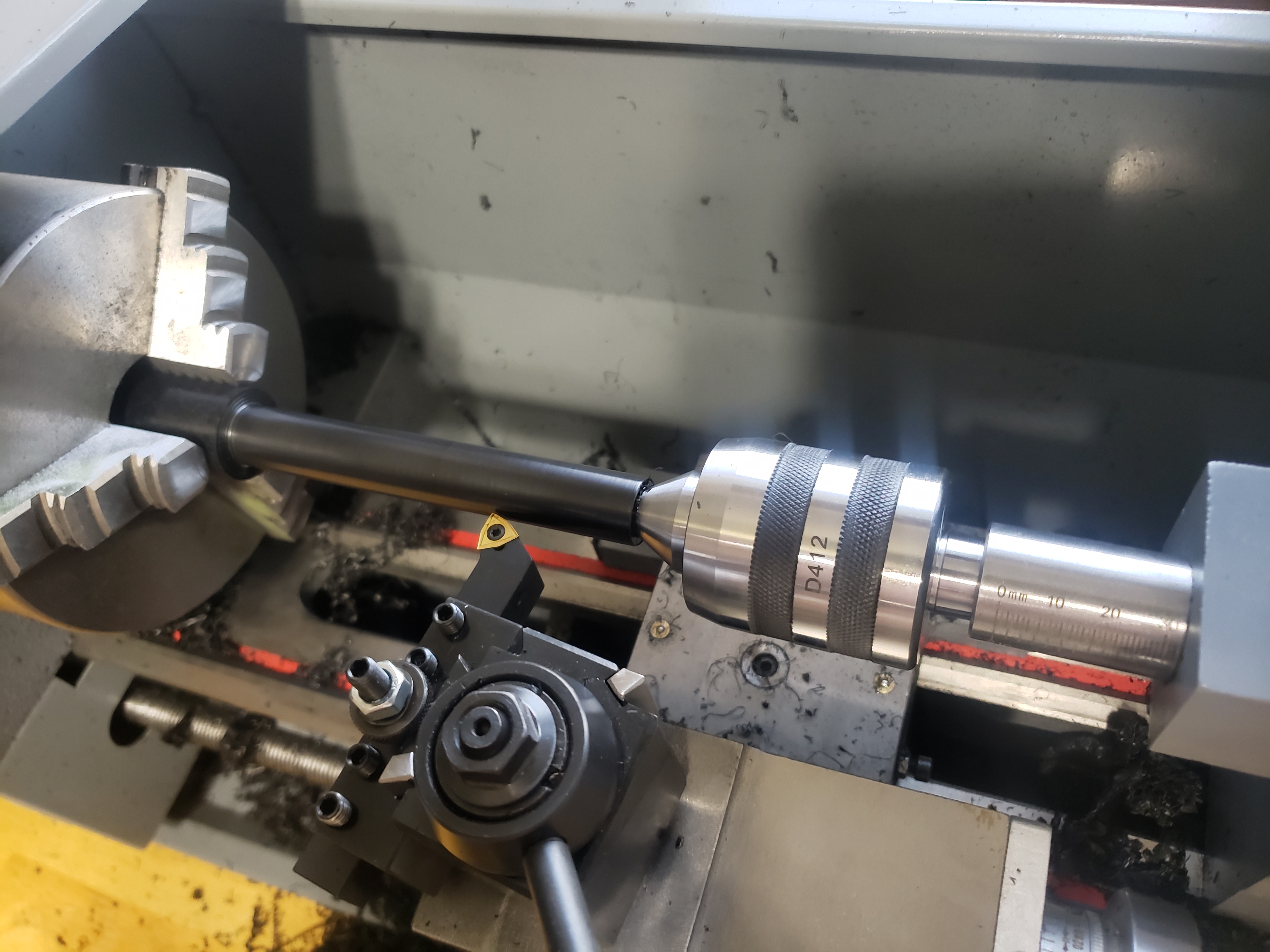

Im trying to teach myself to make my own guides but seem to have run into some issues. My cuts seem to start out well but as I get closer to the chuck I start to get "ribs" in the material. I'm a complete beginner so any advice is appreciated. Thank you!
Those marks seem to be the same pitch as the lead screw, there is some sort of vibration being transferred from gearbox through the lead screw then to the saddle to the tool, check the gibs for play.
