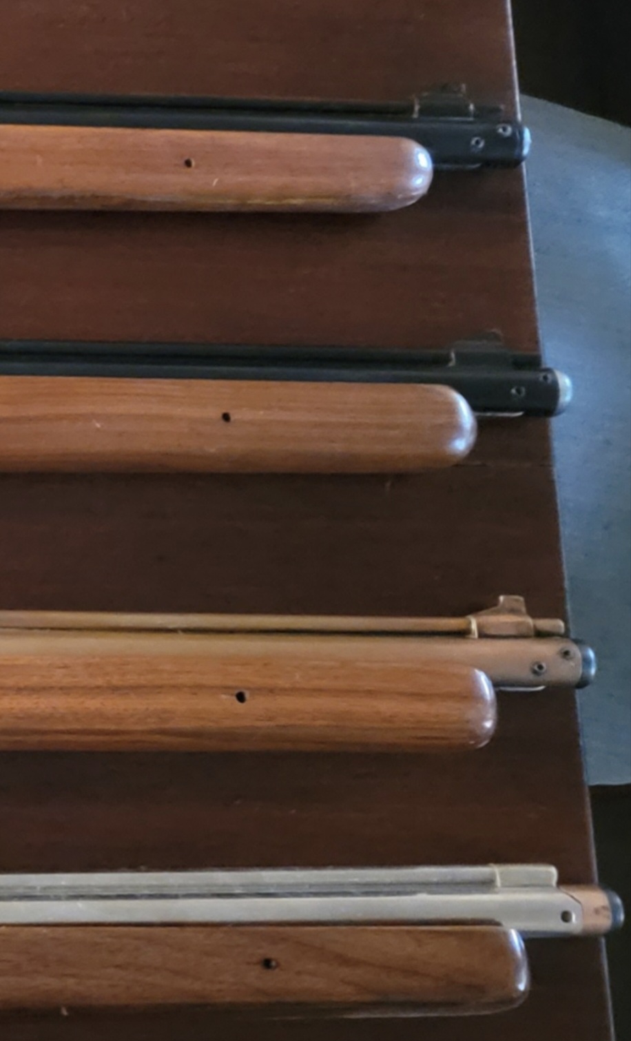

My apologies. I assumed the gun on the left was a silver streak.

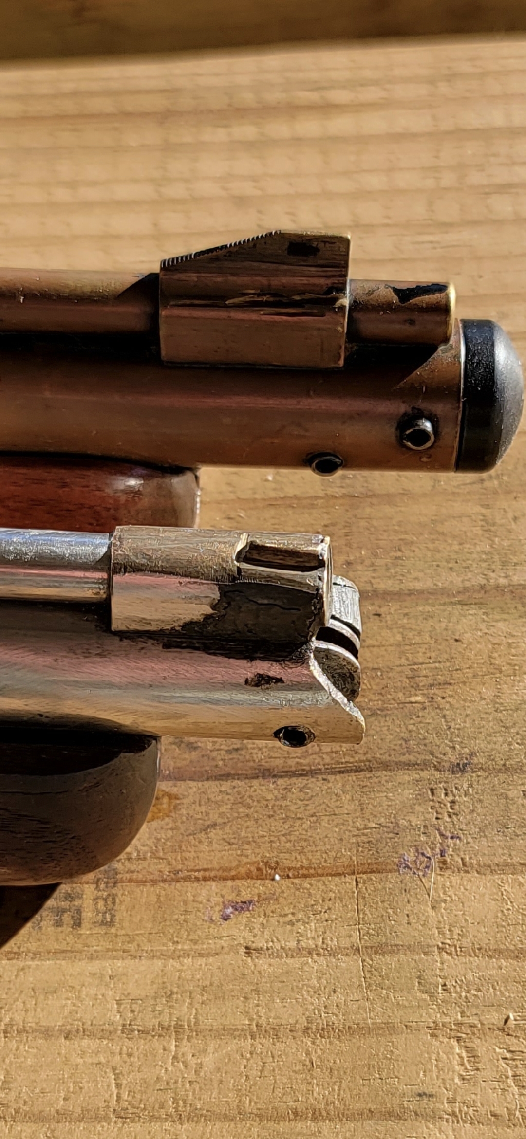

By chance did you replace the barrel? I ask because the guns front sight appears to be a partridge (as apposed to the bs on the right which is a serrated ramp style. The partridge front sight ended early in '64.
I so appreciate it when people are sharp and have a good 👁!

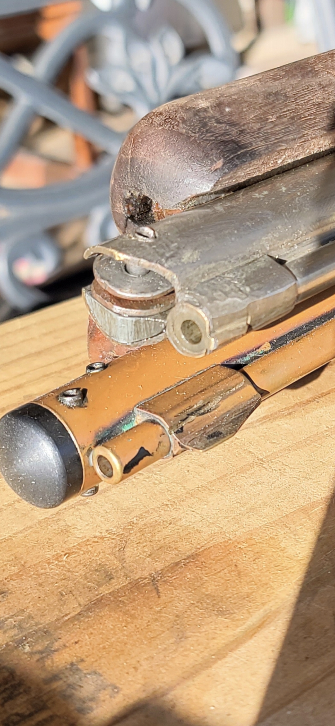

It is the original barrel but in my younger years I ruined the original cutting it for a hood etc etc.
Here are the before pics.

Ouch!
What is cool about this gun is it's the last of the receiver stamped date codes. Perhaps literally.
Serial numbered C's began in April of this same year.
I had it done by Tim @ Mac1, I asked him myself, he answered you get hot, when it let's go you tap it with a hammer, and it flies off. Slide your new one on and solder it.
