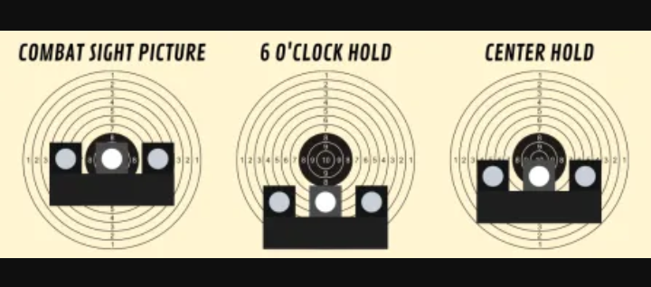

Hard to say.. front sight too low make a gun shoot high. If your rear is all the way down and you use a full post in the notch. ( Top of front even / level with top edge of rear blade) it would seem mad be some droop . A breech seal from a old wrll ised to new will change the poi some till it compresses or settles in locked up.. now at 10 m how high? If you use the 6 oclock hold that aimpoimt going to be the bottom of the black rings and that's what? 1-1/2, 1-1/4 .
Center illustration in picture

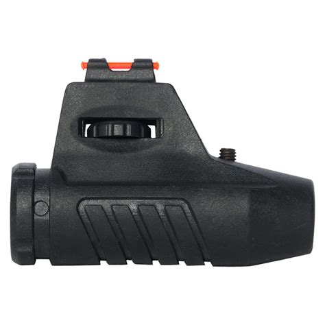

Ill tell ya that elravation adjustable front sight like hatsan and kral put on a gew of thete guns is sweet.. today good luck finding one to add on . Hatsan may sell you one as a part ,but .... Anyway it is nice at 10m or less on the pistol and the rear is bottomed ..
Heres a picture of a kral adj front .. i think it can fit like a 13-14mm barrel slip on
