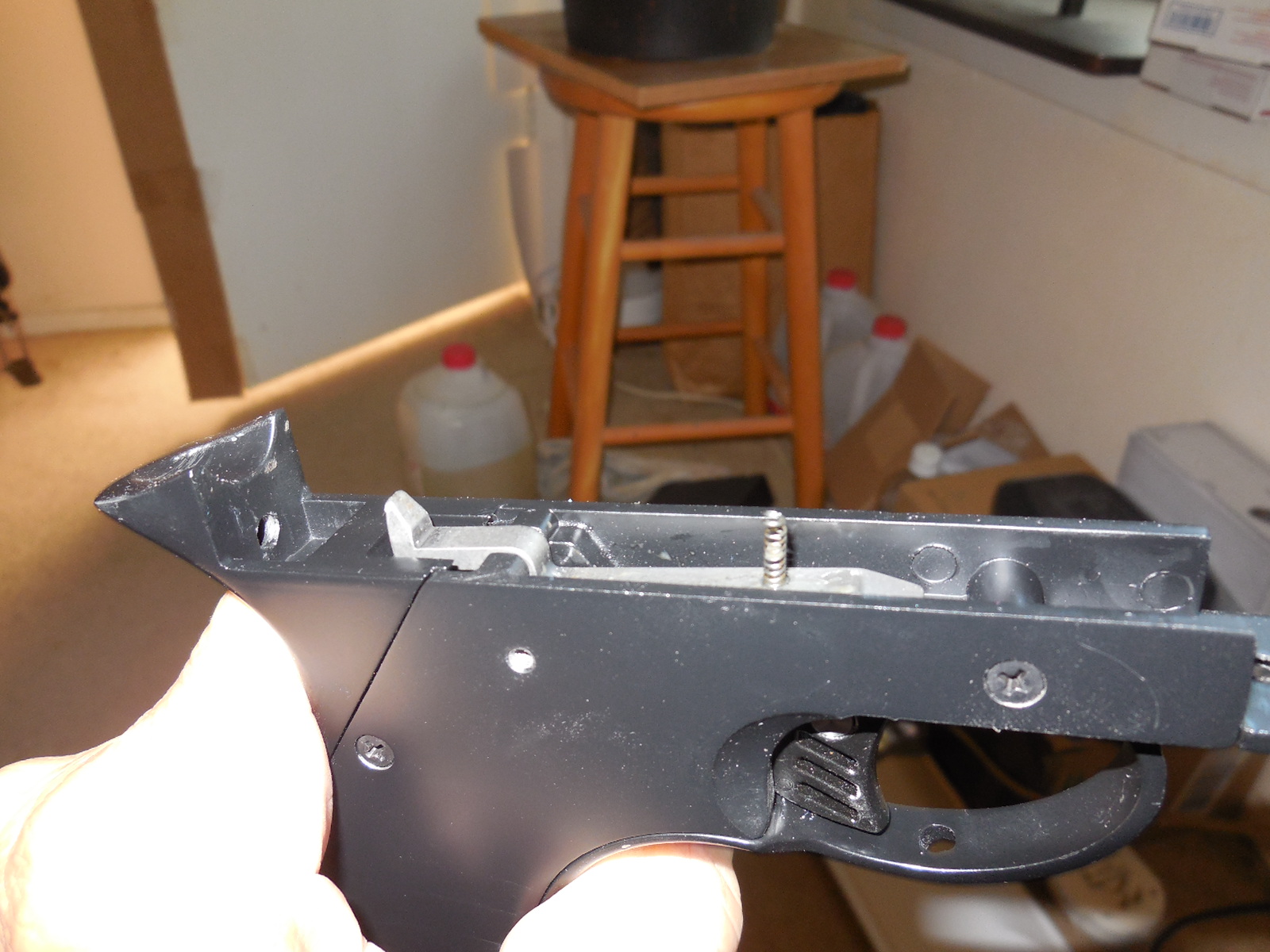

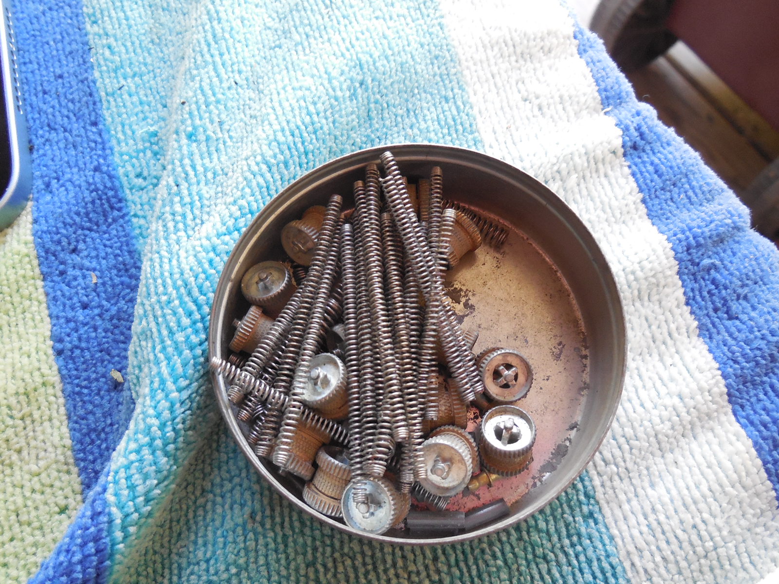

I replace my spring with a bic lighter flint spring cut the same length of the stock spring. I fill the cavity it sets in with silicone grease to hold it straight. makes for a much lighter adjustable trigger for me.
I’ve heard pen springs work too. Not sure if there’s truth to that. Last night I adjusted the crap out of it to the point of not cocking, rounded the head of the adjustment screw, lubed it, and STILL over 2lb pull, and different every time.

Haven't done my trigger yet and it is bad! Understand you smooth the ball end of the adjustment screw. Are you just rotating it on a piece of 400-600 grit till it is smooth? Or is there more to the story?
Most people just smooth out the ball end.
I also rubbed molly paste at all points where the parts (trigger, sear, screw, etc) touch each other.
I think there are some screws with a ball bearing at the end.
