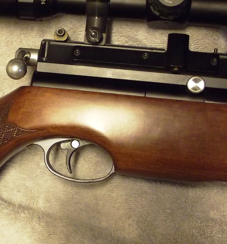

I've been considering trying to set my .22 S410 up for FT as well. Does yours have a power adjuster? With the power wheel on minimum mine is doing 450ish fps with 15.89 JSBs. It would seem I should be able to get it just under 20 FPE at the peak if I get the power wheel set correctly. I haven't tried to set it up yet, just turned the adjuster to see if it was possible. The power adjuster is the silver knob just in front of the magazine.
